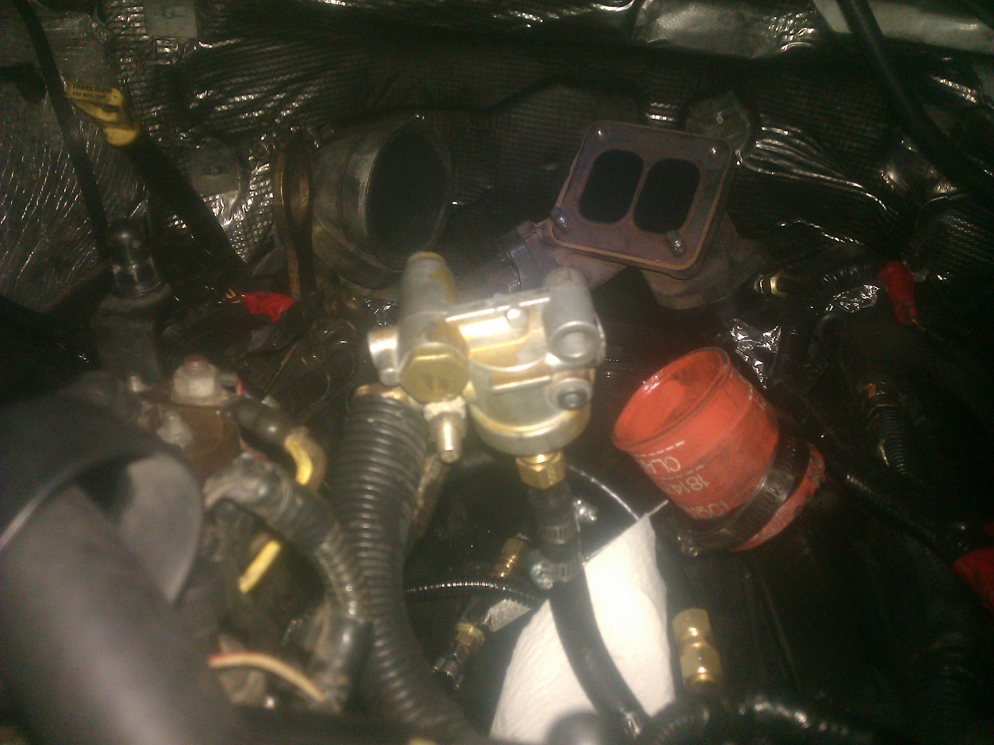

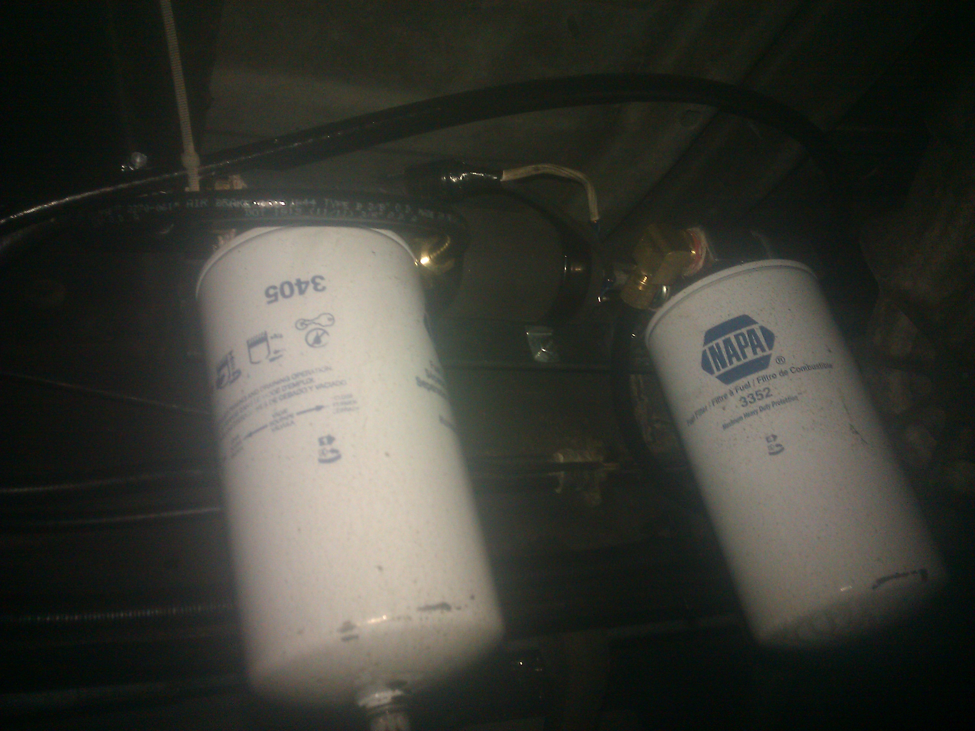

So January i bought a 01 Hpop from flea bay and a oring, gasket and plug kit from www.dieselorings.com
Then February a fuel pump from Jake @ irate.

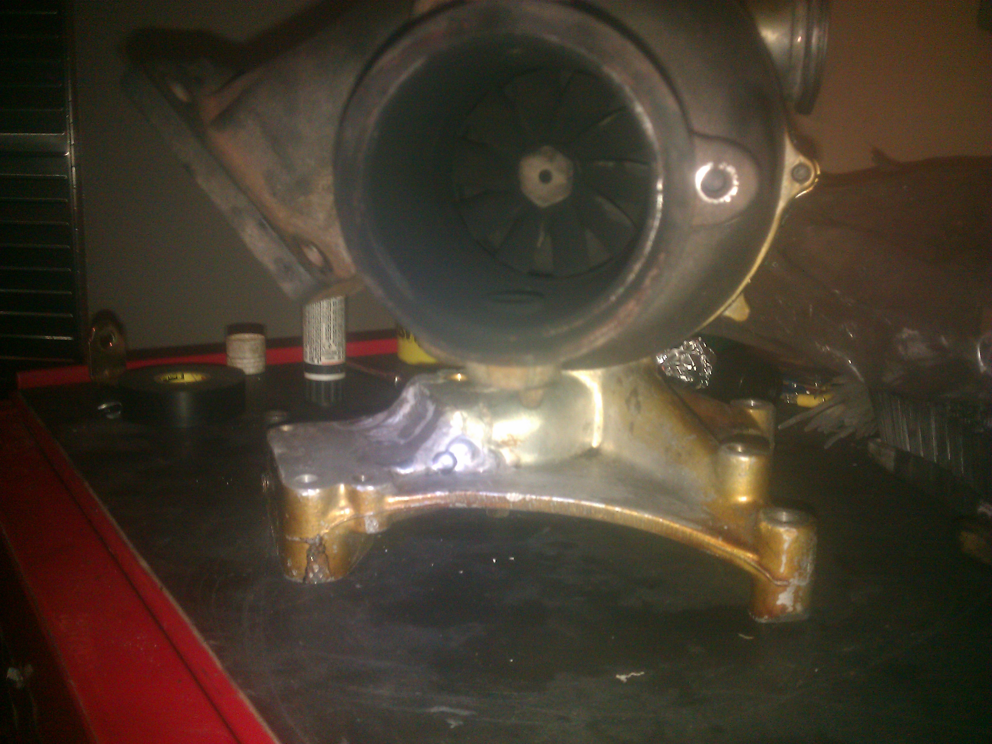

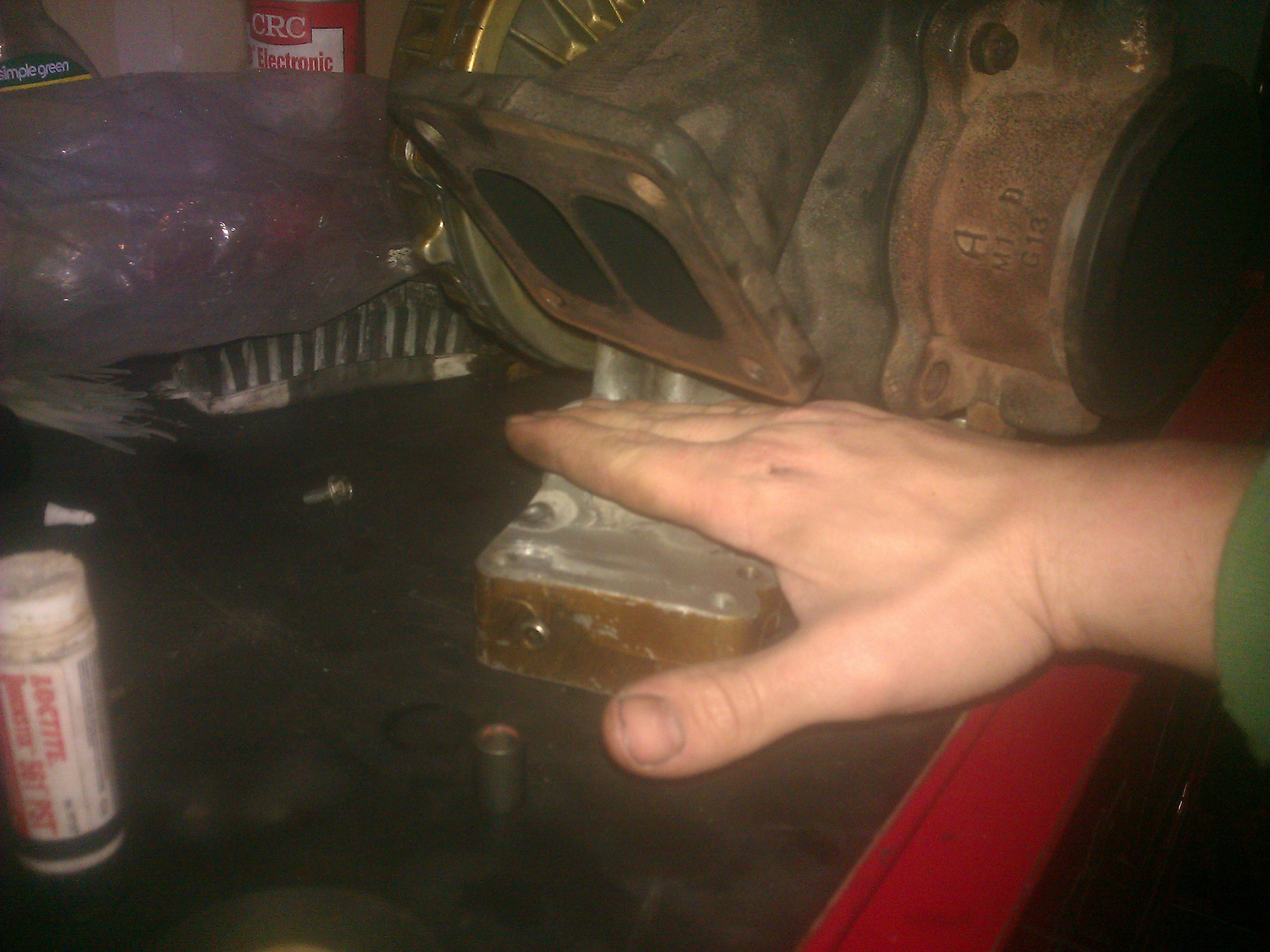

And had a rebuild kit for my turbo so did that and a epbv delete.
my take on the tightwad mod. And Im at 80 psi fuel so i m sure that pellet in there is a bit much.
and filters from fleetfilter.com
But from the whole 10 miles ive drove it WOW. I have way more mid range and boost is rock soild and shifts at 25 might be time to consider going back to the 1.15 and see what i pick up top end. But its a beast on the bottom and mid!
And i did however first attempted the jb weld of the extras on the fpr and the epbv. Needless to say i lost some fuel and oil. LOL now i welded em.
And I grinded my welds and kept sanding holes in so i welded up and left it not as pretty as i wanted but its good for my scattered brain ocd i guess.
Pics.

I had that air hose on my truck on the fuel system. Was told to remove not rated for fuel . Should use fuel hose.
MossBack
Aug 22, 2011
934
UTAH
That is diesel rated 3/8 synflex. At my work we plumb carrier refrigerator units with it. I can post the info from Eaton.com bit I have read that too.
If the manufacturer recommended using it I feel I'm OK. I'll post link from lap top in a few.

3270 Eclipse Airbrake Tubing
Construction: A multilayer product with a unique
flexible design.
Sizes: -06, -07, -08, -10
Product • Resists chemical attacks from
Features: diesel environments
• Exceptional abrasion resistance
• More flexible design
• Wide temperature range
-45° F to 250° F
• Thermoformable

neverkickn
2,692
AR
A rating for "use in a diesel environment" and "rated for diesel transfer" are two different things. I would make sure it is rated for use as a fuel line before you get too comfy with it. JMO!
flexible design.
Product • Resists chemical attacks from diesel environments.
Features:
-45° F to 250° F
• Thermoformable
I am comfortable with it as I previously stated I work for a semi trailer manufacturing company. We send thousands of Carrier refrigerated units on the road every year that are plumbed with this very same tubing. Hence the reason I used it.
Thanks for your concern but I'm not to worried.:eek:
