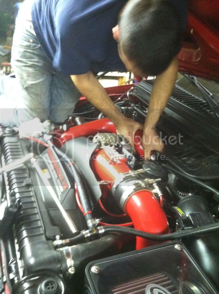

since i got the new s366 from Dozers diesel, the smaller housing is causing some turbo surge when i let off the petal. Nothing a Blow of Valve cant fix... Here is a little write up of the install. Figured i can get this done while waiting for a few items left on the interior
well got around to getting to work done on the Blow off Valve last night...here some pictures
Mocking up the mount for the BOV

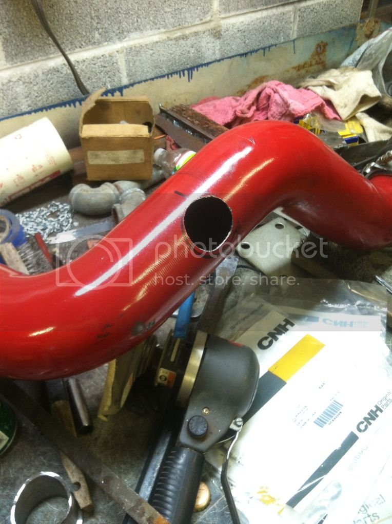

drilling the 1 7/8" hole

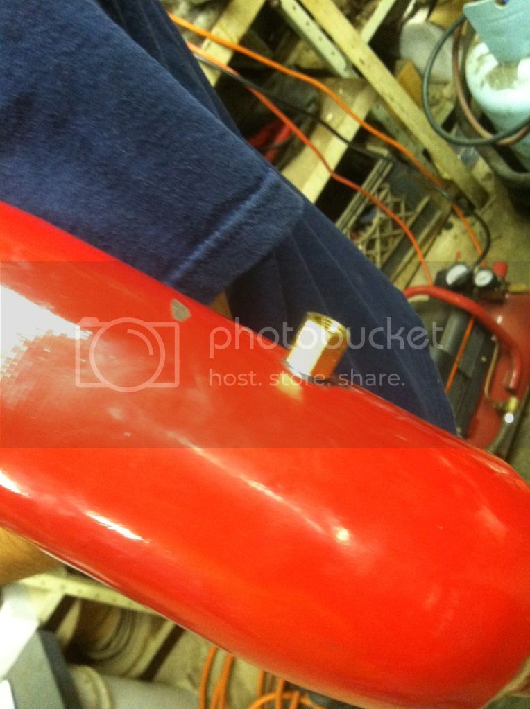

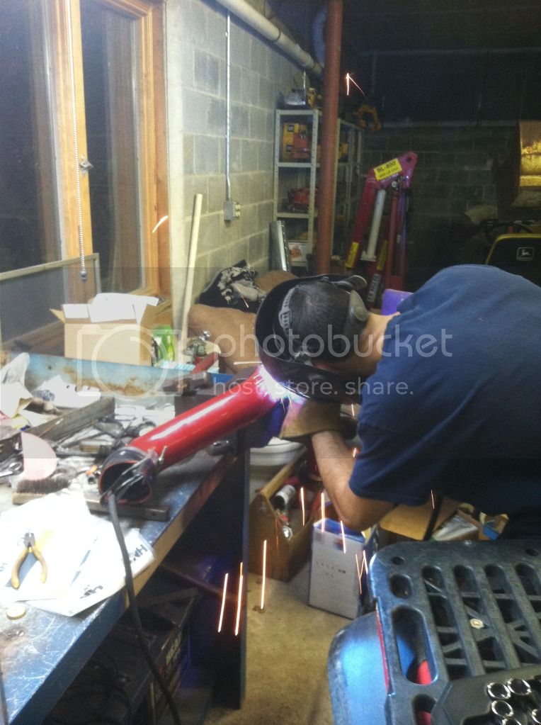

time to weld the mount on
not bad for a Mig...
here it is all mounted up
just have some wires to connect and should be set to go

Am I the only one that noticed that weld didn't have any penetration for much of it? It'll probably hold for this but that wasn't a good weld IMO. Other than that it is a great job.

very consistent though, something you don't see much
im not a welder by any means, which is why he welded this for me, but i know he was concerned about burning through the pipe, so he was leary of going to hot with the weld....this should be just fine for this application.

Theres plenty of penetration there. Looks just like all of my bov bungs. You forgot to paint it though lol
