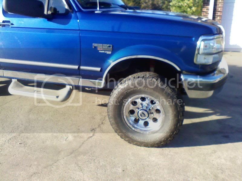

This is 285/75/16 on 8" wheels

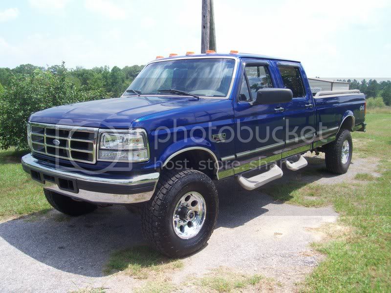

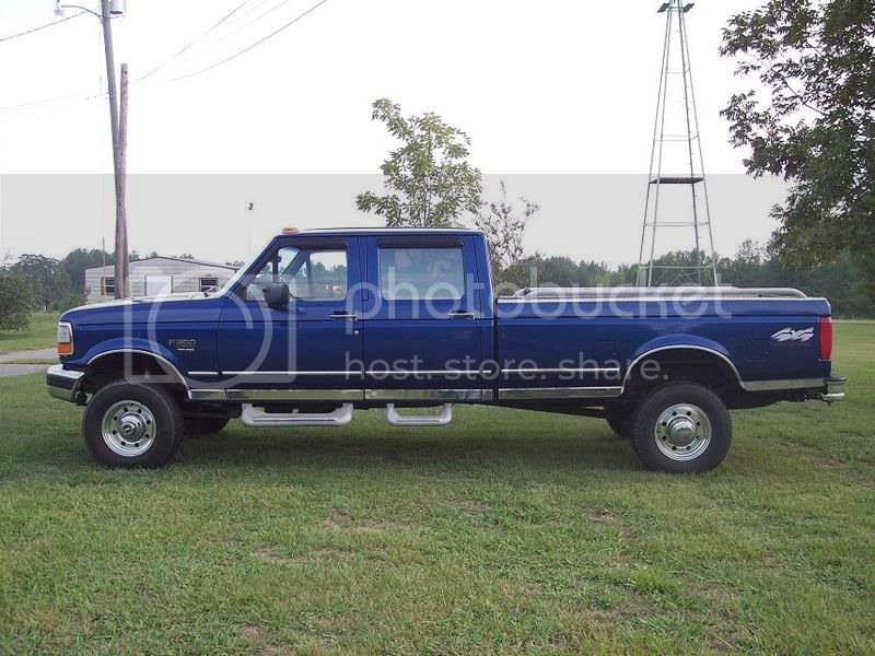

Here's my 97' F350 with 305-70-16 E 10ply bridge stone duellers on stock alcola rims...they fit fine and I have a cord of black oak in the bed...no rubbing and ride's great....:D

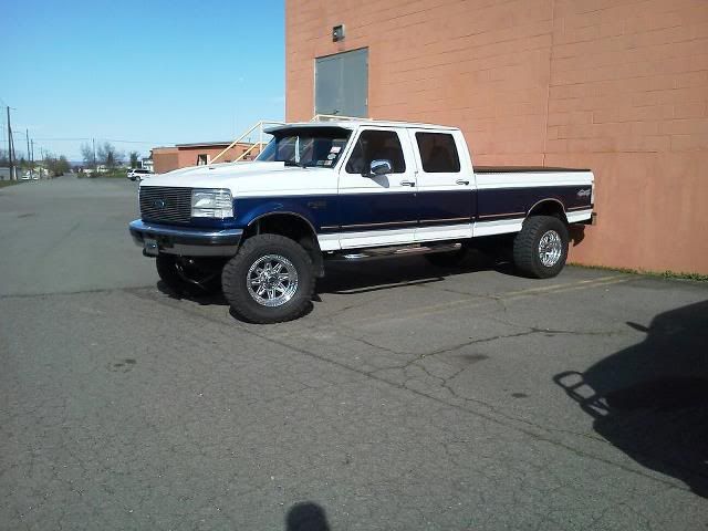

315/75/16 with a front end look that should be quite comparable
just put them on mine.

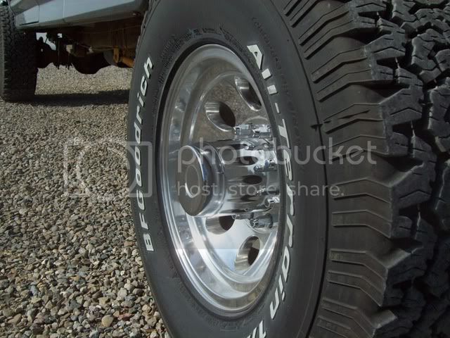

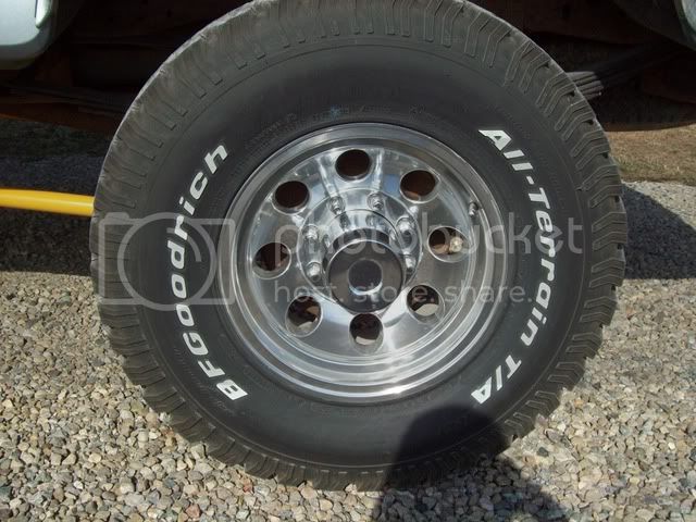

16x8 Mickey Thompson Classic II's with a -12mm offset. 33x12.50 BFG A/T and a 2.5 inch Tuff Country suspension lift.
1997 Ford F 250
built automatic with 4.10's
Diamond Eye down pipe, straight piped
Baby Swamps injectors
TS 6 position chip with custom tunes
K&N cold air intake
3 gauge pillar pod (trans, pyro, boost)
16x8 Mickry thompson Classic II's
33x12.50's

I would think some 285's would suit your truck just fine Tom, especially if you're keeping the stock wheels.
