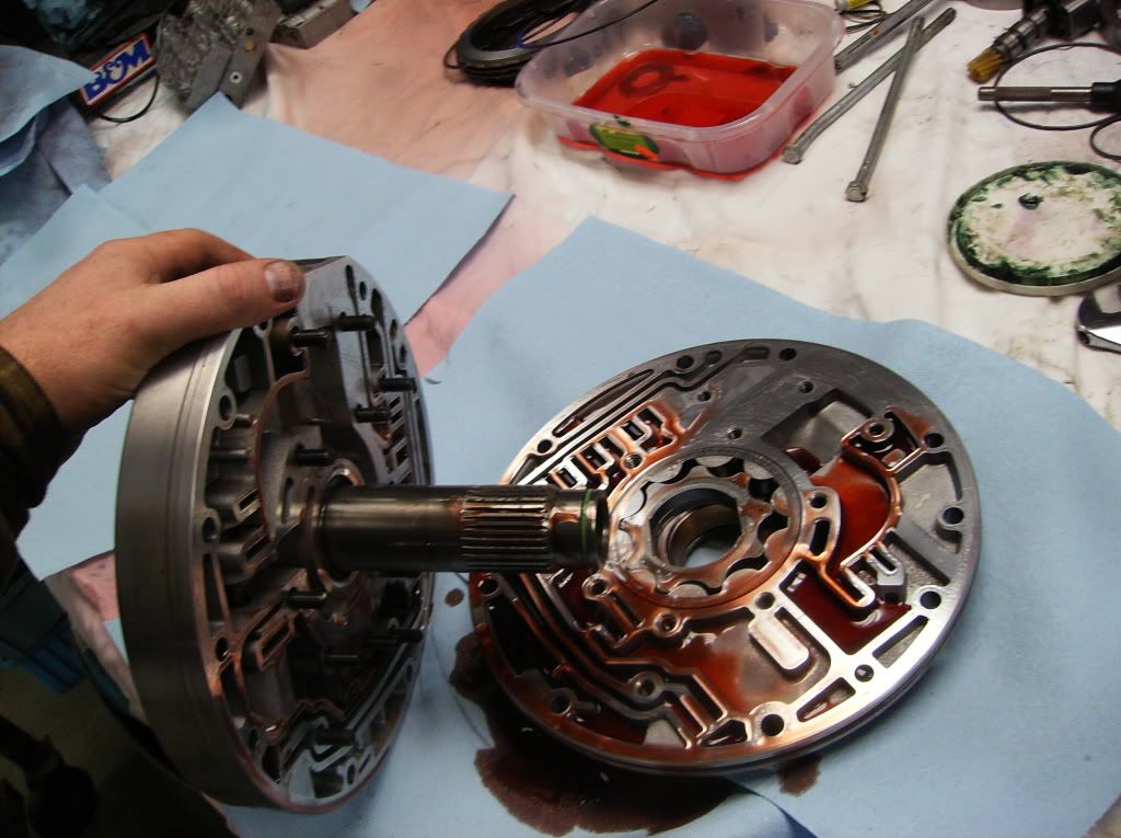

4R100 Disassembly Pictorial
This contains a step by step picture guide for the complete disassembly of the 4r100 transmission. There will be very little text other than what is in the pictures. Will be adding in text procedures to accompany the pictures at a later date.
Pictures are courtesy of TwistWrench
4R100 Disassembly
Part 1 of 3
Images: 1-40​

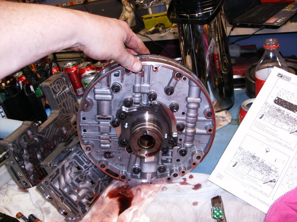

4R100 Disassembly
Part 2 of 3
Images: 41-80​

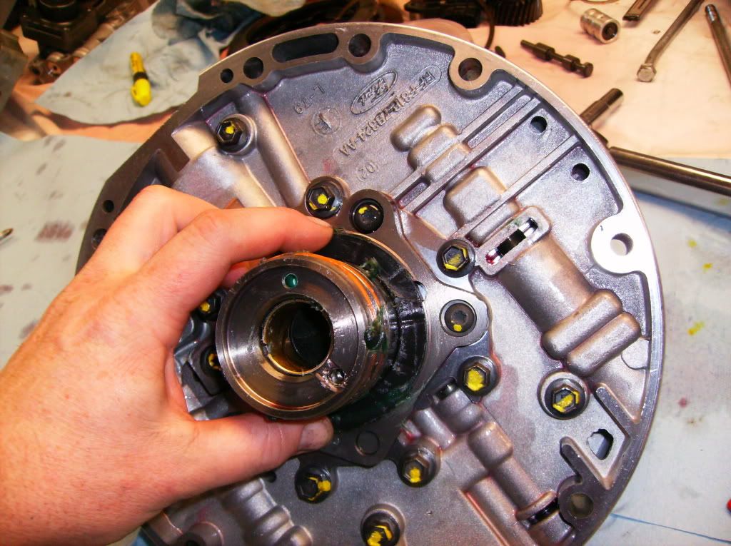

4R100 Disassembly
Part 3 of 3
Images: 81-120

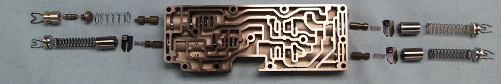

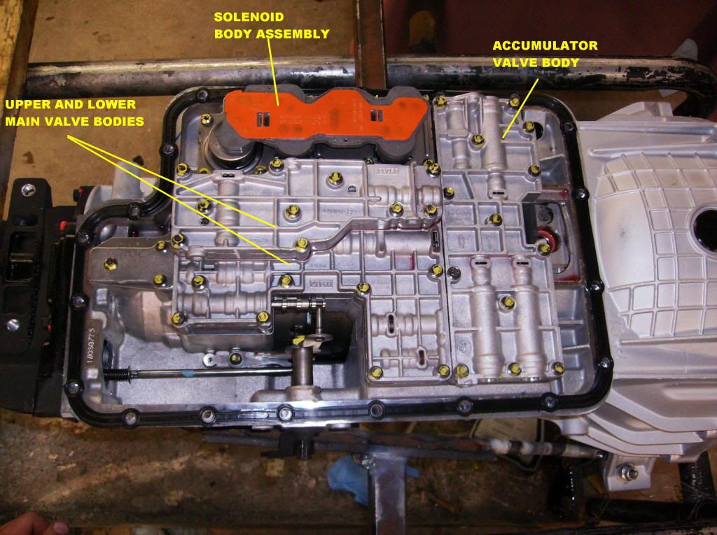

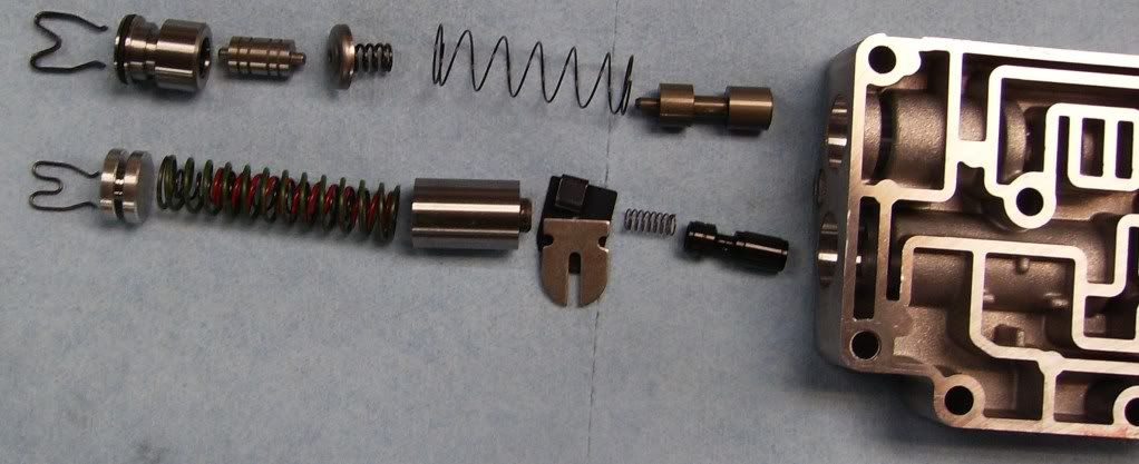

Valve Body Exploded View & Parts List​
Images: 1-7
Valve Body Exploded View: 1​
Valve Body Exploded View: 2​
Valve Body Exploded View: 3​
Valve Body Exploded View: 4​
Valve Body Exploded View: 5​
Valve Body Exploded View: 6​
Valve Body Exploded View: 7​
FORD 4R100
MAIN, LOWER, AND ACCUMULATOR VALVE BODY LEGEND
Item Description Item Description
1 LOWER VALVE BODY CASTING
2 HEX HEAD BOLT, (2 REQUIRED)
3 RETAINING PLATE
4 MANUAL 1-2 TRANSITION VALVE SPRING
5 MANUAL 1-2 TRANSITION VALVE
6 SPRING CLIP BORE PLUG RETAINER
7 ENGAGEMENT VALVE BORE PLUG
8 ENGAGEMENT VALVE SPRING
9 ENGAGEMENT VALVE
10 MAIN VALVE BODY CASTING
11 CHECK-BALL 1/4", (2 REQUIRED)
12 CHECK-BALL 5/16", (2 REQUIRED)
13 MANUAL CONTROL VALVE
14 MANUAL VALVE "E" CLIP
15 SPRING CLIP BORE PLUG RETAINER
16 LOW REVERSE MODULATOR VALVE SLEEVE
17 LOW REVERSE MODULATOR VALVE PLUNGER
18 LOW MODULATOR VALVE SPRING
19 LOW MODULATOR VALVE
20 LOW REVERSE MODULATOR VALVE
21 SPRING CLIP BORE PLUG RETAINER
22 3-4 SHIFT VALVE BORE PLUG
23 3-4 SHIFT VALVE SPRING
24 3-4 SHIFT VALVE
25 2-3 SHIFT VALVE SPRING RETAINING PLATE
26 2-3 SHIFT VALVE SPRING
27 2-3 SHIFT VALVE
28 SOLENOID REGULATOR VALVE SPRING RETAINING PLATE
29 SOLENOID REGULATOR VALVE SPRING
30 SOLENOID REGULATOR VALVE
31 COAST CLUTCH SHIFT VALVE SPRING RETAINING PLATE
32 COAST CLUTCH SHIFT VALVE SPRING
33 COAST CLUTCH SHIFT VALVE
34 4-3-2 SHIFT TIMING CONTROL VALVE PLUNGER RETAINING PLATE
35 4-3-2 SHIFT TIMING CONTROL VALVE PLUNGER SPRING
36 4-3-2 SHIFT TIMING CONTROL VALVE PLUNGER
37 4-3-2 SHIFT TIMING VALVE RETAINING PLATE
38 4-3-2 SHIFT TIMING VALVE
39 4-3-2 SHIFT TIMING VALVE SPRING
40 SPRING CLIP BORE PLUG RETAINER
41 1-2 SHIFT VALVE BORE PLUG
42 DRIVE 2 VALVE
43 1-2 SHIFT VALVE
44 1-2 SHIFT VALVE SPRING
46 ACCUMULATOR VALVE BODY CASTING (MODEL SENSITIVE)
47 SPRING CLIP BORE PLUG RETAINER
48 DIRECT CLUTCH ACCUMULATOR REGULATOR PLUNGER BORE PLUG
49 DIRECT CLUTCH ACCUMULATOR REGULATOR PLUNGER SPRING
50 DIRECT CLUTCH ACCUMULATOR REGULATOR PLUNGER
51 DIRECT CLUTCH ACCUMULATOR REGULATOR VALVE RETAINER
52 DIRECT CLUTCH ACCUMULATOR REGULATOR VALVE SPRING
53 DIRECT CLUTCH ACCUMULATOR REGULATOR VALVE
54 SPRING CLIP BORE PLUG RETAINER
55 O.D. CLUTCH ACCUMULATOR REGULATOR PLUNGER BORE PLUG
56 O.D. CLUTCH ACCUMULATOR REGULATOR PLUNGER SPRING
57 O.D. CLUTCH ACCUMULATOR REGULATOR PLUNGER
58 O.D. CLUTCH ACCUMULATOR REGULATOR VALVE RETAINER
59 O.D. CLUTCH ACCUMULATOR REGULATOR VALVE SPRING
60 O.D. CLUTCH ACCUMULATOR REGULATOR VALVE
61 SPRING CLIP BORE PLUG RETAINER
62 INT. CLUTCH ACCUMULATOR REGULATOR PLUNGER BORE PLUG
63 INT. CLUTCH ACCUMULATOR REGULATOR PLUNGER SPRING
64 INT. CLUTCH ACCUMULATOR REGULATOR PLUNGER
65 INT. CLUTCH ACCUMULATOR REGULATOR VALVE RETAINER
66 INT. CLUTCH ACCUMULATOR REGULATOR VALVE SPRING
67 INT. CLUTCH ACCUMULATOR REGULATOR VALVE
68 SPRING CLIP BORE PLUG RETAINER
69 LINE PRESSURE MODULATOR SLEEVE
70 LINE PRESSURE MODULATOR PLUNGER
71 LINE PRESSURE MODULATOR SPRING AND RETAINER ASSEMBLY
72 LINE PRESSURE MODULATOR VALVE SPRING
73 LINE PRESSURE MODULATOR VALVE
AUTOMATIC TRANSMISSION

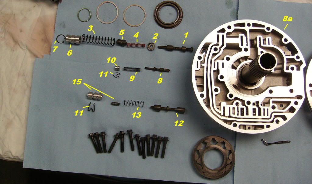

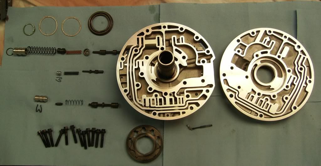

Pump Exploded View​
Images 1-3
Pump Exploded View: 1​
Pump Exploded View: 2​
Pump Exploded View: 3​
1 PRESSURE REGULATOR VALVE
2 PRESSURE REGULATOR VALVE SPRING RETAINER
3 PRESSURE REGULATOR VALVE OUTER SPRING
4 PRESSURE REGULATOR VALVE INNER SPRING
5 PRESSURE REGULATOR BOOST VALVE
6 PRESSURE REGULATOR BOOST VALVE SLEEVE
7 PRESSURE REGULATOR BOOST VALVE SLEEVE SNAP RING
8 CONVERTER CLUTCH REGULATOR VALVE
9 CONVERTER CLUTCH REGULATOR VALVE SPRING
10 CONVERTER CLUTCH REGULATOR VALVE BORE PLUG
11 BORE PLUG RETAINER
12 CONVERTER CLUTCH CONTROL VALVE ("ON-OFF" ONLY)
13 CONVERTER CLUTCH CONTROL SPRING ("ON-OFF" ONLY)
14 CONVERTER CLUTCH CONTROL VALVE BORE PLUG
15 CONVERTER CLUTCH CONTROL VALVE LINE-UP ("PWM" ONLY)

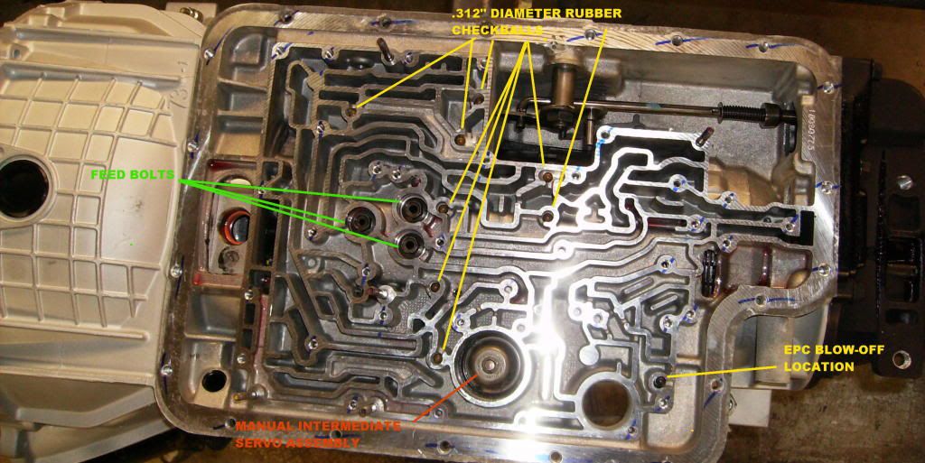

Check Ball Locations Valve Body Exploded View​
Images 1-3
Check Ball Location: 1​
Check Ball Location: 2​
Check Ball Location: 3​

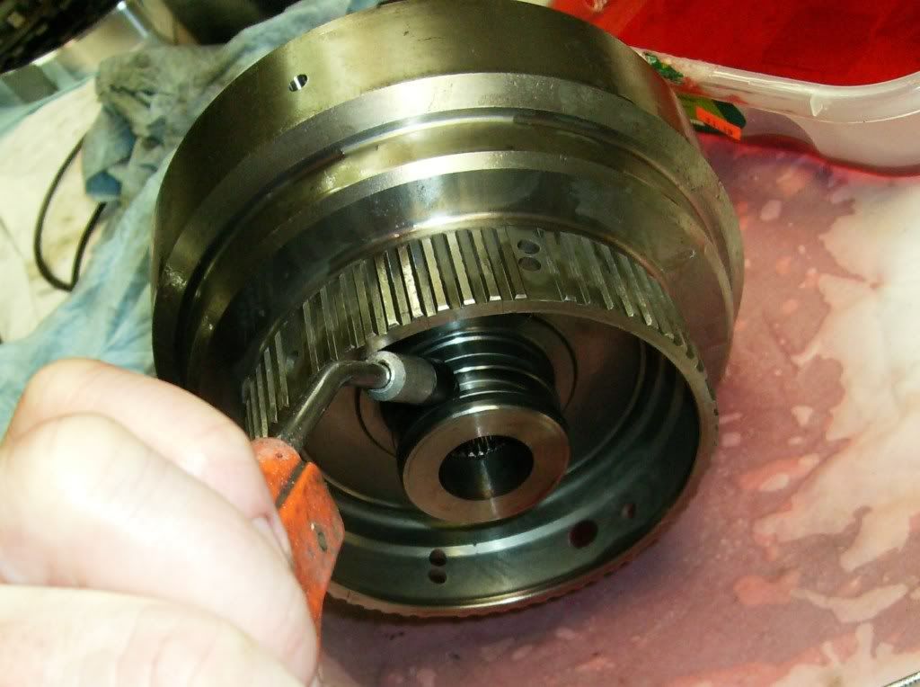

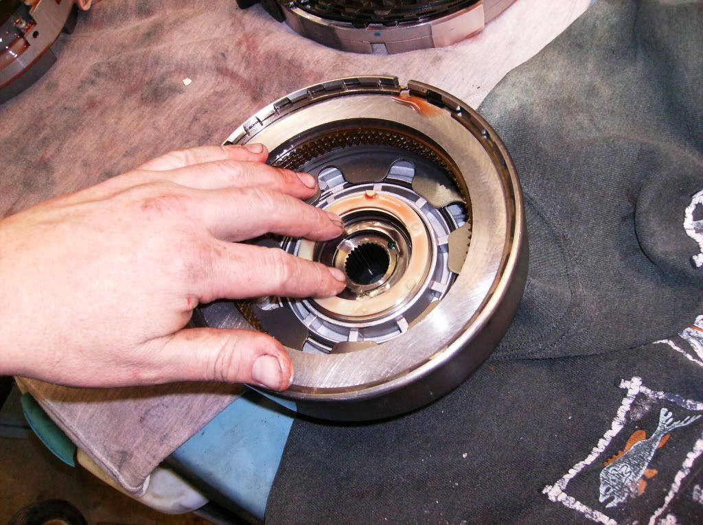

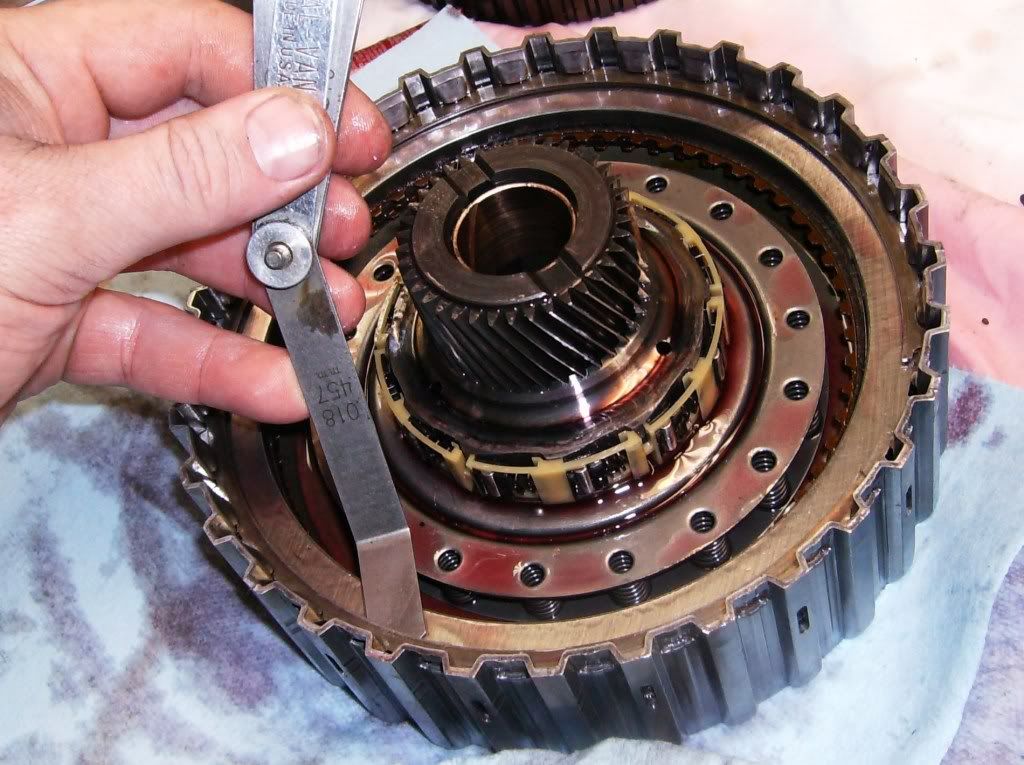

Clutch Clearance Set Up Specs​
Images: 1-9
Clutch Clearance Set Up: 1
Clutch Clearance Set Up: 2
Clutch Clearance Set Up: 3
Clutch Clearance Set Up: 4
Clutch Clearance Set Up: 5
Clutch Clearance Set Up: 6
Clutch Clearance Set Up: 7
Clutch Clearance Set Up: 8
Clutch Clearance Set Up: 9

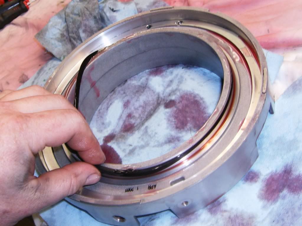

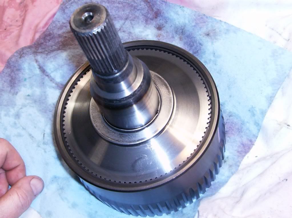

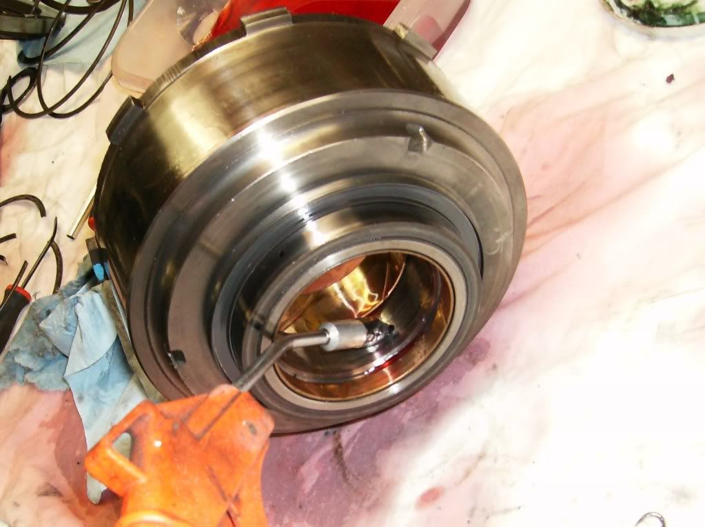

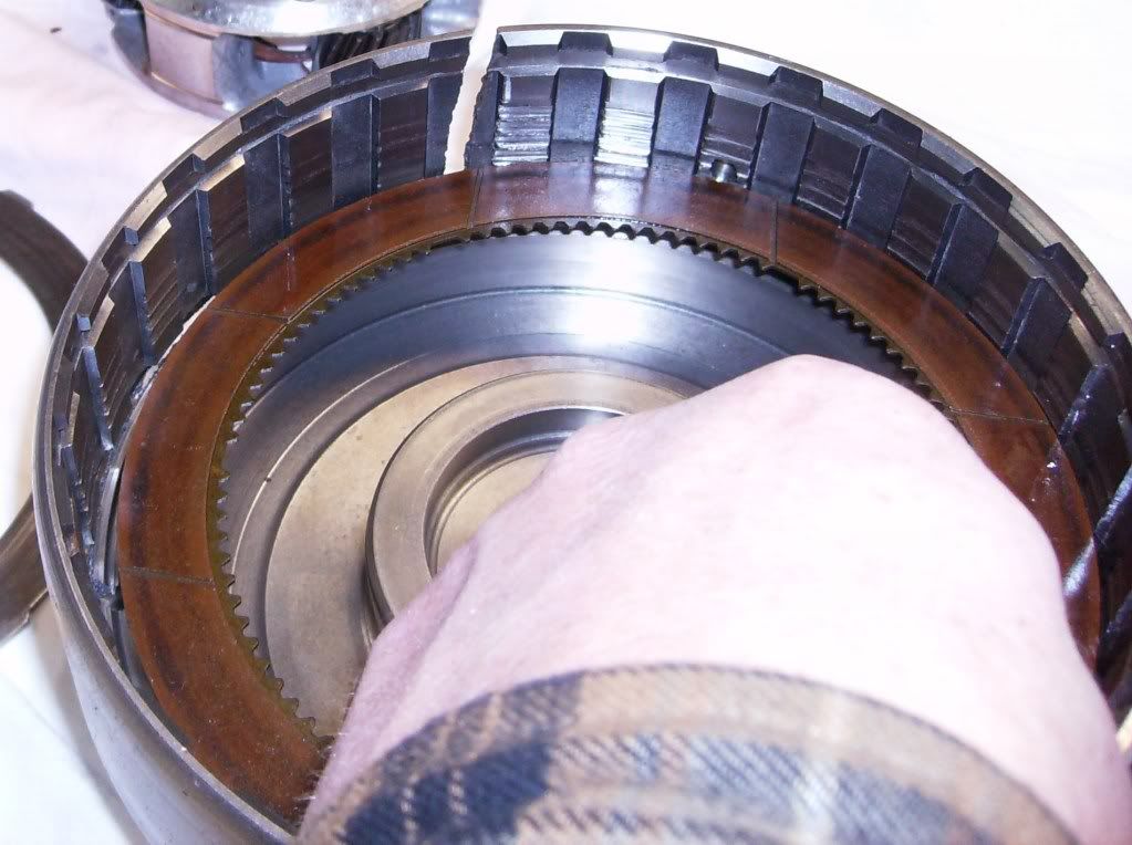

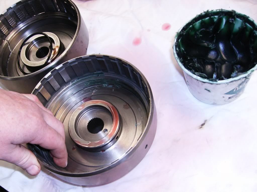

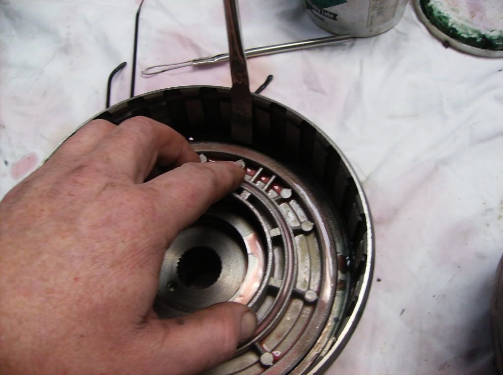

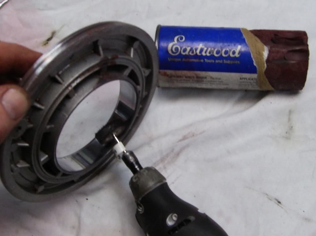

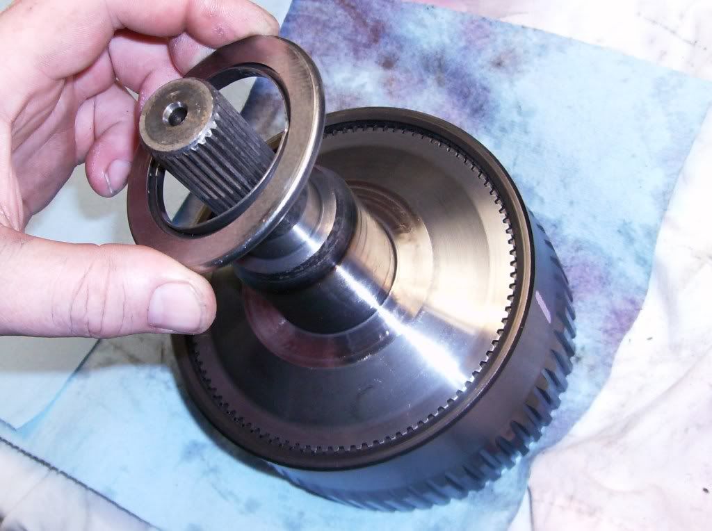

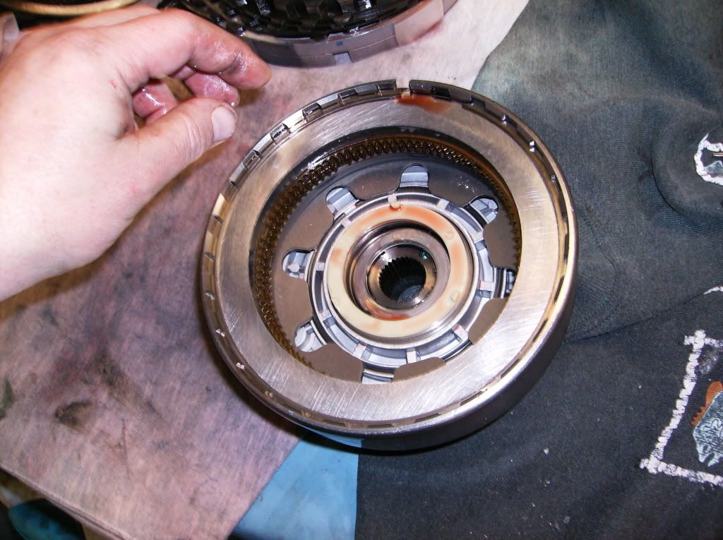

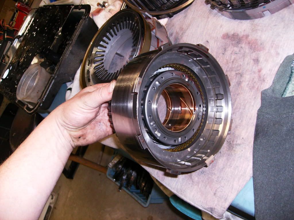

If you find things like this on piston surfaces, do NOT just pass it and let it go. it will cause early failure.
Polish it smooth and evenly or replace it if in question. they are not worth guessing over.

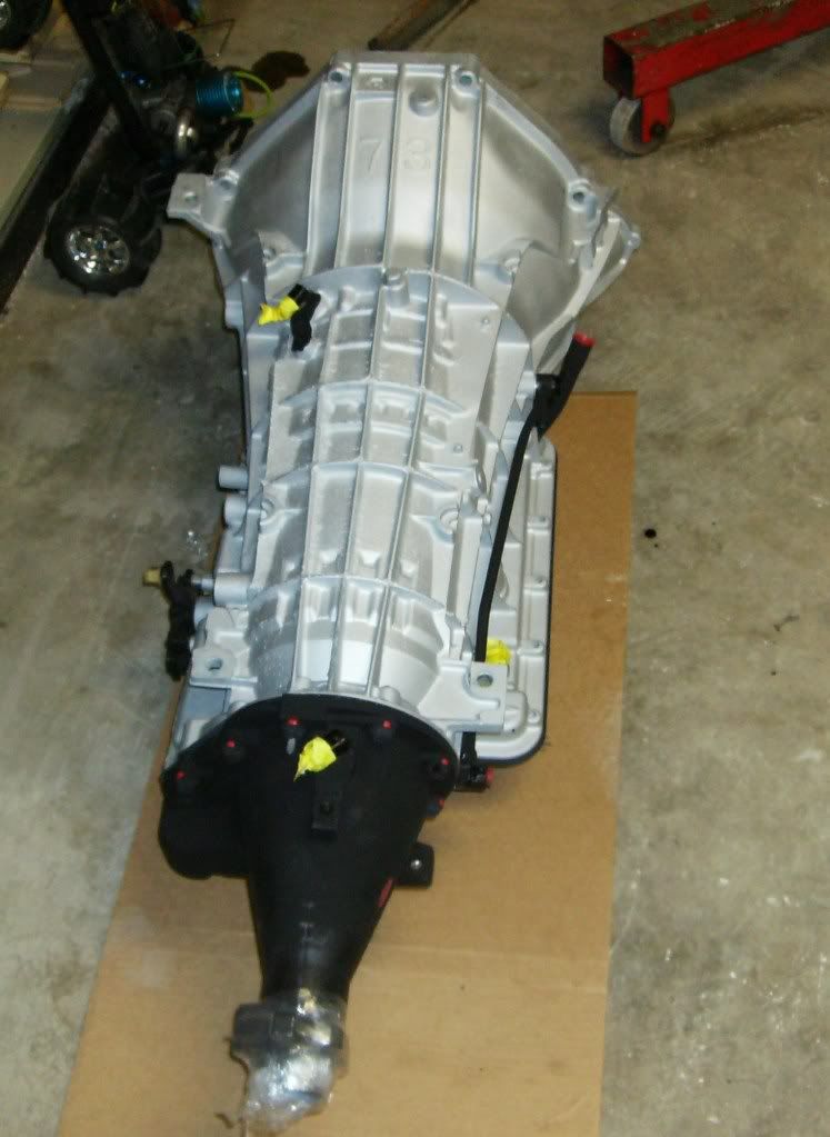

4R100 Reassembly/Rebuild Pictorial
Part 1 of 6
Images: 1-40​

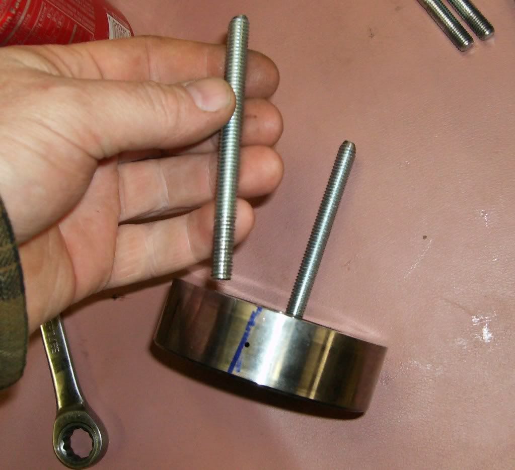

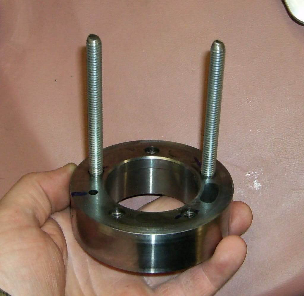

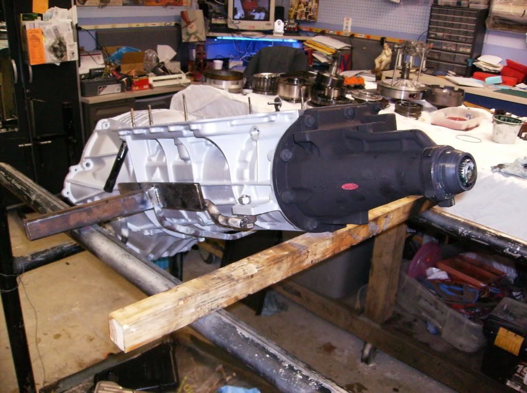

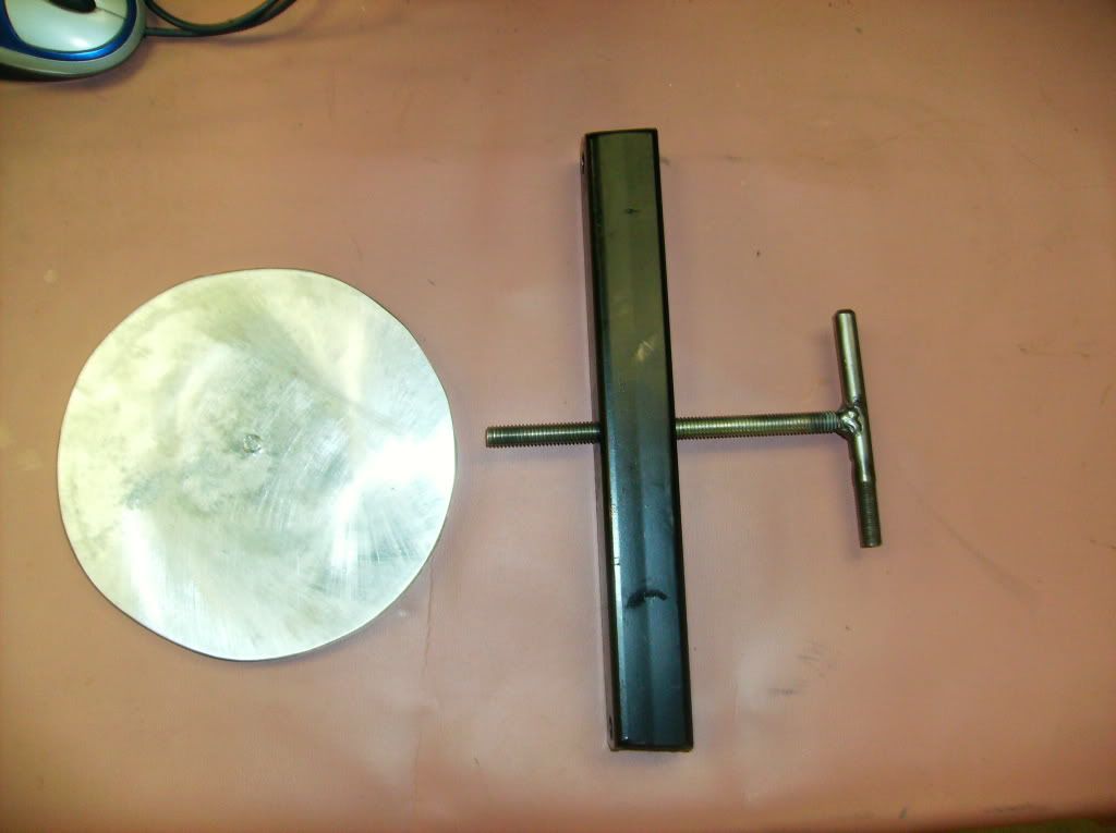

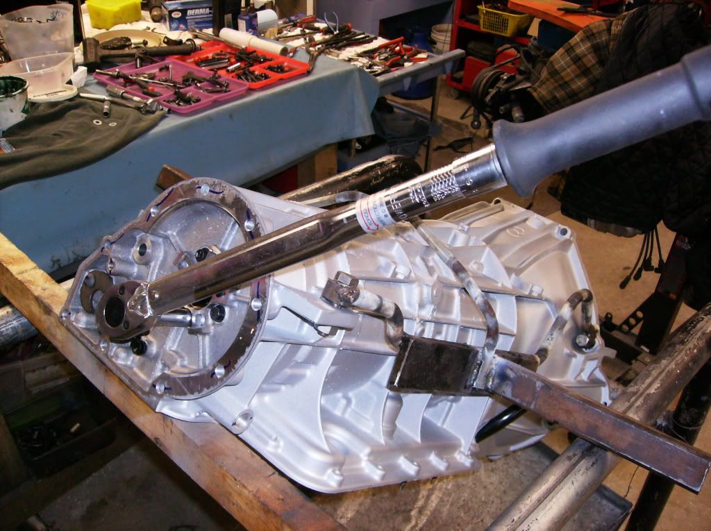

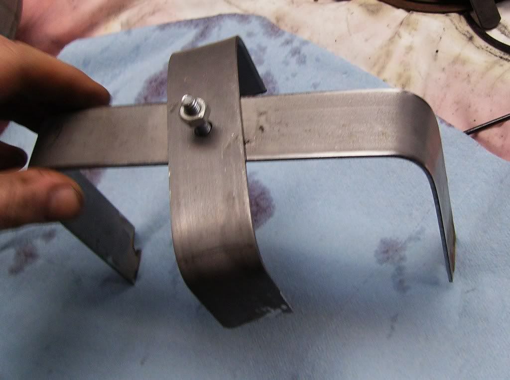

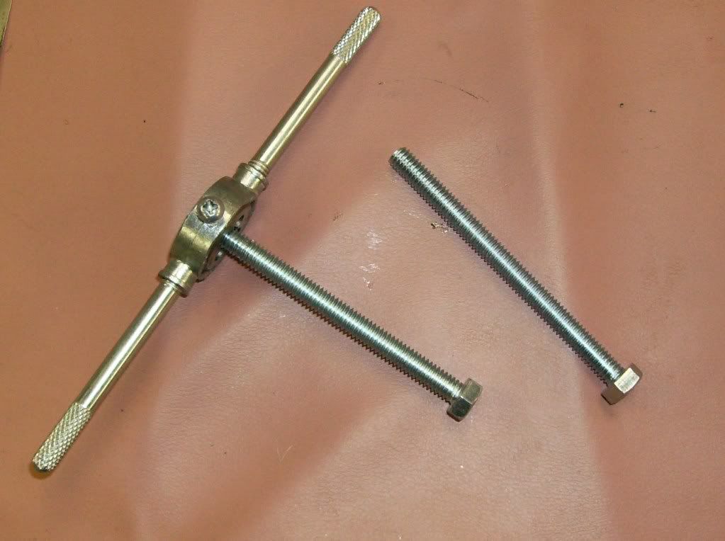

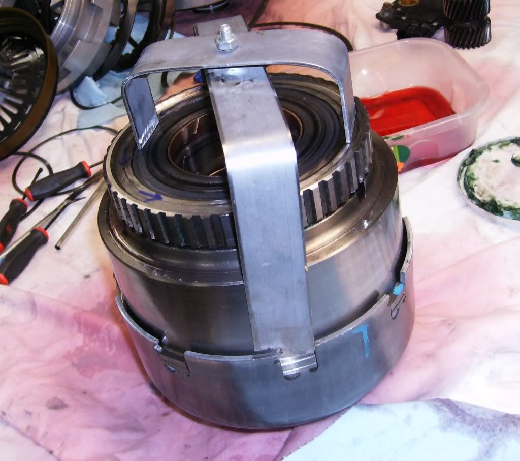

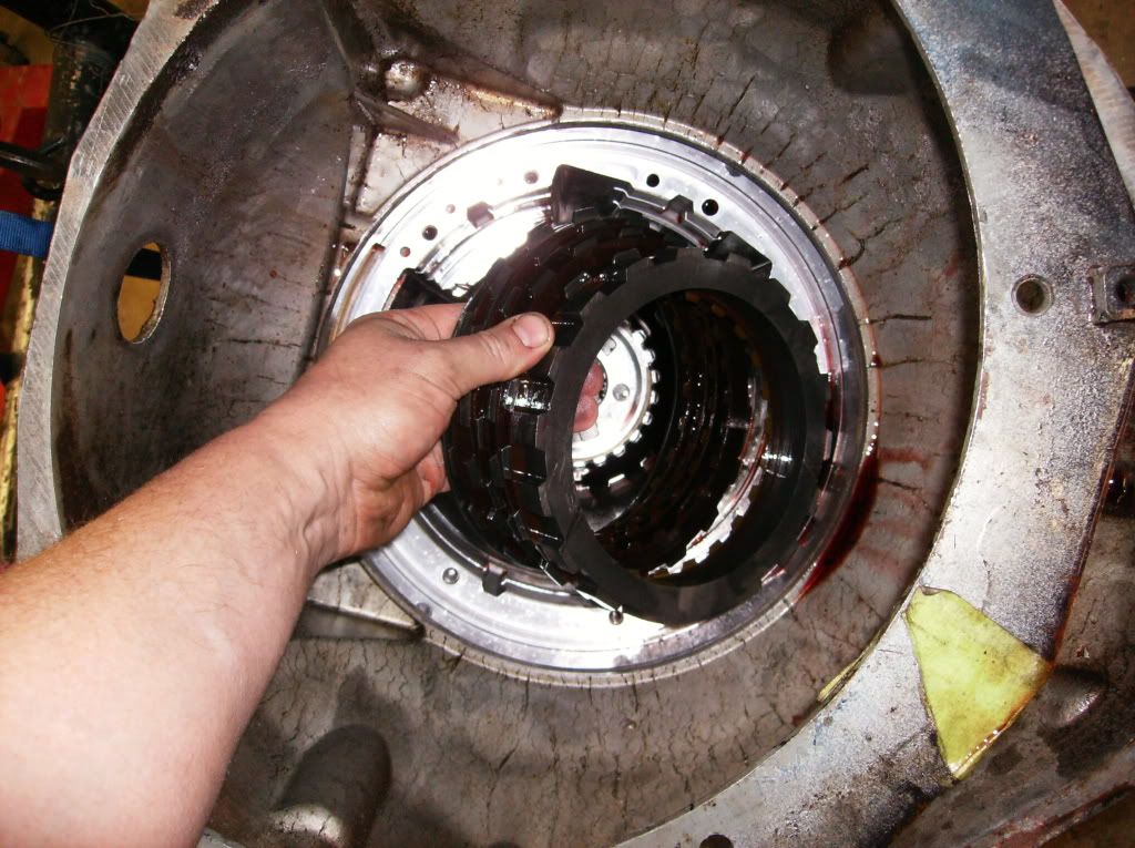

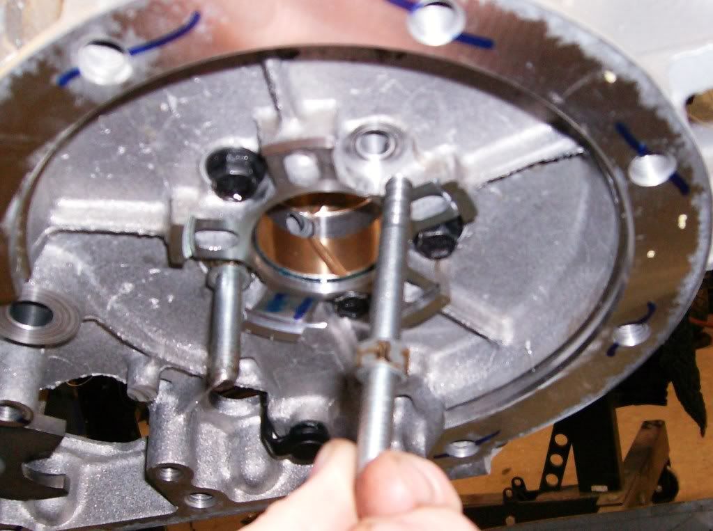

To rebuild the 4r100 there are a few tools that make life much better. They are very simple tools to fab up your self.
To service the reverse clutch piston seals you will need 2- 3 inch or longer 5/16 24 all thread studs. I didn’t have in my supplies and couldn’t find any at my local hardware store so I simple took a couple all thread 5/16 18 bolts. Ran a 5/16 24 thread die over them and cut the heads off. Perfect 5/16 24 studs.

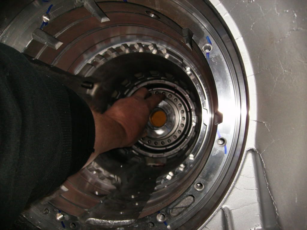

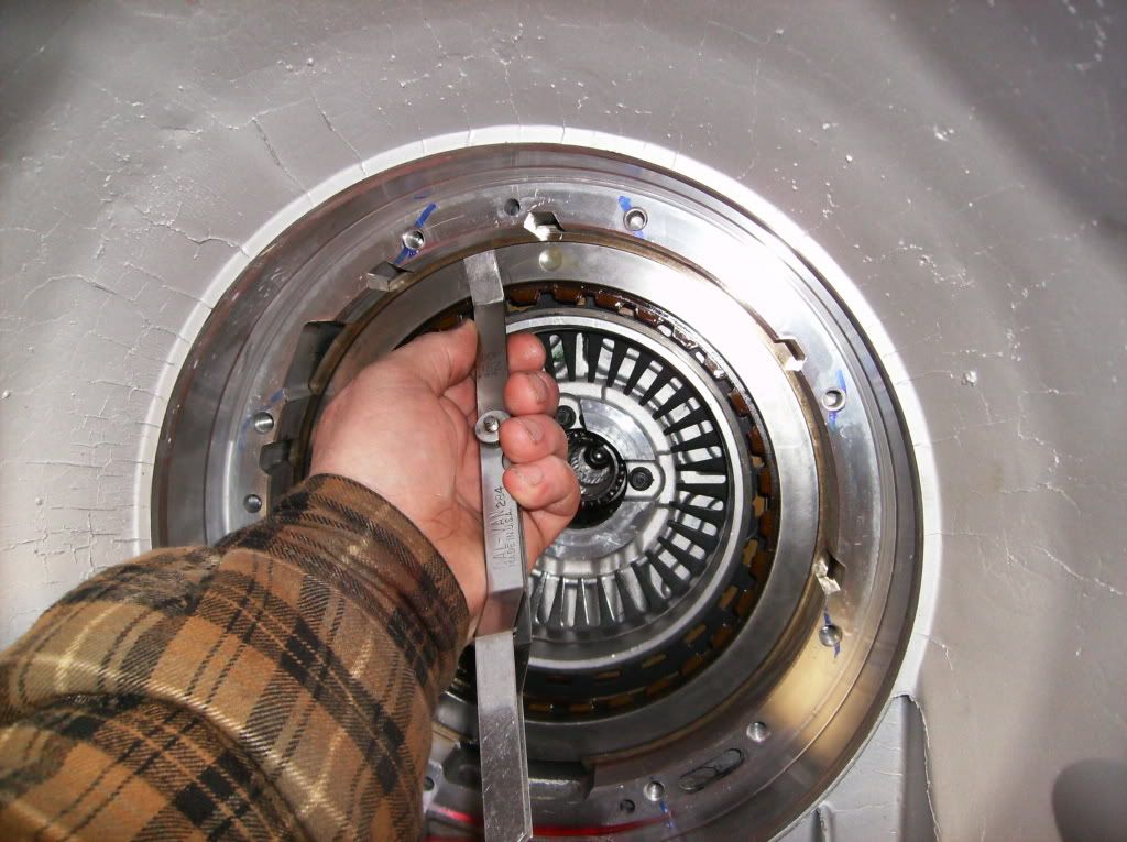

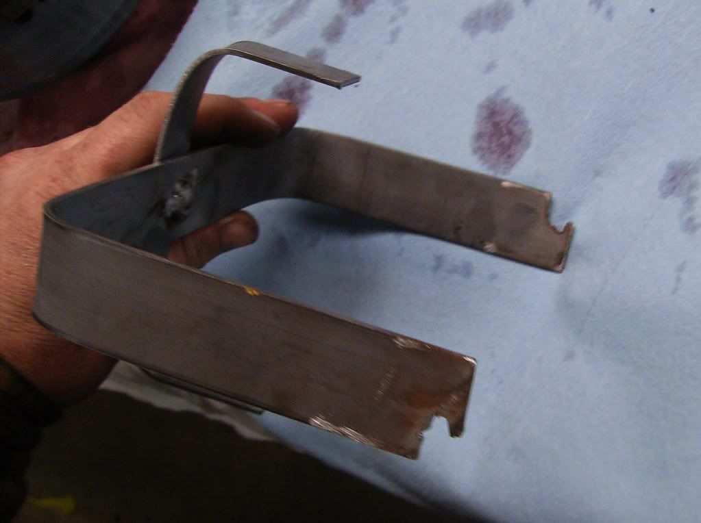

To make installing the direct/forward drum a breeze. You can make a simple tool to install them as an assembly.
You can purchase this already made from several suppliers. I made mine from a single stick of 1/8 X 1 ¼ mild steel purchased from the local ace hardware.
I cut one piece at 17 inches and the other at 8.5
The 17 inches piece has bends at about 5 inches on both ends.
The 8.5 inch piece has bends at about 2 inches on each end
Hole drilled in the center of both and the ends of the 17 inch cut out to match the notches in the direct drum.
Works great!
To install the intermediate/ overdrive snap ring you will need a clutch spring compressor. You can buy these from various suppliers. I made mine very simply from a piece of plate aluminum and some tube steel and all thread.
I used the pump itself for a pattern to mark out the brace section and drilled the two holes. Again, using the pump itself for a pattern is suggested to get your bolt hole and length dimensions.
I then ground the ends of the brace/support to match the contour of the transmissions case itself.
Then tapping out the brace for the all thread and welding on a handle.
The flat press plate aluminum disc is simple just to 6 7/8 inches. This can be larger also.
You could use steel for the press plate.
The 4R100 is actually a very easy transmission to rebuild as long as you have a few simple tools to help you. You can purchase them from many suppliers or as here make them easily from some common materials.
