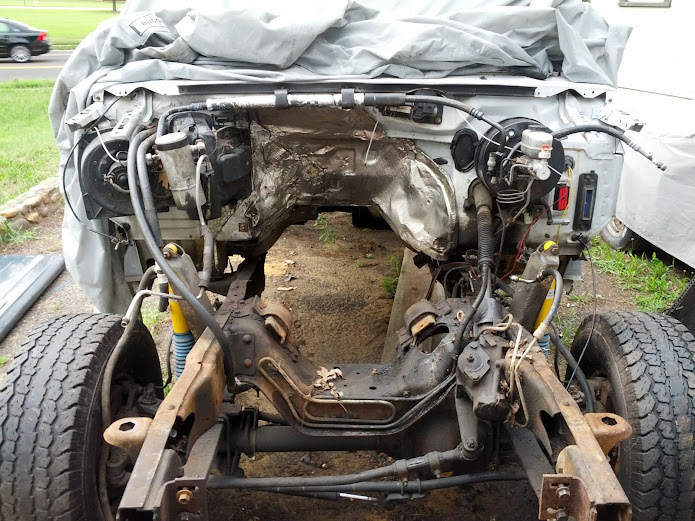

I just got the engine out of my '96, after seeing the stock down pipe it will be going back together with a 3" dp. I just don't know exactly how much to "massage" the firewall without the engine in for reference. Anyone have any pics that might give me some ideas?

I put a 4" DP on mine....cut the firewall out , fabbed the pipe from a NAPA short 90 & a long 45 with a slip joint in it ....fit the pipe to a plate welded to a short chunk of 3" (about 3/4" long) directly behind the turbo, then fabbed a heat shield and steel cap for the firewall.....
PITA, but cools better....it's not always about how MUCH hp you make, but about how much heat you can get rid of....

Did you take the dash out to do this
__________________
350/200 Full Force Hybrids, gen 3 oil, s468, H11s, comp 910s, Irate t4 mount, homemade RR fuel system... Twisted tranny
  #42
Old 09-04-2012, 10:10 PM
Old OutLaw's Avatar
Old OutLaw Old OutLaw is offline
Sergeant
Member's Gallery
Join Date: Mar 2012
Location: Suthren OryGun
Posts: 206
Default
no.... cut the floorboards out.

Well i had the cab off for head gaskets so i went ahead and made a full 4 inch downpipe, slightly ovaled but it clears everything! Some messaging was necessary
