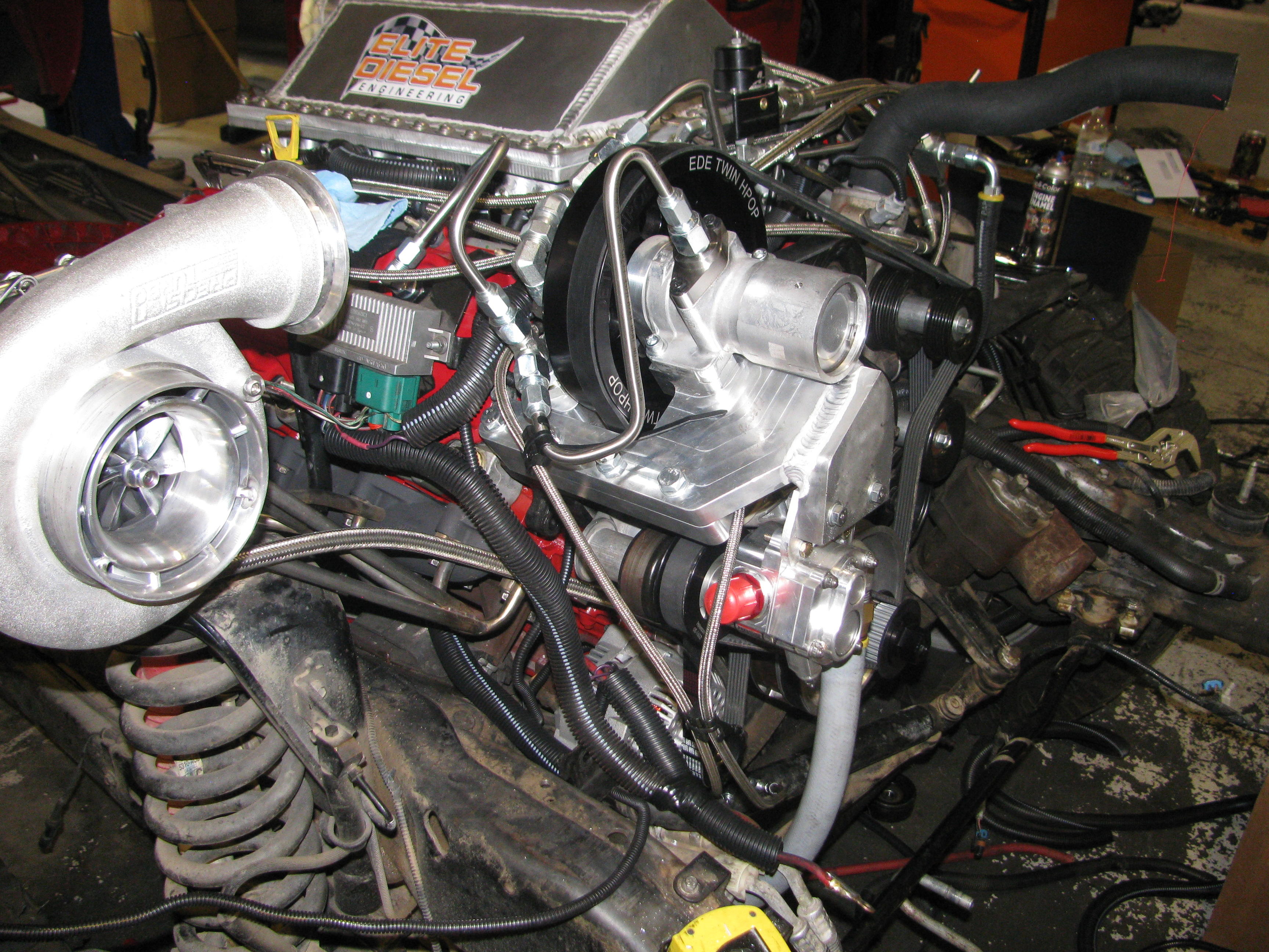

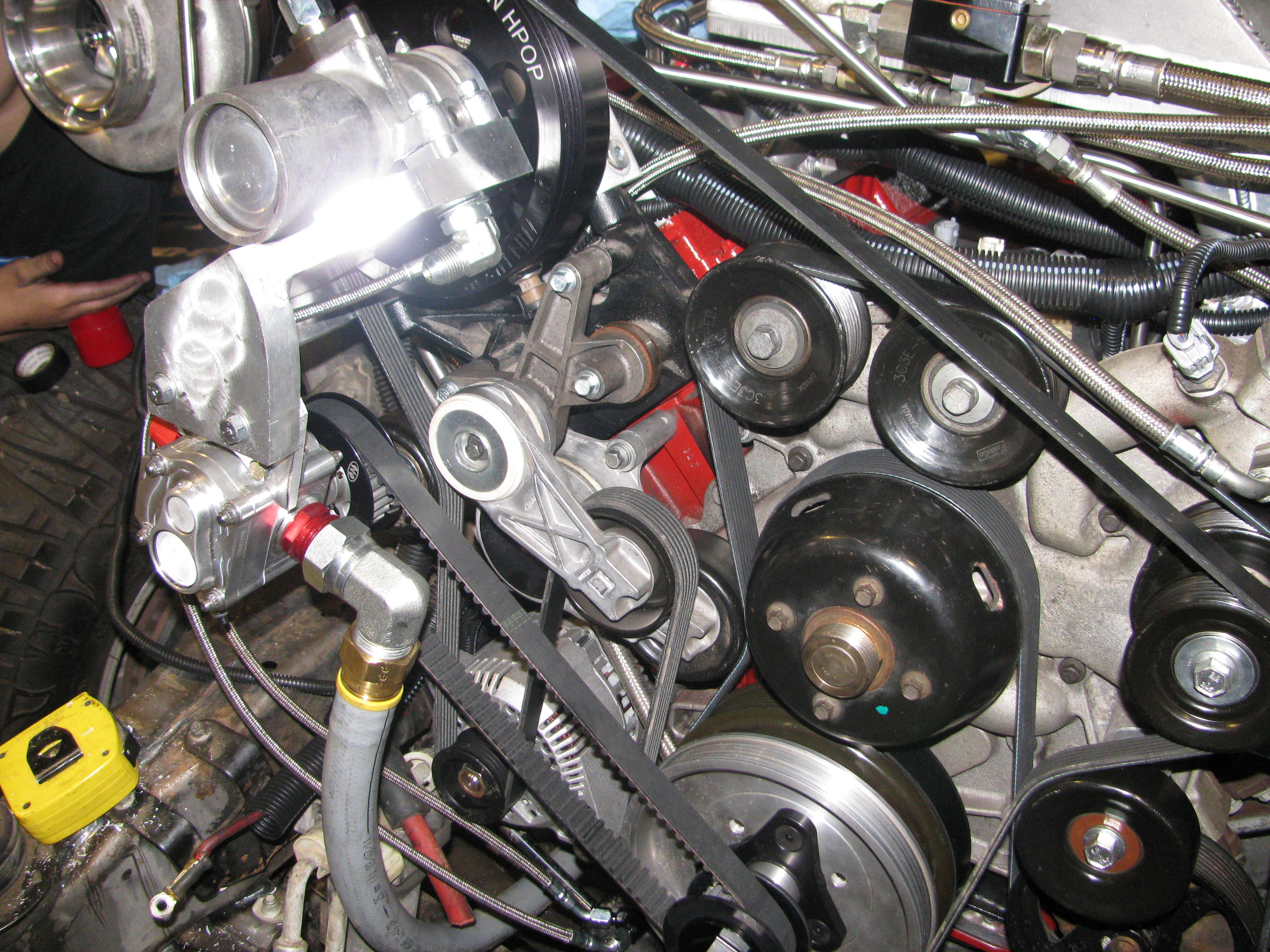

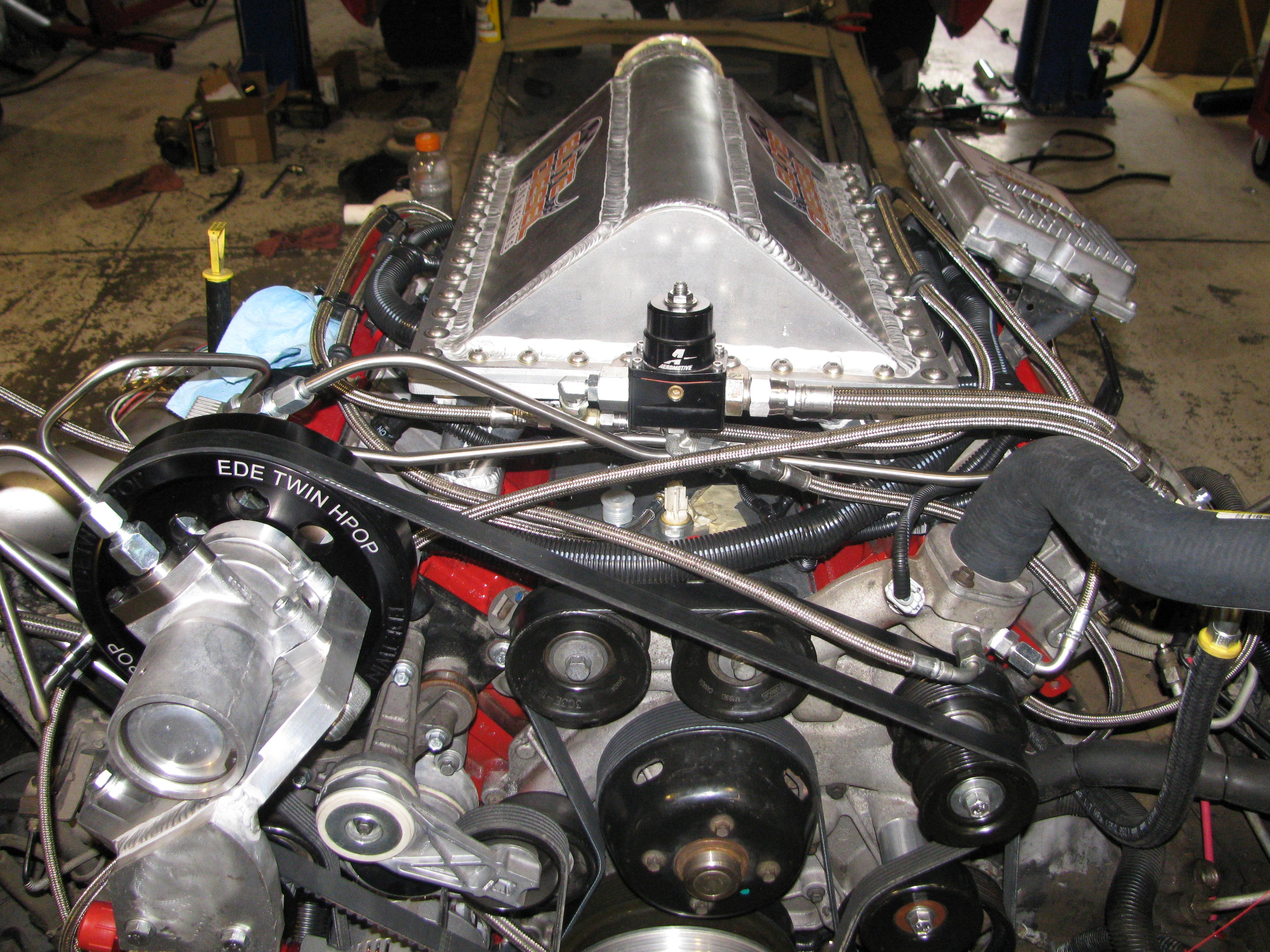

Here are a few pics of a truck we have been building that is almost done. It includes many "fixes" for all the failures we have run into trying to spin a 6.0L at high rpm.
A few of the mods:
Tunnel Ram Intake
Stage 3 Cam, 5500 rpm capable
Twin HPOP
Aux LPOP (nothing inside the front cover)
Roller Rockers
Solid Roller Lifters
Water to Air IC
6000 RPM FICM Tuning

VERY cool! Should have plenty of motor. I have to ask why you went with a coil sprung truck? An 03-04 would be easier to get it on the ground IMO.

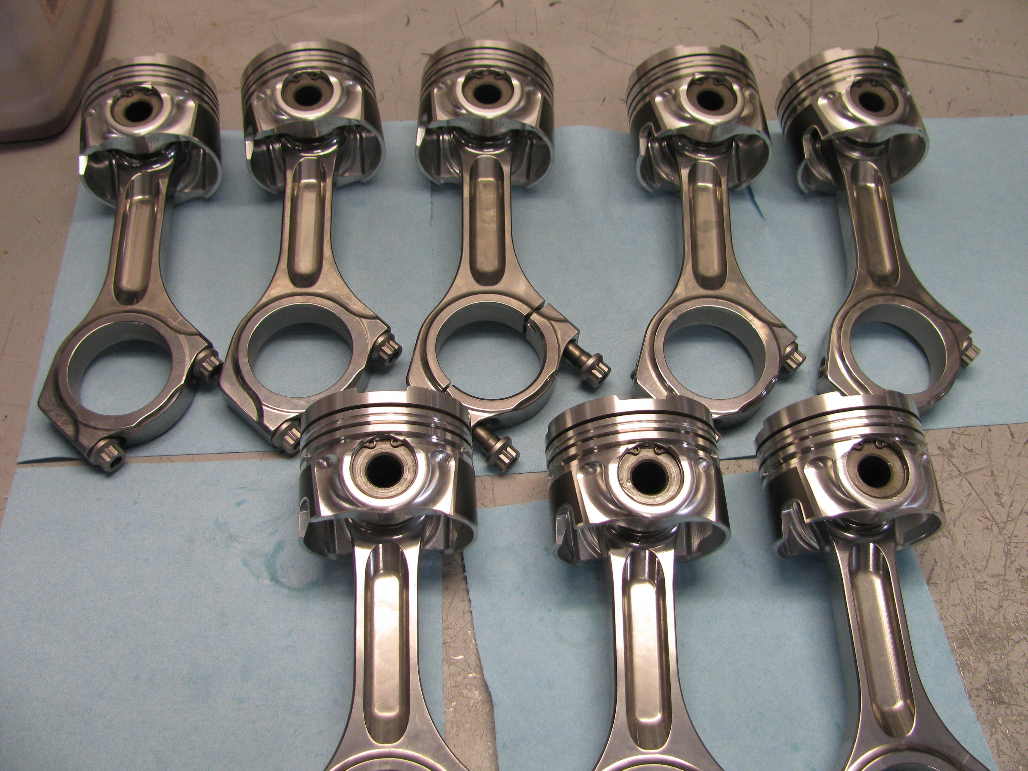

A pic of the cunningham rods and mahle pistons

morgan see that second belt off the crank, and the pulley below the second hpop, right where that FAT gray hose leads to?
absolute badass, elite is not playing games
MorganY
Oct 3, 2011
2,950
college station, tx
Haha ya greg. But the stock LPOP isn't there behind the balancer, so this is an LPOP relocation kit...I think...
This is the coolest thing I have seen since dual fuelers lol
