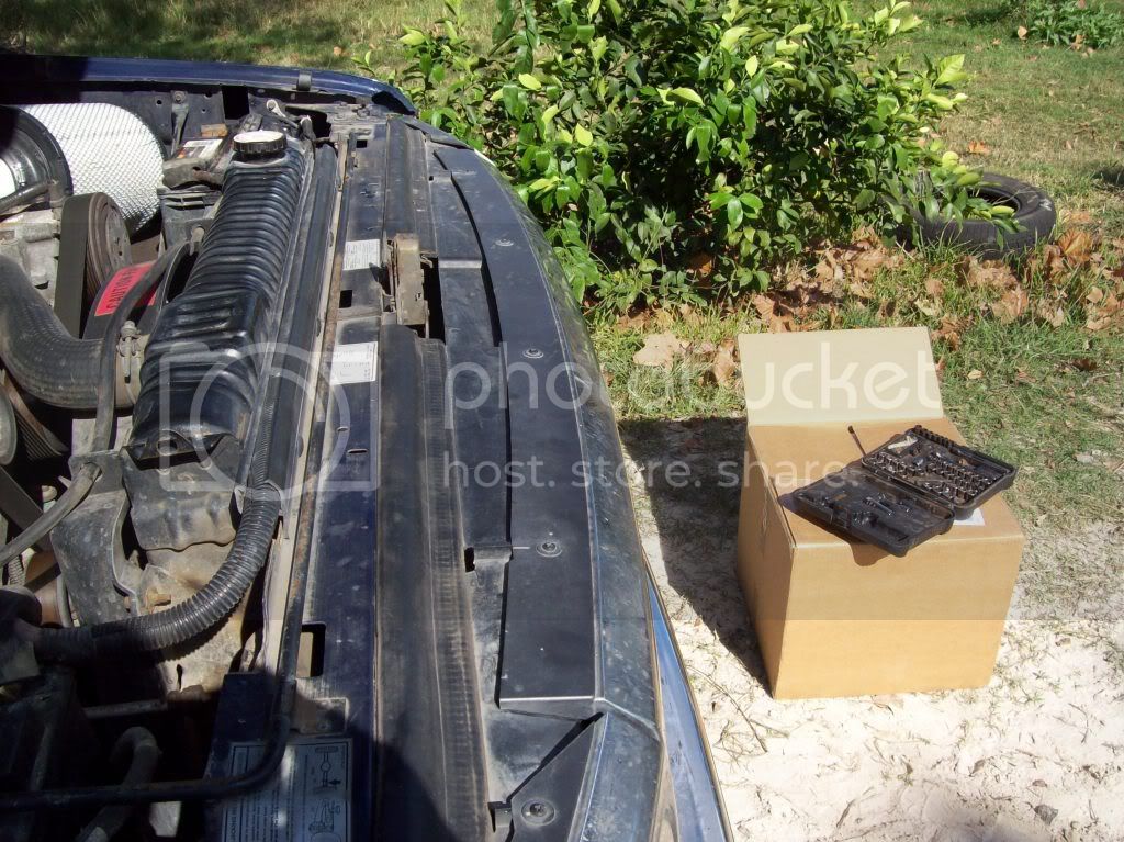

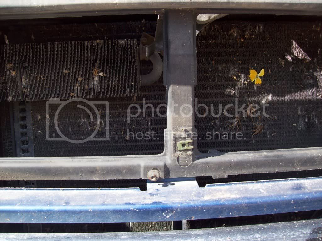

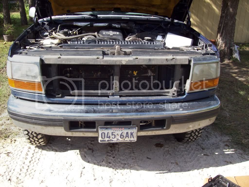

First step is to remove the grille:
this is a realtively simple task to accomplish, simply remove the top 4 screws and the one screw located in the middle of the grille twoards the bottom of the grille.
Second step is to remove the headlight bezels:
this to is simple, but make sure you know where all the bolts are;
First it does help if you remove one battery before you attempt to take off the bezel.Next remove the top 2 screws, and with the battery out of the way, find the two bolts holding in the parklights/bezels in place, there are only two of these, they are located on both sides of the backside of the parking light, below the headlight. You cannot see these bolts you simply have to feel for them. One is located where the blinker light bulb and wiring is- through the radiator core support, the other is located on the opposite side of the parking light bulb hole. There are hole big enough in the radiator core support that allows you to use a socket and wrench to loosen the nut holding onto these bolts. Once the nuts are broke free, unscrew and remove by hand. Now that the nuts are removed you may remove the parking lights/ sidemarkers/ and bezel in one piece, on both sides.
* take note that the headlight is attached to the grille reinforcement panel and cannot be removed until the grillle reinforcement panel is.

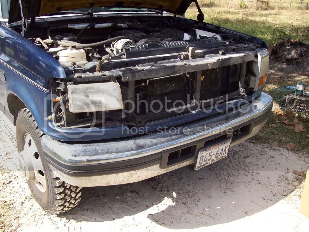

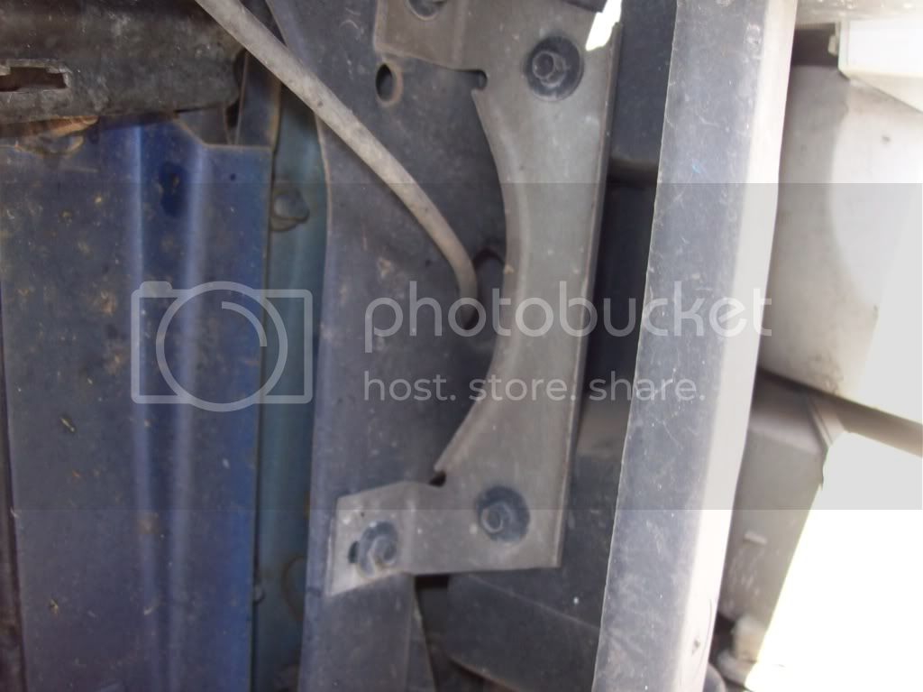

The third step is to remove the grillle reinforcement panel:
this is extremely simple. Simply remove the bolts with your socket set:
not pictured are the two bolts that are covered up by the bezel, they are located on the farthest side away from the truck, over by where the sidemarker light is.
* this is just one side, dont forget the other.

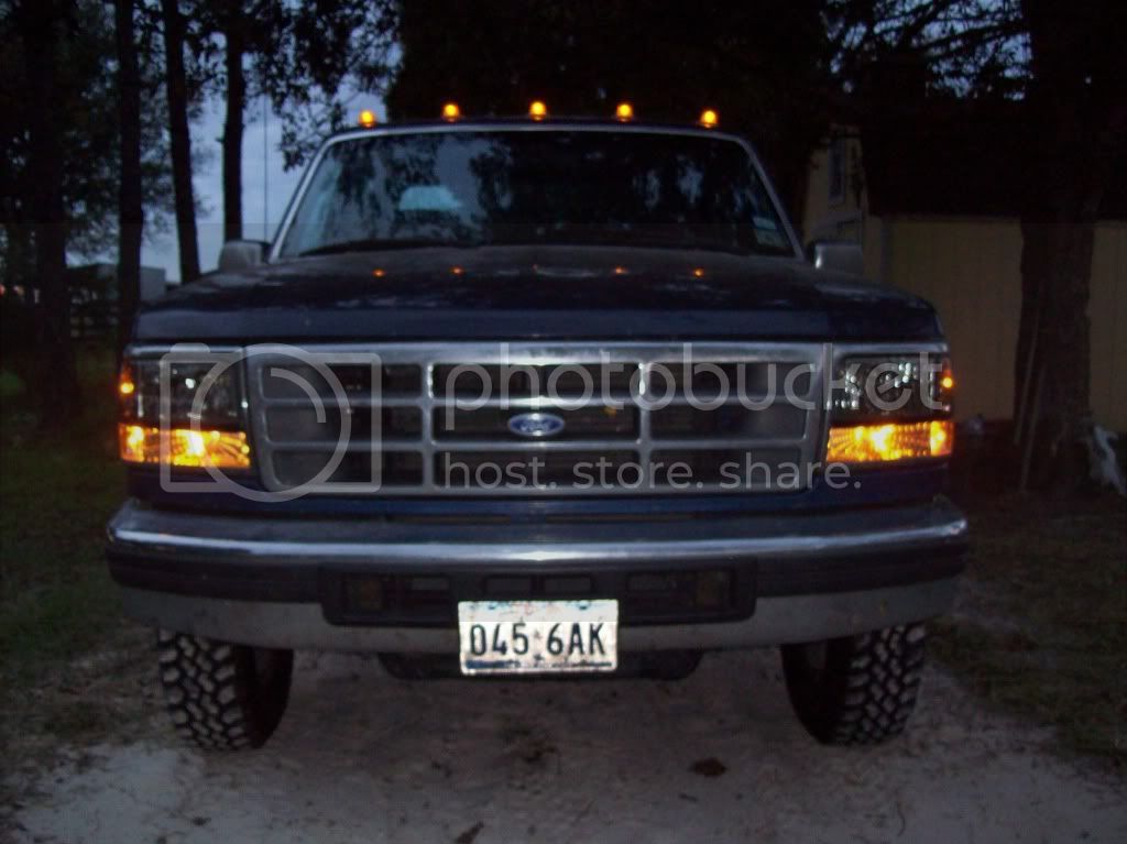

and that is it, that is how you change out headlights on an OBS.

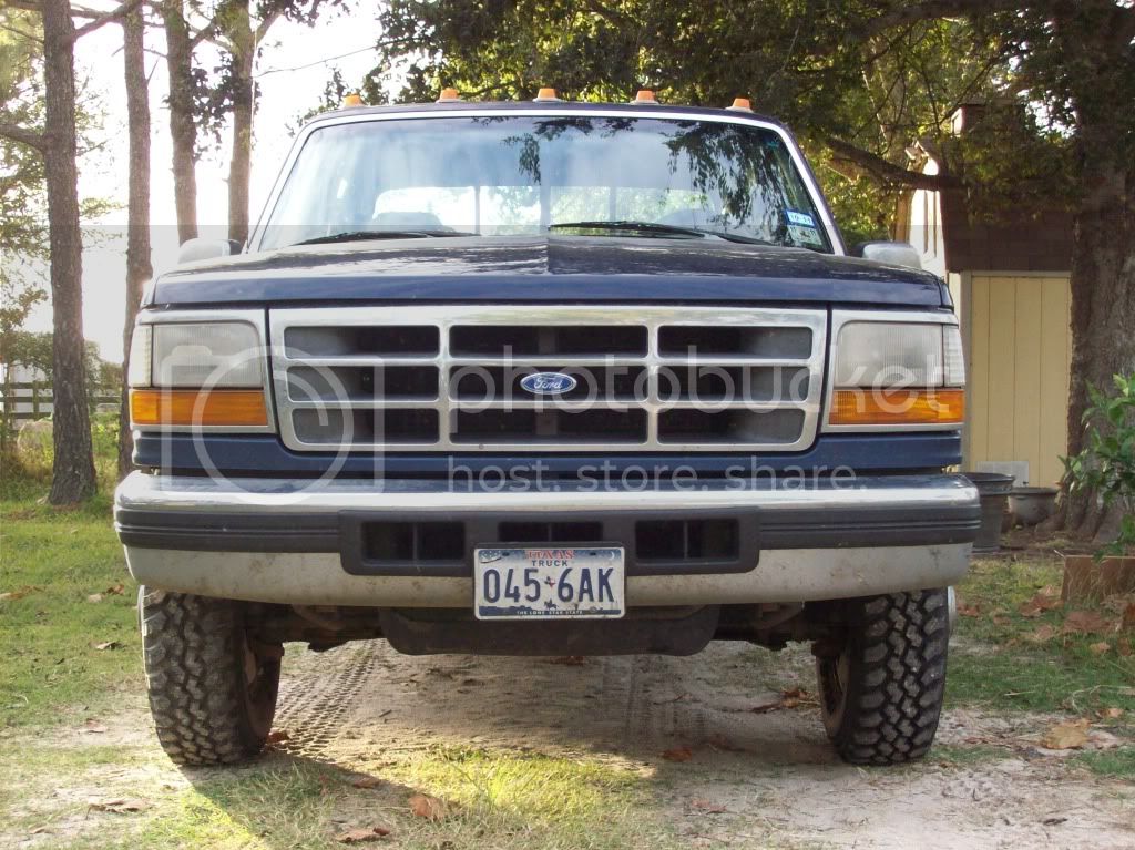

Before:

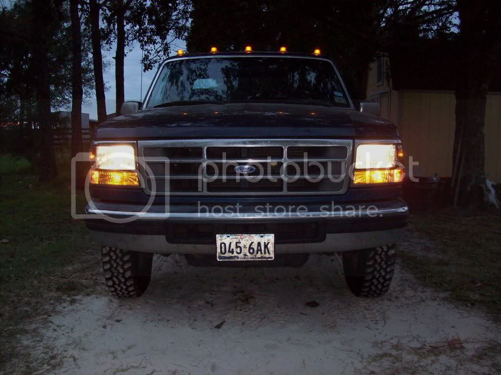

And After:
