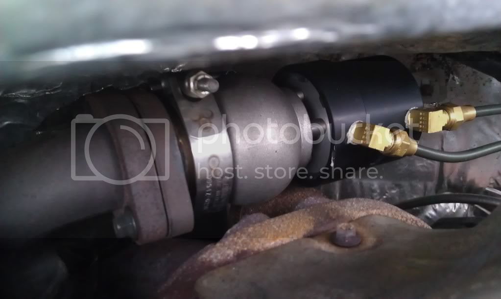

Hey guys, i am in need of some help, I am looking at buying a 2008 f350 that has had some work done. I took it for a ride today and from what I could tell the waste gate and blow off valve are not working right or in tune. if you are in between easy and full throttle you can hear one of the two letting off pressure but if your into it neither activates till letting off. If i get into it like half throttle it would buck like it would get into the power then dump so lose power right on a shift and you get the idea. But if i was easy on it or laid into it, the thing felt great through and through, power and shifting wise. So I am unsure of how to tackle this problem if I buy the truck. I figured the blow off valve was overkill so I would shut it down and try and tune the waste gate in and see how it does there. Any input or thoughts on this would be much appreciate.

Not sure about the brand, the wastegate has a downpipe for itself, it appeared to be a piece of one inch steel pipe that goes down the back side of the motor on the drivers side. Looking at the website it doesn't appear to be an EDE wastegate kit, heres a picture of the wastegate on the truck.

and heres another picture

Looks like a jgs gate..

the way you said that worry's me

Synops(sp?) gate. Remove and replace with a Tial-MVR or a Turbosmart gate. Setup spring pack. Set the reg. Be mucho happy!
Those gates, the one you have, are a nightmare.

it definitely appears to be a jgs, looked one up on their site and it looks the same
