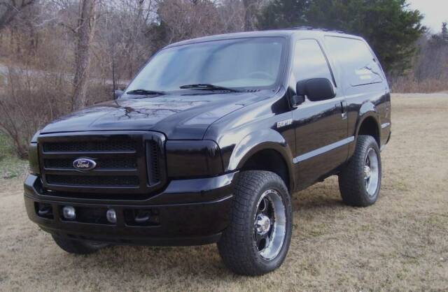

a drag Excursion would be awesome! Another option could be doing a converted Single cab short bed into an excursion, there's a place in Guthrie oklahoma that does it.
http://www.customautosbytim.com/index.html
Powerstroke Cowboy
4,373
154
Montana
But then it would not be a "real" Excursion!!!
That would be like BANKS taking a drag car frame and putting a diesel in it and putting a S-10 body on top of it all.. LOL

That things sick! Im sure you could get an ex down to right around 8k with a driver, but it would take some work. And as the 6.4s are showing, its tough to keep a tranny alive at that weight lol. Definitely possible and a cool project though!
