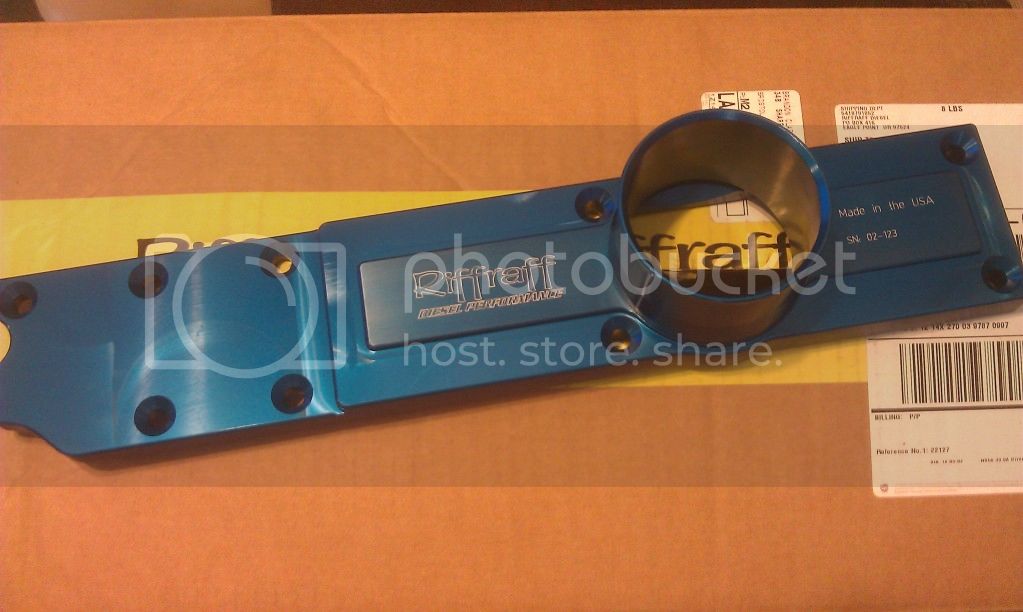

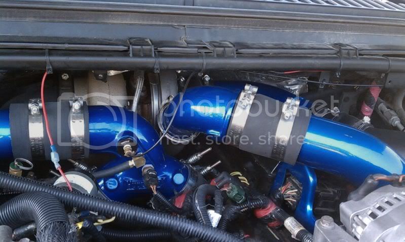

Figured I'd show these off, Clay told me I have the only set around in this color, thanks Clay me and my bud are happy!!! :)

Are those the same ones he posted pics of on Facebook a couple days ago?
Possibly.. I just know they are the first ones this color, :) the motor has that color scheme goin on that my bud is building so its gonna look slick. :)
Clays done a real good job with these for sure.

I should have the second set in that color in a few days. LOL They look great! Be sure to post pics when they're installed.

Nice! I want pics of yours! I swear it took like 2 months for these things to show but it was way worth it, and not like this motor is being rushed its being built piece by piece... for a sleeper truck lol.

my stock ones are ceramic blue..they hold more volume of air to better feed all cylinders equally and with dieselsite boots i didnt need inserts...even at 40 lbs of boost from my 38R...ill never have to pull them off for a dried up oring..I got rid of my fuel bowl for the very same reason..i want billit planums but im going to go with beans..they hold more volume of air then the stocker's do.. but i do like the blue

I sure like the profile of those. I have Beans and they suck for room in the valley with twin pumps. Just not sure I want to trade off space for intake volume.

I for one prefer the RiffRaff ones from the Beans, and far more then the Irate flat bar ones...
I can not see the O ring in the Riffraff ones "drying" out in the lifetime of the motor. They are not exposed to fuel, oil or anything other then cooled compressed air...

What is the highest manifold pressure that has been run with a set of these?
Ya know a great idea I think for Clay to do. From looking at this the actually inlet is a separate piece that then is sealed onto the main body of the plenum correct? I know this was a point of contention for some people. But it may offer a really cool upgrade Clay could offer that I think a number of people may find attractive.
Since that piece is modular I think it would be a good idea if maybe he offered a Vband option piece for it. Would that not be possible. Swap out that one piece for on that had a vband end lip on it. So much like ordering it another color you could order it with a v-band or boot inlet tube.
For me I would want V-band for anything getting in the 60 psig + Frankly I would have liked it stock from the factory. Heck he could then offer a Y with V bands on it as part of a kit option. That would insure they matched up. Then add a extra v-band to weld on to the IC tube that connects to it. That would be an awesome kit as all you would need is to just weld the one end onto the IC tube and you would be V-banded in some of the most frequently blown boot and leak locations. Would also make removal and install of the Y etc much easier than with boots and t-bolt clamps.
Make it at a fair price and I can not see why it would not be super popular. I would use it.
