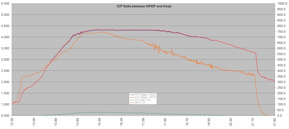

For initial testing purposes, I used an Edge Evolution and installed the EAS Analog Input kit. A second ICP sensor was installed in the manifold of the HPOP so that I could take reading directly from both the HPOP and ICP sensor in the head. I set the Evolution to monitor VOLTAGE of both the factory ICP sensor and the secondary ICP sensor, strapped the truck down on the dyno, and began my testing. What I found shocked me more than I could have anticipated.
Under normal driving conditions, the pressure drop between the pump and the head was negligible. There was some difference, but not what I would consider to be anything significant. However, under a full throttle run things changed dramatically. As my fuel demand increased, I started seeing a noticeable deviation between the HPOP and the head. The full realization came when I finally did a full throttle run. The difference was staggering! As they say, a picture is worth a thousand words and the following datalog image is no exception…
[Click on image to enlarge]
As you can clearly see, there was a tremendous shift in pressure between the HPOP and the oil rail in the head, to the point where it flatlined the secondary sensor output. The initial pressure drop spiked at just over 750 PSI (and that's just what we could measure, since the pump-mounted sensor went out of range!!!), coinciding with the peak Mass Fuel Desired (MOD) request of 74 ms/Stroke. As the RPMs continued to climb and the MFD tapered off, the pressure difference began to close. In analyzing this data, we can clearly see that the oil consumption of the injectors exceeds the flow characteristics of the factory oil delivery system. What's even more concerning is that because of the drop in pressure, the HPOP is being forced to work harder than necessary to build pressure. This additional pressure causes oil temperatures to quickly rise and on hard runs we'd actually see about a 10ºF rise in the 10 seconds it took to perform the run. For calculation purposes, each volt on the ICP sensor equals 967 PSI of oil pressure. With that in mind, the pressure we were demanding from the pump at about 4.3 volts was 3915 PSI. (There is a 0.25 volt offset at the low end of the sensor, so the actual voltage/pressure calculation was 4.05 volts.) Even with the HPOP mounted sensor maxed out at 5.006 volts, the pump was trying to produce right at 4600 PSI ((5.006 - 0.25) * 967). This number could have even been higher! Not good at all, for sure.
