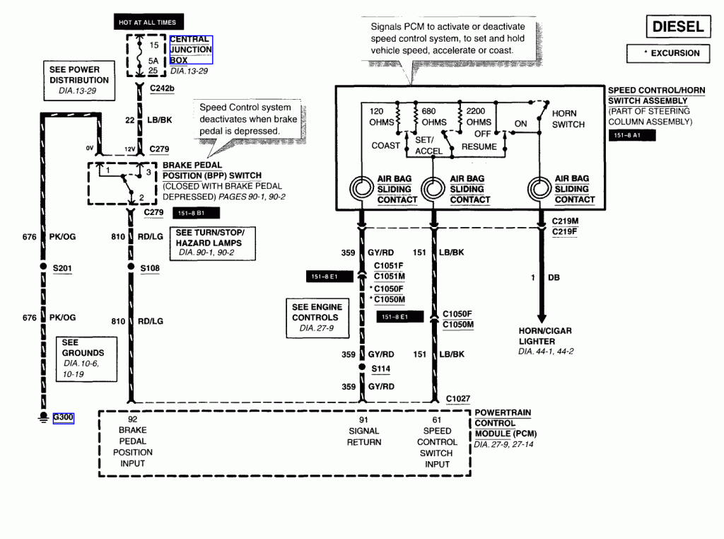

I would really like to have cruise control. The donor 01 has cruise, but no way the steering column and wheel will work. How hard would it be to use the factory wiring and my own switches?

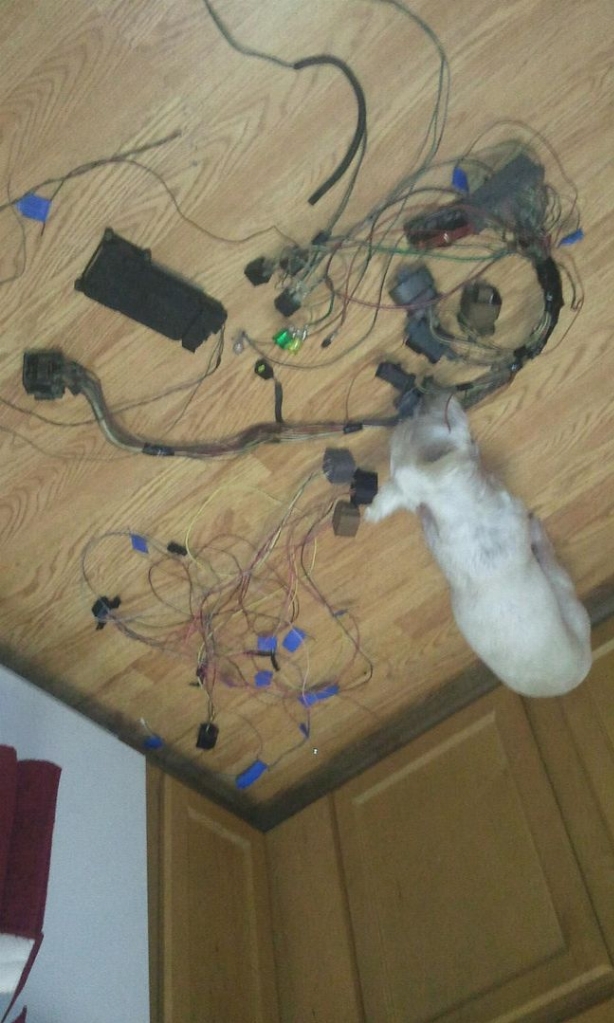

I think this is all I need to make it run and shift.....
This is what is left...
