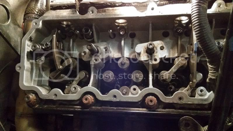

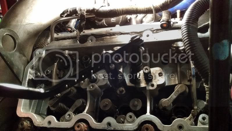

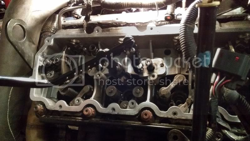

We've got the body in the air on my truck yet again for another round of mods. VS and PR were tackled today. Bought a new spring compressor tool kit and it made the job so much easier.
Took a few pictures and figured I would share.
I really need to do a complete build thread but that will be at a later date.
Any questions, feel free to ask. :toast:

Nice I'm jealous,, maybe a dumb question from a rookie but do you worry about relieving the clamp force of the center head studs? did you just do a couple at a time?

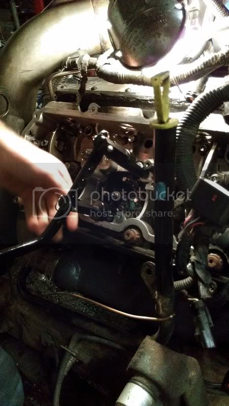

What spring tool did you use? I was looking at the swamps tool at the moment as I don't plan on pulling the heads.
