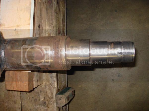

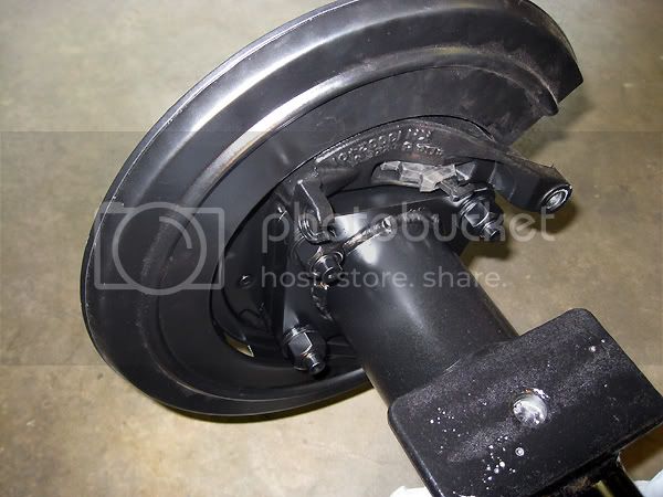

Taking the axle shafts off and removing the hubs and backing plates was very easy. Getting the old backing plate flange off was a bit more difficult. I ended up using a cut off wheel to get through most of the weld, working at the flange in quarters made this easier. The remaining material needs to be carefully ground down to match the axle diameter.

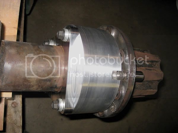

I drew up new flanges in MasterCam and cut them out on the VMC at work from 3/4" 1018 plate. To keep the flange perpendicular to the spindle and spaced correctly I made a simple alignment jig. It bolts to the hub which is then installed back onto the spindle and the nut tightened, this also allows for the flanges to be rotated to their correct position. I did not use the axle tube for a reference surface as I was not convinced it was in the same plane as the spindle. By using the spindle I was assured the calipers would line up square to the rotor.
I had the flanges welded on by a professional welder. I can get by with my welding skills in most cases but don't do it every day and did not want to take any chances with this very important part of the project. Once everything was welded up I cleaned and painted the axle, mounted the backing plate to its bracket and bolted it to the axle. I used self locking nuts on the original bracket studs. Also note I ground out the 4 casting pockets on the spring perches and filled them with epoxy. All they do is collect salt and add to the rusting process.

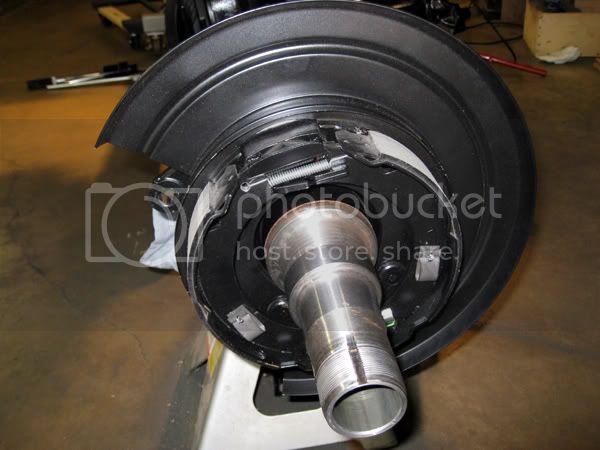

Since the Sterling 10.25 hub is larger in diameter than the 10.5 hub the parking brake shoes need to be modified. Again I made a simple jig to hold the shoes for machining. A pair of dowel pins cradles the friction surface while a third clocks it to position and the shoe is secured with 3 screws. I used a 1/4 end mill and taking 3 cuts to keep cutting forces low, milled away the excess material.
I drilled new holes for the upper return spring, the spring itself came from Mcmaster Carr. Its ends were bent to resemble the green lower return spring. I also had previously milled the backing plate to create some clearance for the spring so nothing would rub.

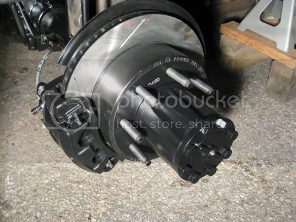

All the hard stuff is done now. The hubs were reassembled and the rotors installed. I went with slotted and cryoed rotors as I had very good luck with them on my front brakes. The caliper and bracket bolted right up and I used Hawk LTS pads.

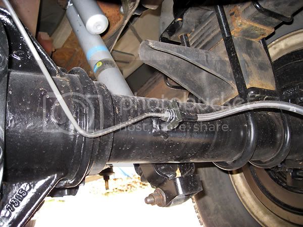

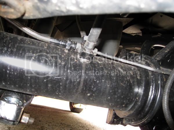

Now it's time to put the axle back under the truck, hook up brake lines, fill with oil and install the vent line. I chose to make a new vent line fitting from stainless steel, copying the original as it had rusted and made removing the brake hose very difficult. I went with new braided stainless flex lines. Because of the hex end fittings I needed to raise the flex line off the axle tube. I made a stainless washer 1/8 thick and cut one surface with a 1.750 radius so it fit the axle tube perfectly. Also because of the way the lines were made I had to machine a special adapter for the driver's side. It's a female inverted flare to female inverted flare coupler.
For the passenger side I made up a little tab and welded it to the axle tube. Again it was machined with a 1.750 radius to match the tube and help provide a solid mount. The flex line is secured with a standard brake hose clip. The hard line is stainless steel, I purchased and installed the complete brake line kit from Inline Tube. I simply cut the pass side hard line to length, installed a 3/8-24 tube nut and double flared the end. You need to discard the supplied tube nut on the pass side as it is 7/16 to match the old drum wheel cylinder.
