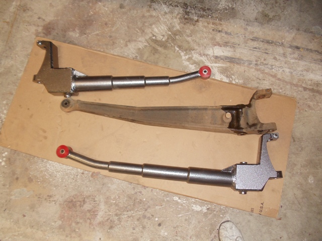

FRONT DROP INSTALLATION:

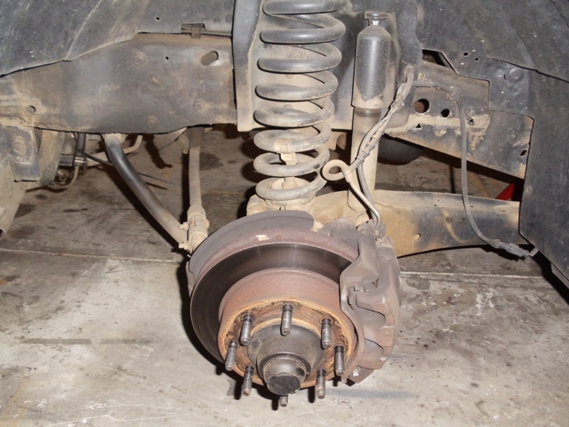

Once the front was jacked up and the wheels removed, the first thing we need to do is remove the brake caliper, the brake rotor, the ABS sensor, and the spindle.

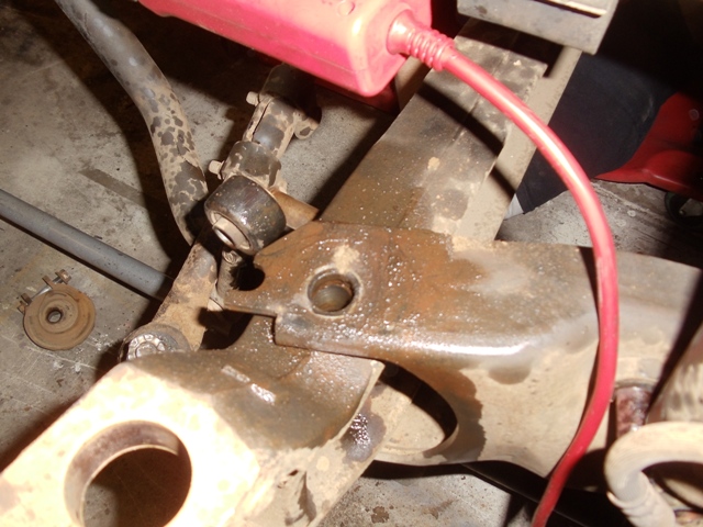

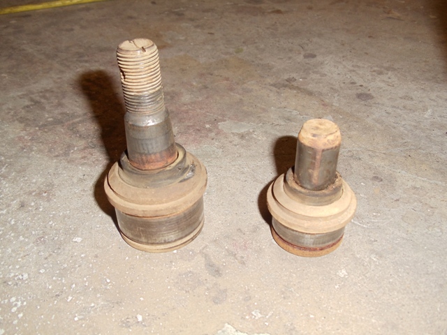

Next, you'll remove the spindle assembly by removing the upper ball joint clamp/alignment adjuster and loosening the lower ball joint nut. DO NOT REMOVE the nut completely until you've separated the lower ball joint. If you do not have a ball joint separator, you can rent one from many auto parts stores. It is also highly advisable that you replace the ball joints while you're there. It will be money well spent. If you don't have a ball joint press, many auto part stores can either rent you one or can replace the ball joints for you.

With the spindle out of the way, you can now remove the front spring. First, disconnect the sway bar link. Once disconnected, jack up the I-beam slightly and then remove the shock absorber. When you let the jack down, this will relieve all the tension on the front spring. With the tension off, remove the upper spring clamp, unseat the spring from the upper perch, and then remove the lower spring clamp. Remove the front spring and set aside. With the spring removed, you can now remove the long bolt connecting the I-beam to the radius arm.
(Click image to enlarge)

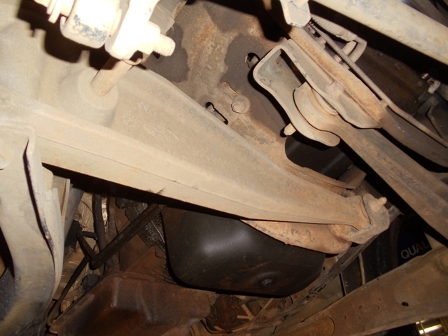

Remove the bolt holding the I-beam pivot to the frame bracket and then remove the I-beam. The driver's side is pretty easy. When doing the passenger's side, you will not be able to completely remove the bolt from the bracket as it will hit the oil pan. You'll have to completely remove the bracket assembly by removing the 3 bolts that hold the bracket to the frame. This isn't very difficult to do, just a little inconvenient.

You can clearly see the difference in the positioning of the spindle with the Dream Beams. That's a solid 3" drop.

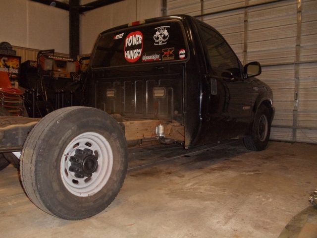

Rear Drop Install
REAR DROP INSTALLATION:
I will tell you right now, the EASIEST way to accomplish this installation is to remove the bed. The kit can certainly be installed with doing so, but it's like removing the cab to do head studs on a 6.0L... It just makes everything accessible. We had started off wanting to do this with the bed in place, but once we started to remove the front spring perches we decided to yank the bed. 4 bolts (in the bed), 3 screws (fuel filler), and 1 plug (tail lights) are all that it takes to remove the bed. That, and a couple guys to lift the bed off the frame. Jay and managed it alone, but I'm sure my back is not going to be happy about it. :D Anyway, let's move on to the details.

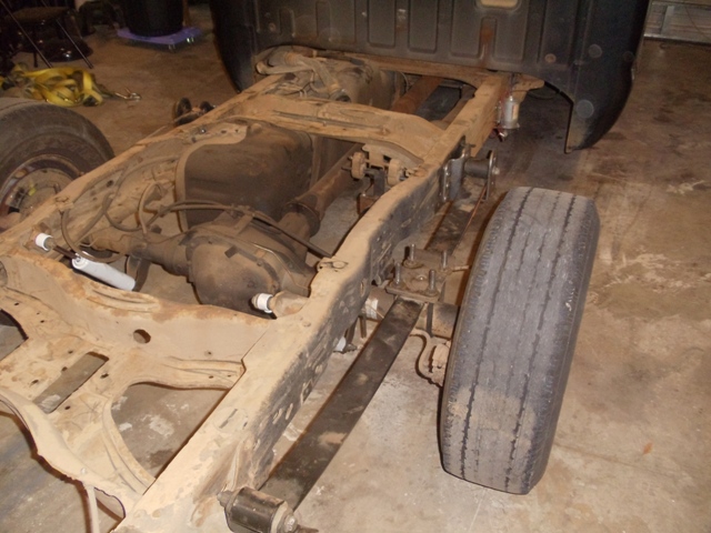

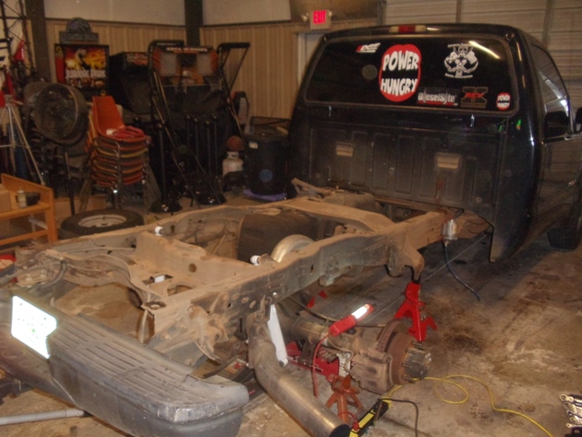

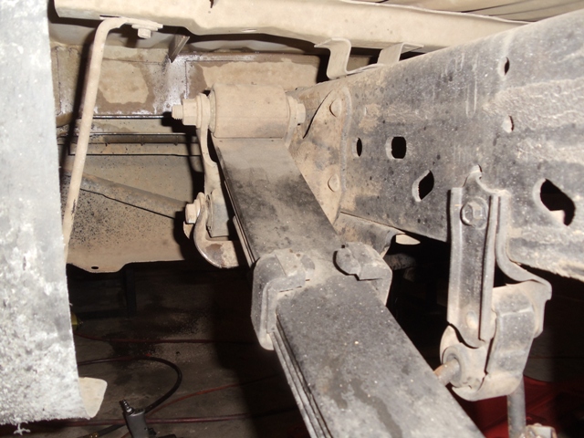

Again, lift the vehicle off the ground and support with a good set of jack stands. Some advice here... Lift the vehicle, remove the tires, and then LOWER the vehicle at least 5" onto the jack stands. We made the mistake of leaving the jack stands at the height for the normal suspension (basically put the jack stands in before removing the tires) and it made it extremely difficult to get the axle lined back up with the springs. Also, when putting the vehicle back on the ground, we had to install a block of wood on top of the jack to lift the vehicle off the stands, so when we dropped it back on the ground we couldn't get the jack out from under the axle. Not a huge deal as we had a second jack, but just a waste of a few minutes.

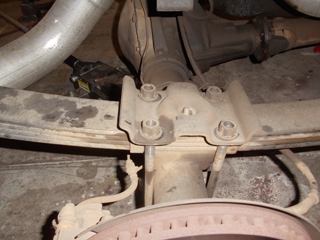

So, with everything lifted and in place, we started by unbolting the axle U-bolts and removing the spring packs. You want to make sure that you keep the pinion supported. It helps with the alignment when reattaching the axle to the springs.

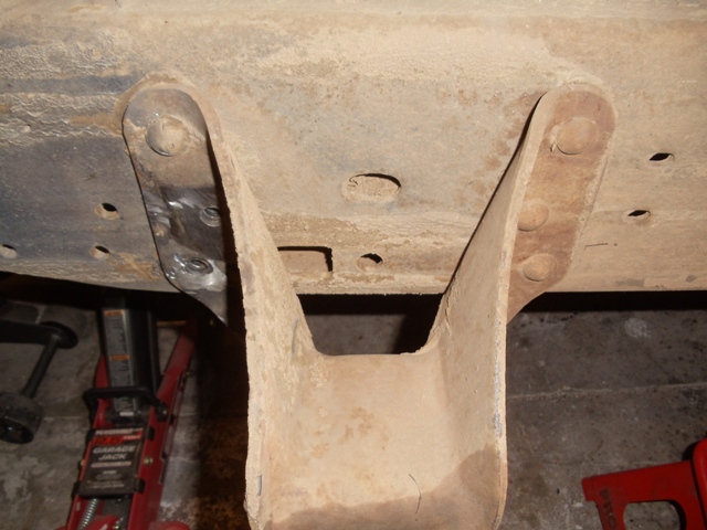

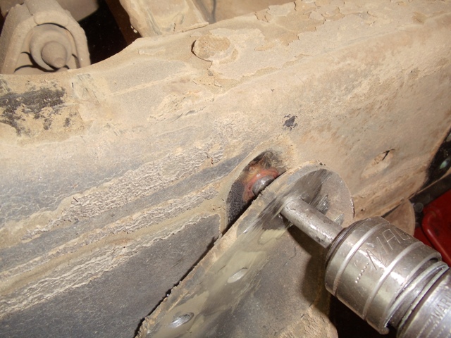

With the springs out of the way, next comes the arduous process of removing the front spring perches. Since these are riveted in at the factory, there are basically only 2 ways to remove them. You can either take a cutting torch and cut the heads off of the rivets or you can use a grinder to grind the heads flush with the perches.
Once the rivet heads are removed, you'll need to use a punch or air hammer to drive the rivets out of the frame. You'll want to be VERY CAREFUL on the driver's side as the rivets are located next to the fuel tank. There is plenty of room for the rivets to come out, you just don't want to drive your punch into the tank.

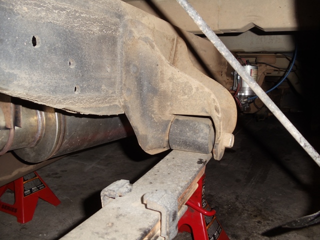

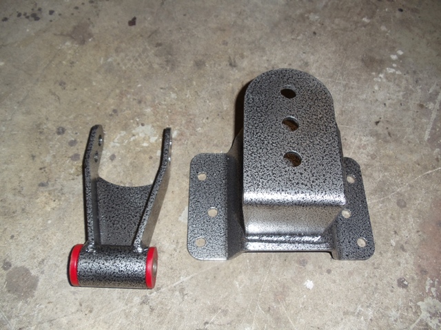

The rest is pretty simple. The new spring perches bolt directly in place of the old ones and has three mounting holes for the spring. There is also included a new rear shackle which helps allow for suspension adjustment and to help retain proper pinion angle adjustments.
As you can see, the truck is leveled out quite nicely.

Oh and FYI, you can use a pointed flat chisel on an air hammer to break the heads of the rivets off for the perches. It is fast and clean, then use the pointed round chisel to punch the rest out of the frame like you did. Just a little tip to make it a little easier and faster for you should you install another kit like that :)
