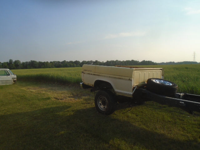

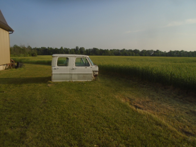

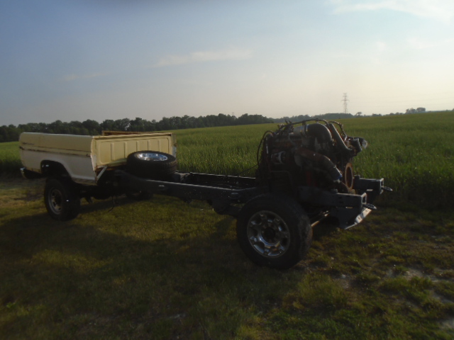

I have a similar question, but i only need to mount the engine and trans in the chassis . I am putting a 1972 F350 cab on chassis and wiring harness and gauges will be all custom. 2001 e450 7.3/4r100 powerplant . 05+ F350 4x4 CCSB chassis and axles. have heard mention of 6.4 frame being different. *engine in pics was just too big*
