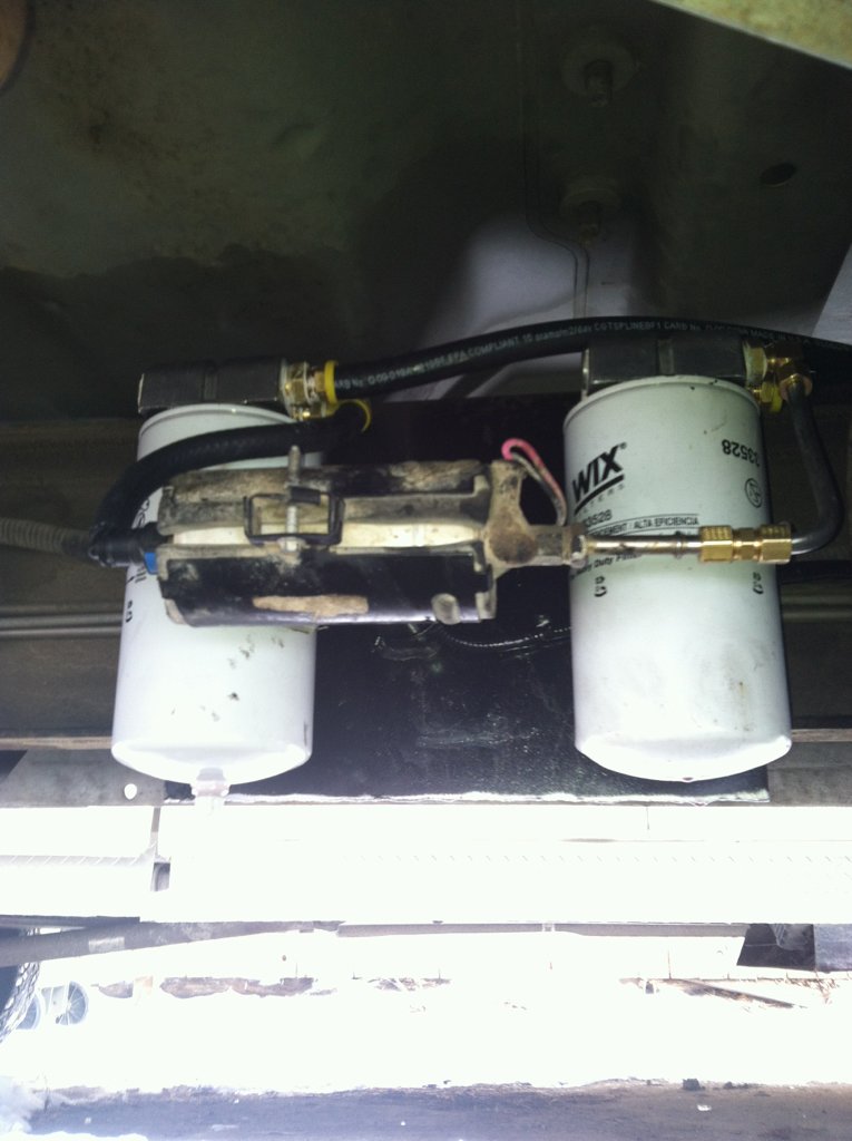

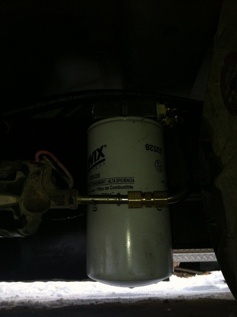

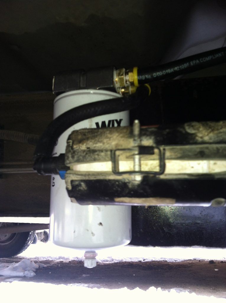

I know this probably isn't for everyone but it is for me. I am fed up with fords expensive filter and sub par water separation. I replaced the factory set up with my own. I used a 7.3 super duty electric pump, two napa 4770 filter bases, napa 3405 water separator, napa 3528 two micron final filter. I used high pressure push lock hose and fittings. The system quick couples to the factory hoses where the oem filter/pump assembly was. The area in the pictures is covered in diesel because I spilled fuel while I was bleeding the air out of the filters and it is too damn cold to go to the car wash.
