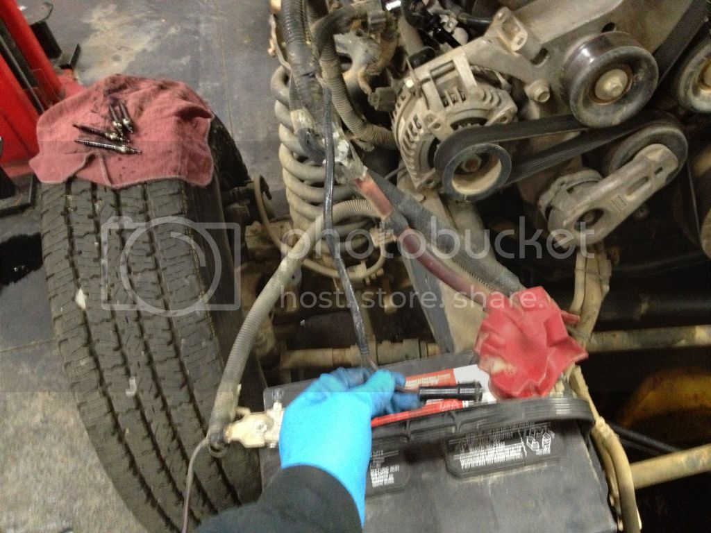

Once you've got the glow plugs pulled, it's time to figure out what you are going to use to actuate the starter. For us 6.4 owners, we have it east. Ford built a lead right into the battery harness. Touch that to hot side of the battery and it's game on. If you're doing this cab on, make sure the ignition is off.
Here's a picture of how I had mine set up today.

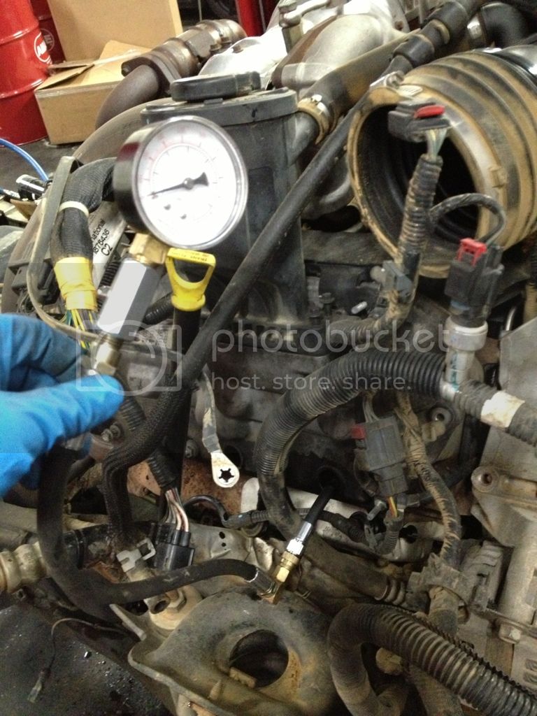

Once that's done, time for the test itself. Thread the compression tester in the glow plug hole finger tight. Make sure you can see the gauge and start cranking the motor over. Let it turn over 5-10 times or until it stops building pressure.
Quick picture of how this one was set up. Not the best pic, but you can see the hose disappear into the valve cover.
