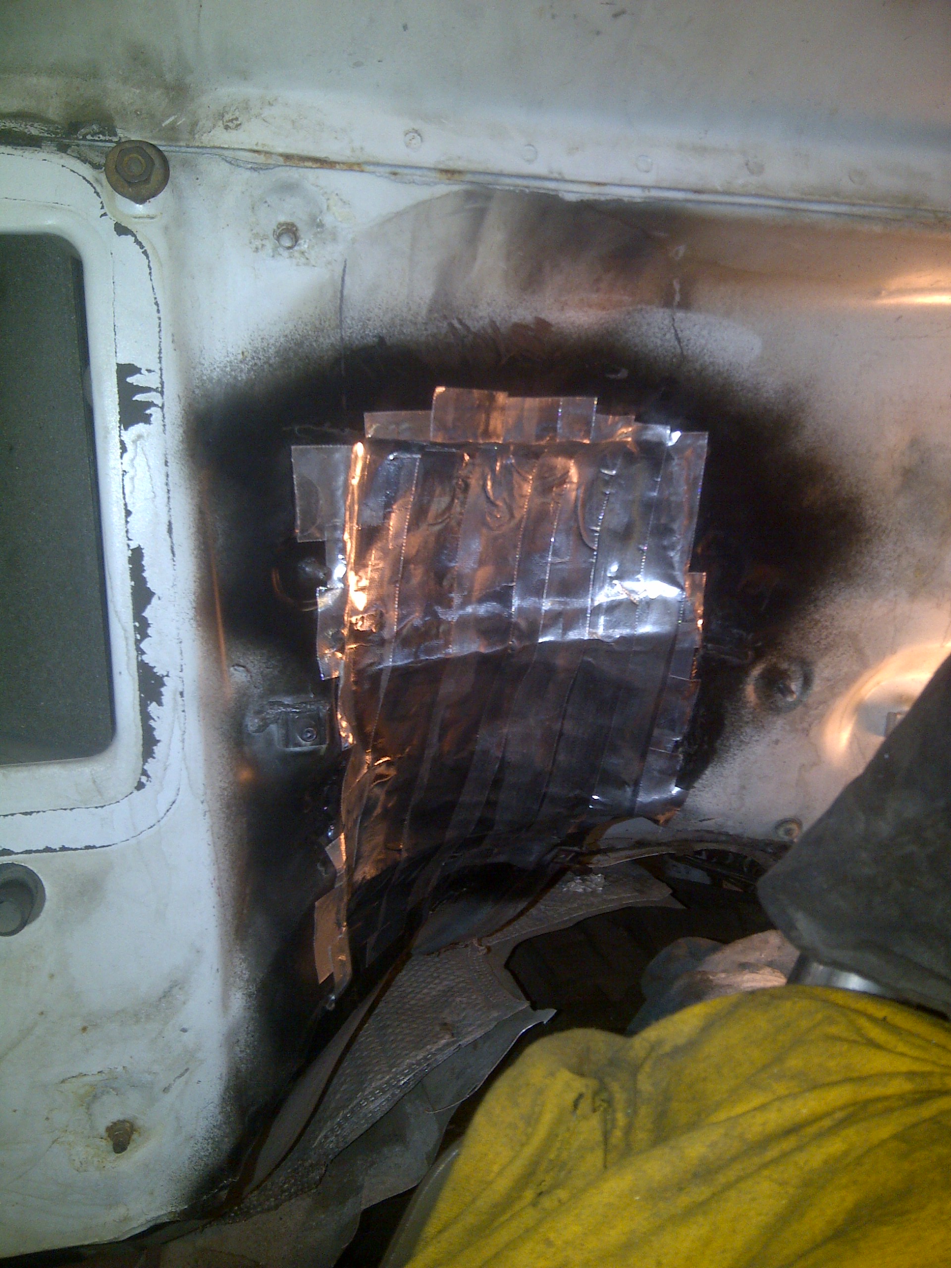

So on my 96 f-250 I installed an Irate T4 kit in 321ss and am going to be running a s475 for pulling. I decided since I had my cab off for body work I wanted to run a true 4" DP.. I mocked up the DP with 4" stove pipe and am glad I did!! lol It was a bit involved with cutting out the firewall bending and patching it back up to fit without rubbing. I put heat reflective tape on the engine side to help stop heat from getting into the cab, also going to wrap the DP. here are some pics and what it took to do..

and the fire wall all patched up and done. you can see how much I had to cut out and bend. Here's my turbo and the flange also.

I can give this word of advise if some wantes to try it, eaither add a 2" body lift or like i did run a plank through the cab to a chain fall and unbolt the front body mount bolts. allows you to tilt that cab back enough to work on...

yes it can be done with cab on from inside... you will have to pull back the carpet and slice the black insulation right by the firewall. it's a lil right of center of cab. best bet would try to get at it from engine side and drill a few tracer holes so ur not completly "blind" your basically cutting out the pinch weld.. make sure to leave at least 1/2 inch all the way around
for the turbo I just had to hit in the firewall right bellow the wiper motor where the race cover hit... other then that lots of room. feel free to ask any ?'s any time..
edit- after looking back at my pic's i dont belive it is possible from just inside the cab.

I put my 4 in" DP in with the cab on. Shoot, it's been 3 yrs ago now an I don't remember the details but I just hacked it out with a sawzall and then semi flattened a piece of 4" exhaust pipe to weld in to cover the hole and give a curve to it. I do have a 2" body lift as well. Makes doin anything engine wise on an obs a lot easier.

it was a PITAzz, but we did it from inside the cab, without tilting it...
you have to cut out the floor as high as you can go, and lose the dash brace, but it's possible....
would I do it again? nope.....
it does cool a bit better, and spools a bit better down low, othern that, no difference....
