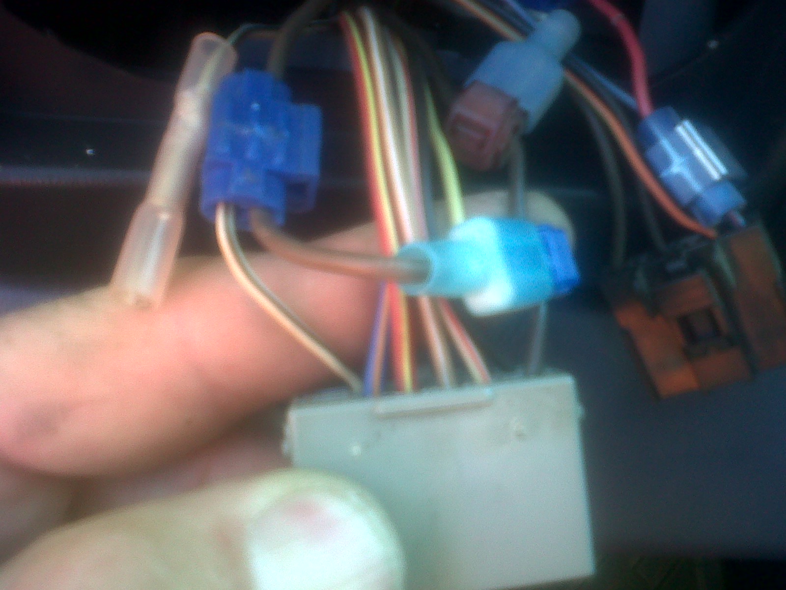

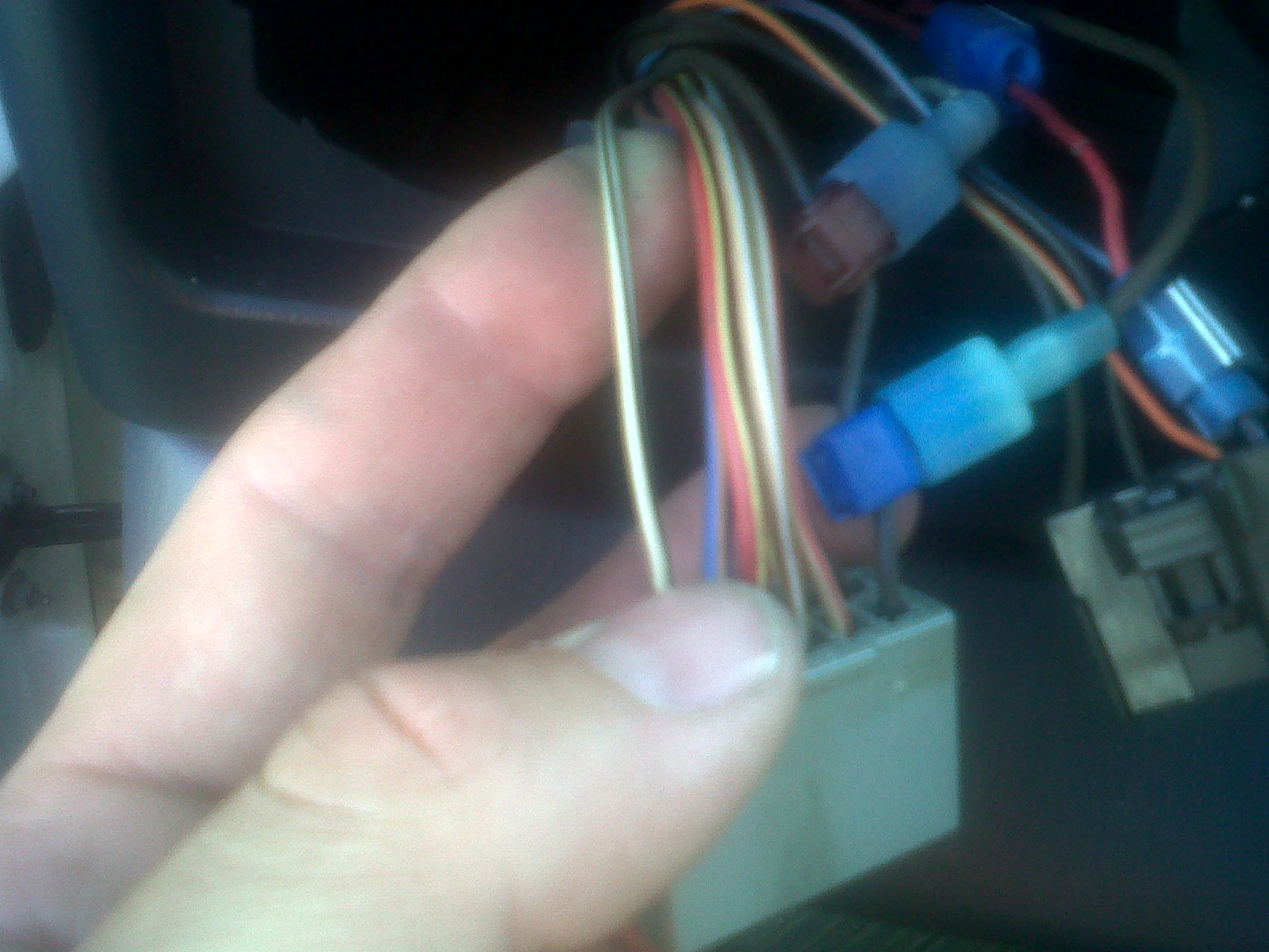

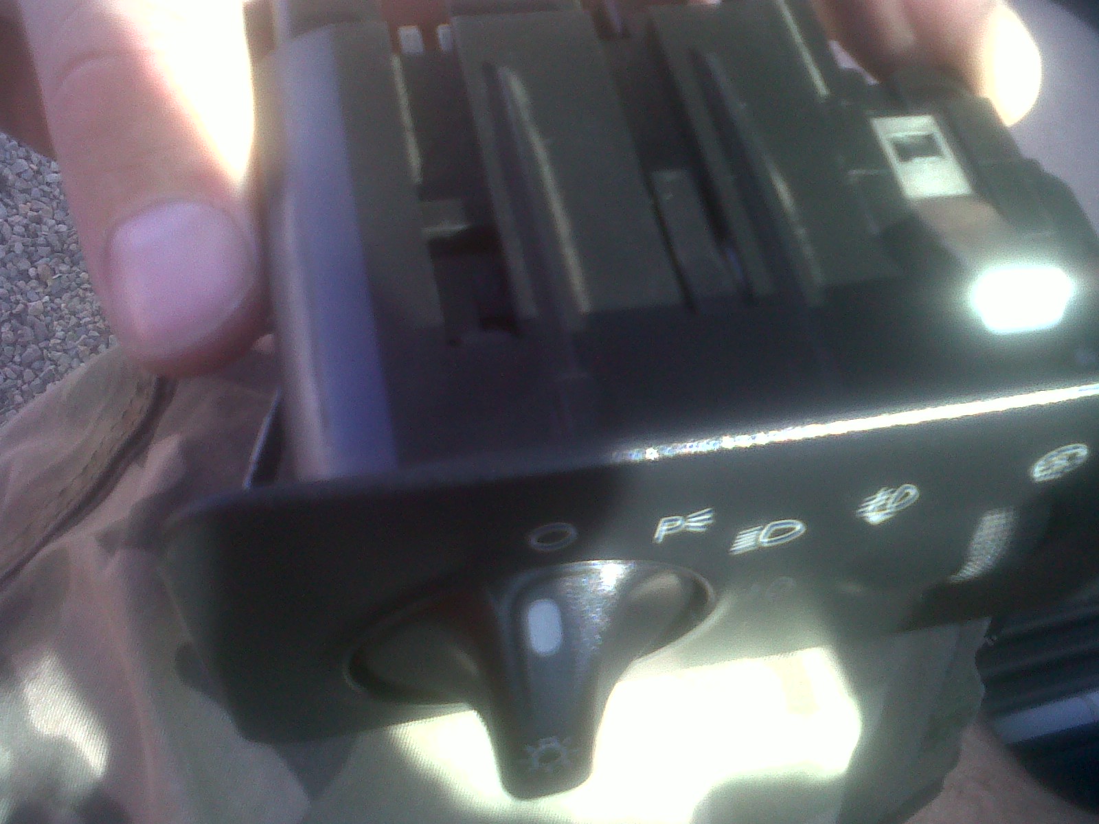

Fog switch upgrade: couple of ways..
2001. Remove the headlight switch plate and unplug the two plugs. Take a drilll bit inside the the switch and remove enogh material so that you can pull the switch out it the parking light possition. Next take the white wire with the black stripe on it and cut it. tape off the end that goes back into the wire harnes under the dash so it will not short out. Take the other end of it that goes into the plug end and tap it into the parking lights, the brown wire. Now you have fog lights when you pull the switch out in the parking light possition and you keep them when you turn on your high beams.

Did this today, 210k and I have wanted to do this the whole time. I did have to cut the switch apart to get in there with a drill. But it was just melted tabs, so I just melted them back when done. Took all of 30 minutes!!!
One question, Factory is there any relay between there and the fog lights? Because it seems to me by tieing into the running light wire I have just added 65W of load to that wire...
True or ???

This was posted elsewhere...

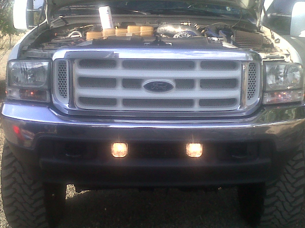

My '02, I just turn it to the auto headlights spot, and pull out. No running or headlights come on, just my fogs. I leave it in this spot all the time, soon as you turn the key, (even with truck off), only the fog lights come on. Is this not what you're talking about?? I know 4-5 other guys who do the same, and from the pic that Joe posted, that looks like what I'm talking about.
But I guess not all trucks have the auto headlight position??
That feature was added in 2002 with the auto headlights, otherwise you are stuck with cutting into the harness like I did to make them work. The other nice thing is now when I turn my high beams on, the fogs stay on too!
