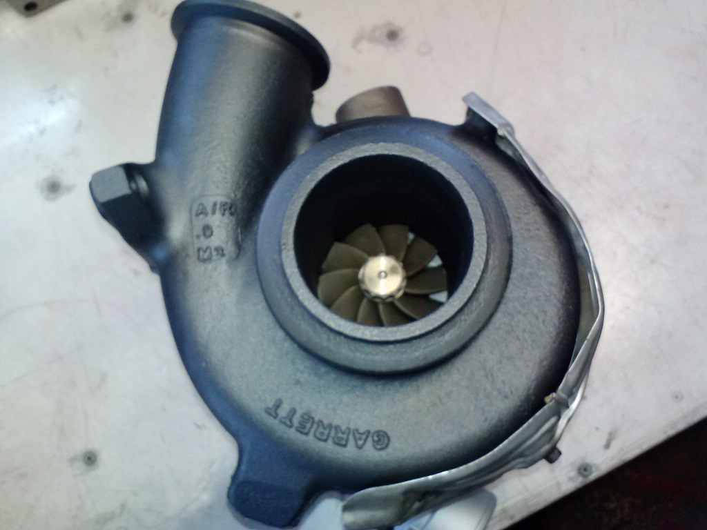

Im getting into modding 6.0L turbos and figured I would let everyone know what options I can do.
Currently, I do not have enough cores, so your turbo will need to be sent in to have the mods done. Normal turnaround time is 3-4 days.
Stage 1 Turbo: 11 blade Billet 63.5mm, 13 blade turbine wheel
Stage 1.5 Turbo: 11 blade Billet 63.5mm, 10 blade turbine wheel
Stage 2 Turbo: 11 blade Billet 64.7mm, 10 blade turbine wheel
Stage 3 Turbo : 6 blade Billet 68mm, 10 blade turbine wheel
Pic of a Stage 2

With you supplying the the turbo to be built,
Stage 1 $950
Stage 1.5 $1150
Stage 2 $1400
Stage 3 $1600
All come with 1 year warranty.

Stock Powermax turbo with 175/75 injectors did 515/820. Changed out compressor wheel only to the billet 11 blade and made 576/882
61hp increase and 62 ft/lbs
That is the 63.5mm compressor wheel or the stage 1.5 turbo.

Also to add, the Stage 3 turbo must be built from a new Powermax, so the cost on a stage 3 will be $1975 no core needed.
Also working on a stage 4 with 68mm compressor and 70mm gt40 turbine. Have to do some testing before available

I dont know what RC is doing, but I am doing full rebuild w/ 360 thrust and assembly balance, billet 68mm cw and 66 or 70mm turbine wheel, starting from a new Garrett Powermax for the "stage 4" I am working on
