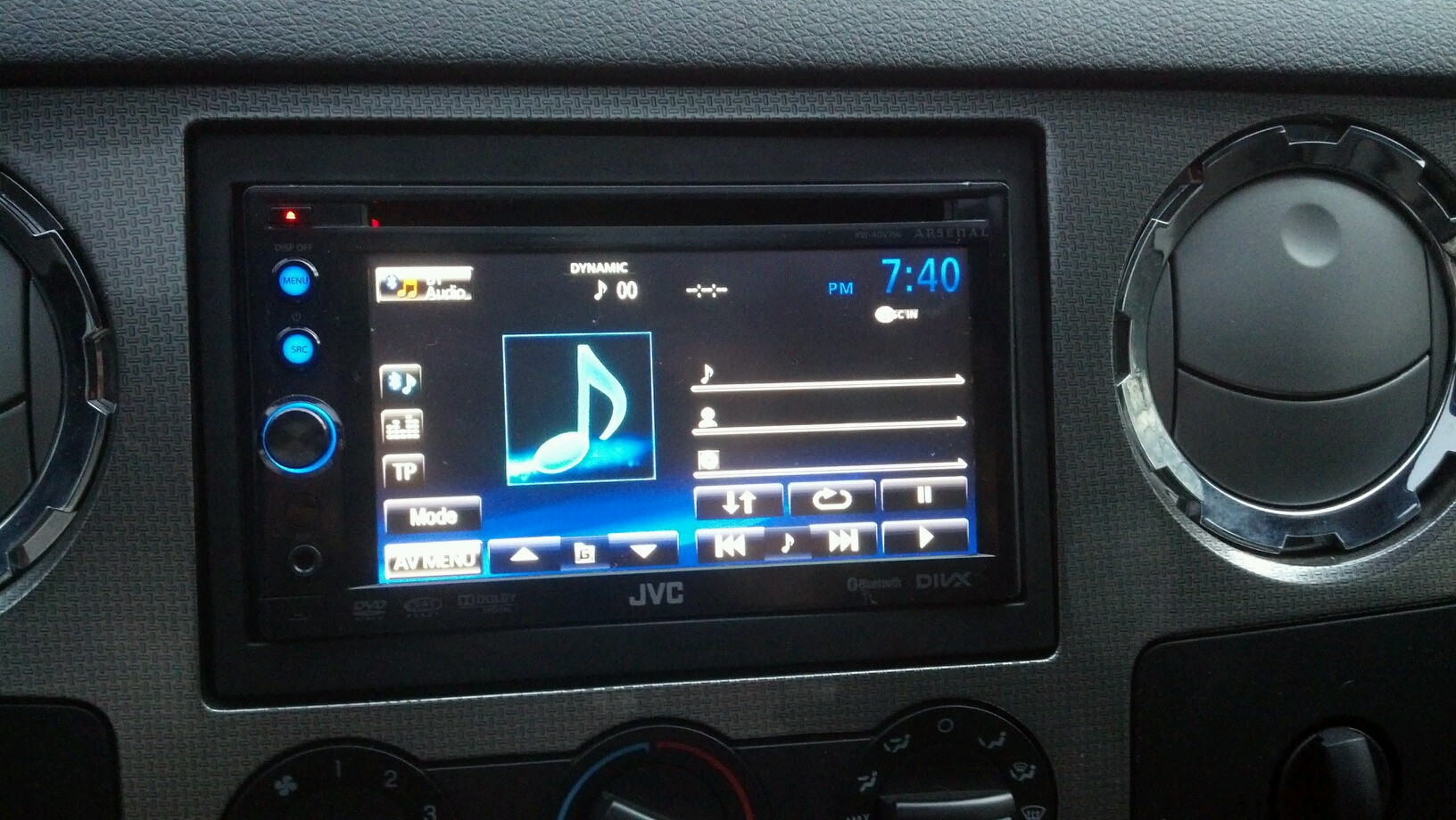

A JVC Arsenal KW-ADV794 Double Din w/Bluetooth.

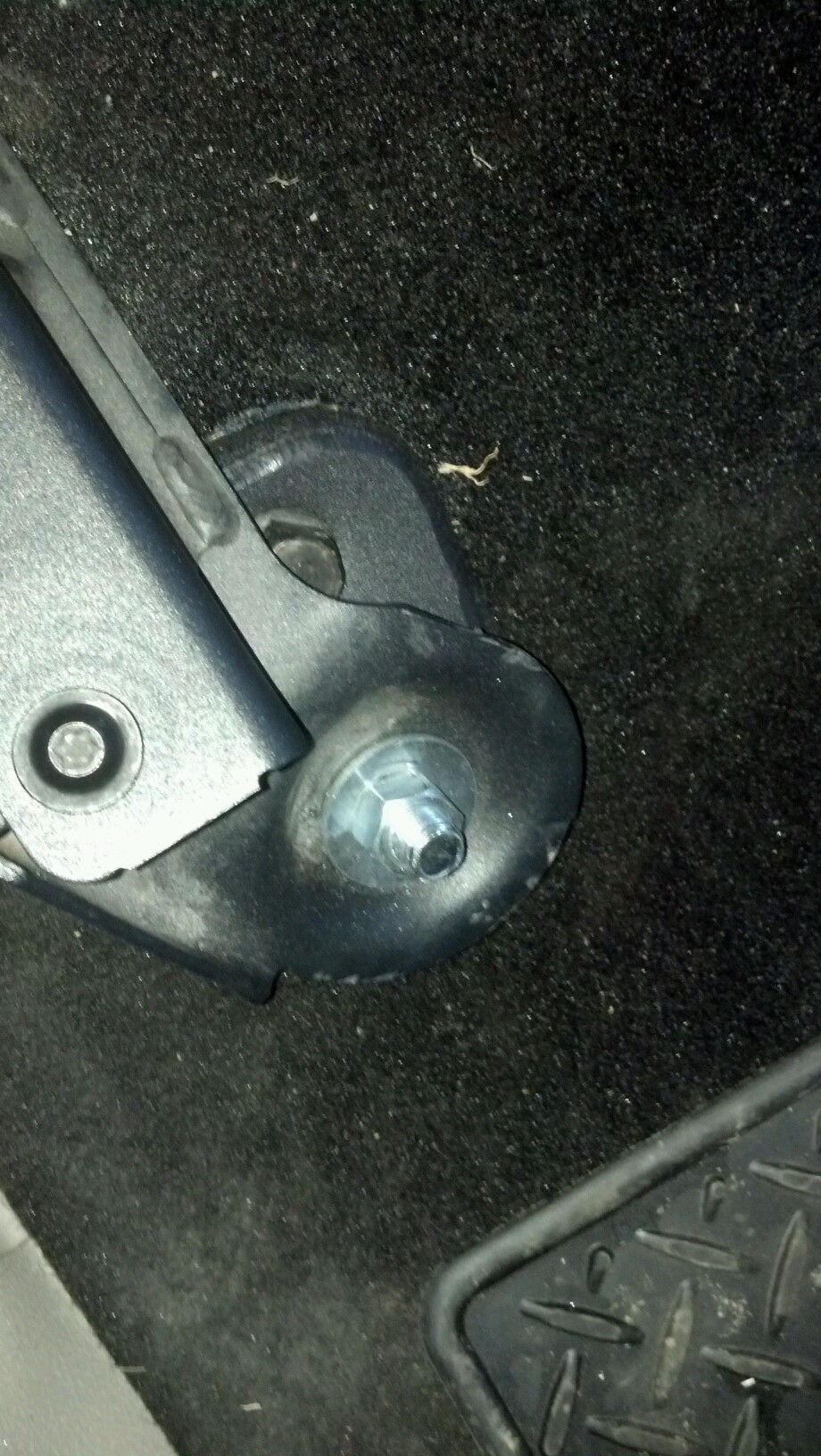

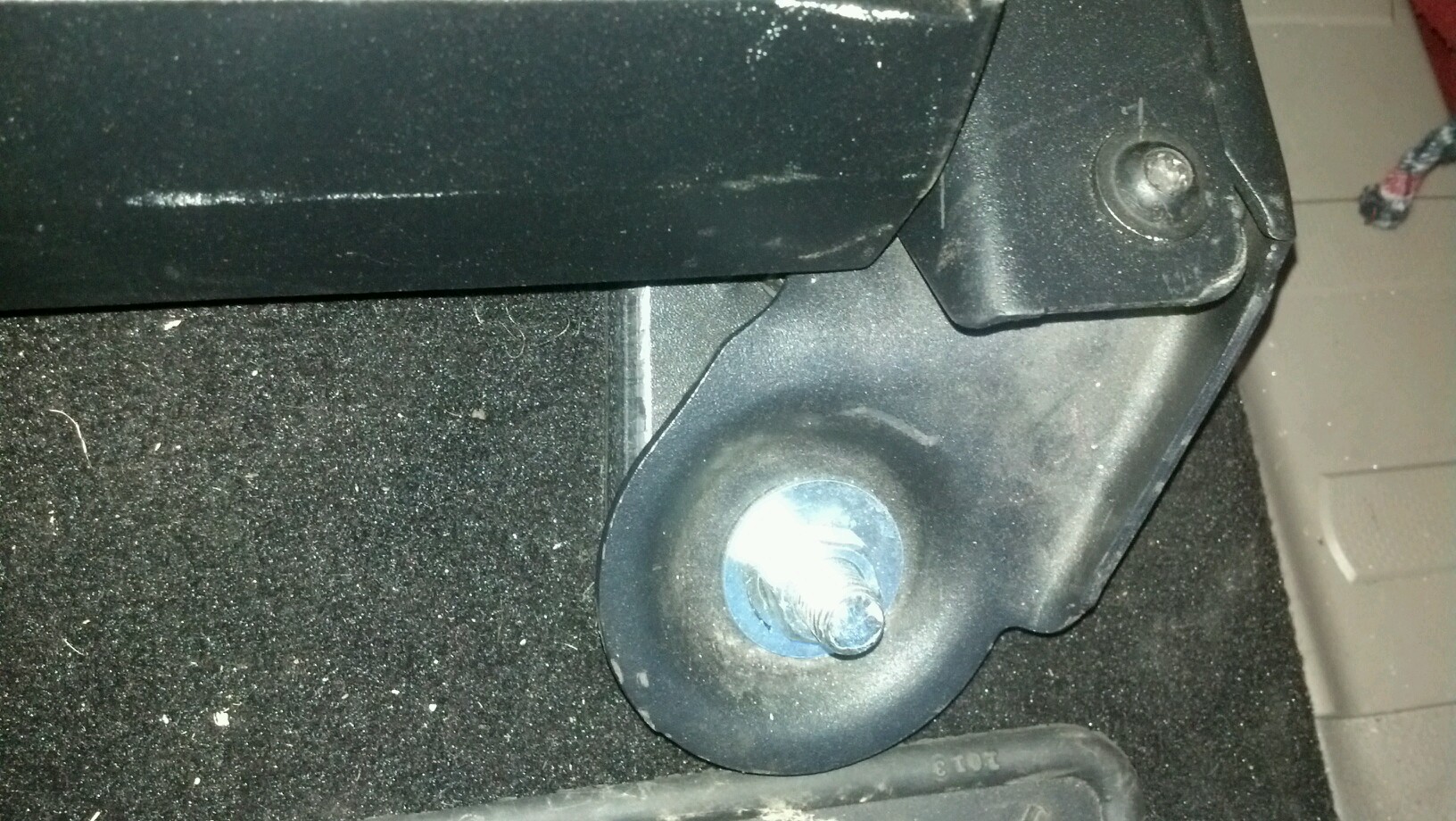

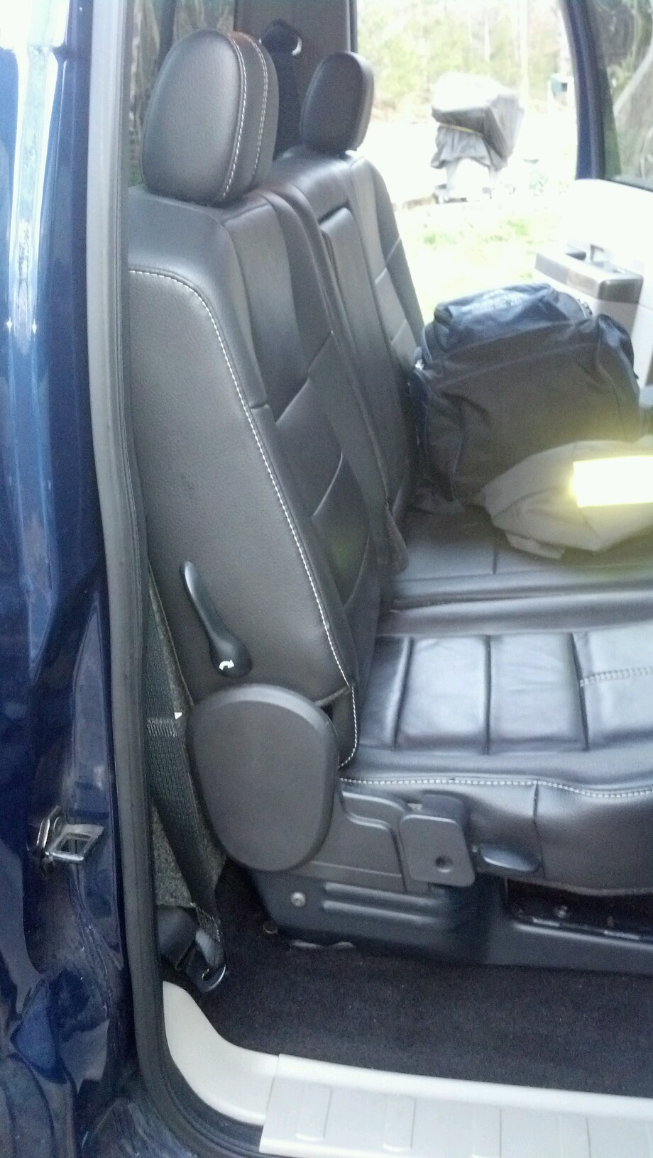

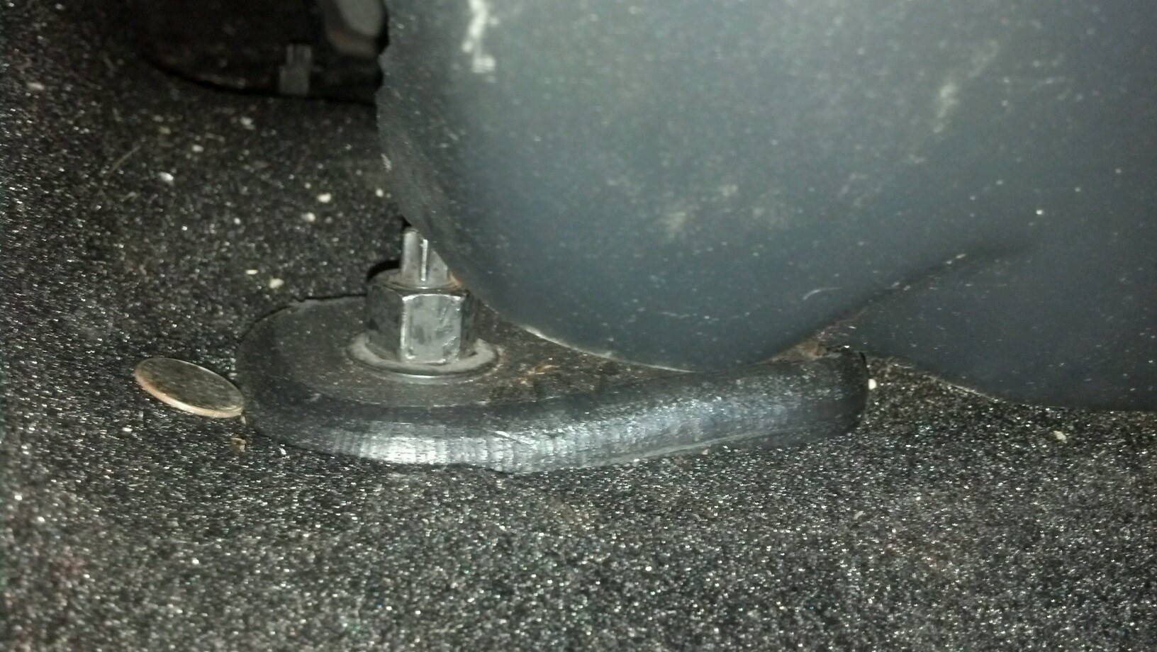

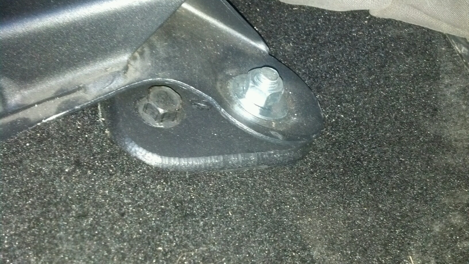

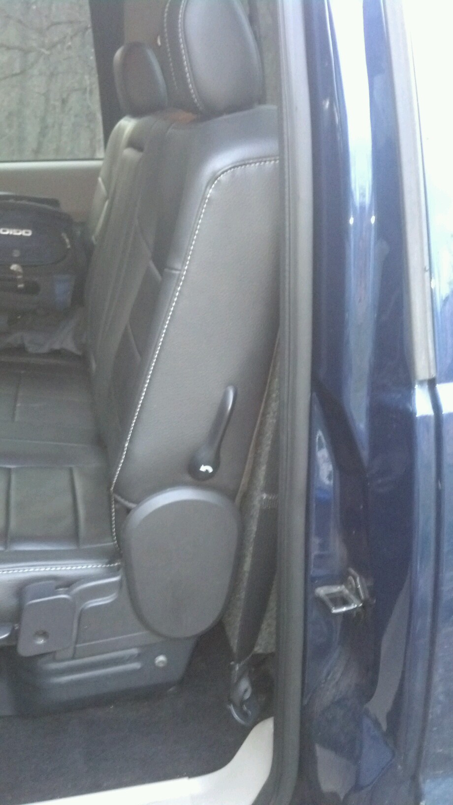

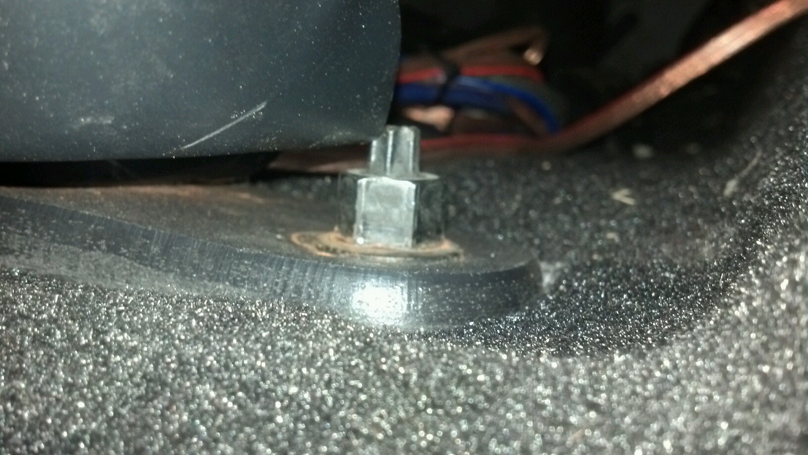

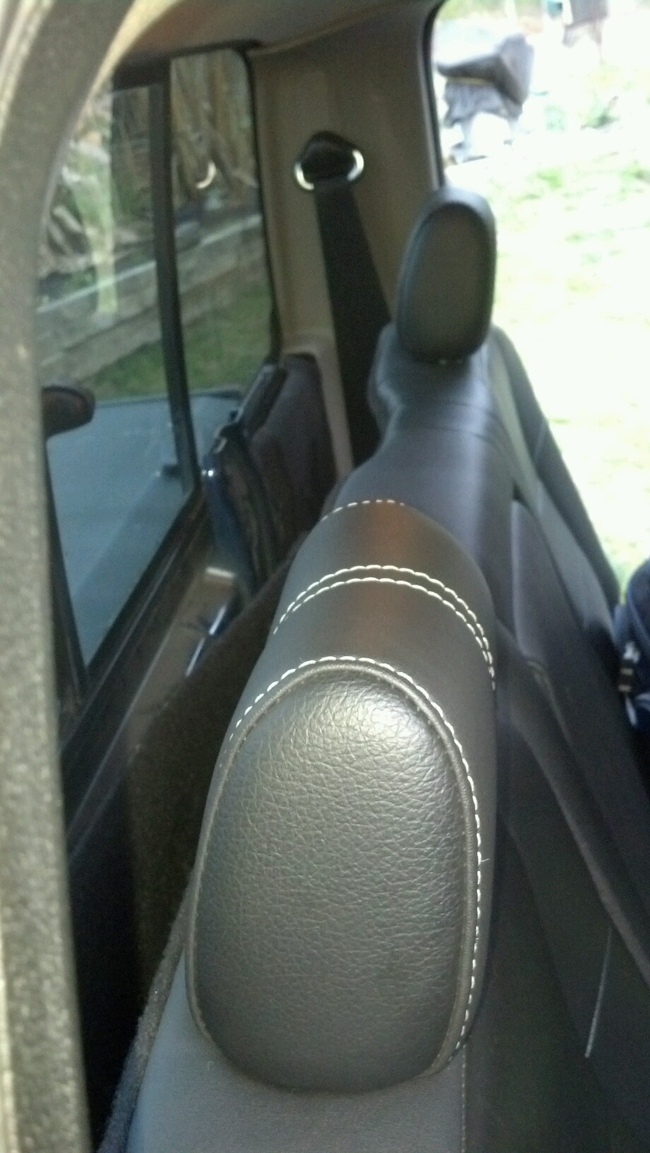

So here goes. I looked for ways to move my seat and I come up with this place called -Underground Audio Styling- That works out of Florida. They made Brackets for 08, 09, and 10 trucks that moved the Rear seat forward up to 2 inches! I called them up and they told my they make them per order and they were a $100 shipped plus tax. So it was around $109. I placed my order and received them 4 days later. Turns out they just hard plastic about 3/4 inch thick with holes drilled in them with rounded edges. In my opinion, not worth $100, but ehhhh already bought them.
They didnt come with bolts and nuts so I stopped by my local hardware store and got 6 bolts, I think 3/8s, 6 washers and 6 nuts.
I took out the rack under the rear seat. Next I put them in my truck, and let me tell you, what a pain in the BUTT! took a little over an hour by myself. Would go by so much quicker with 2 sets of hands. I used the original bolts and nuts to mount the brackets to the original holes and stuck the bolts threw the bottom of the brackets and slid the seats on them, bolted them down, and boom, done. It looked good and there was plenty of room behind the seats!

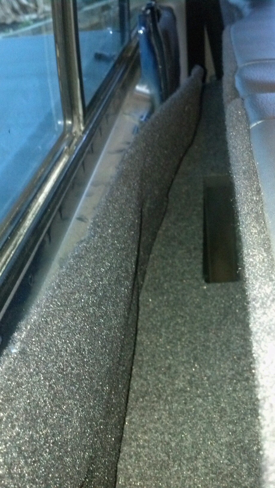

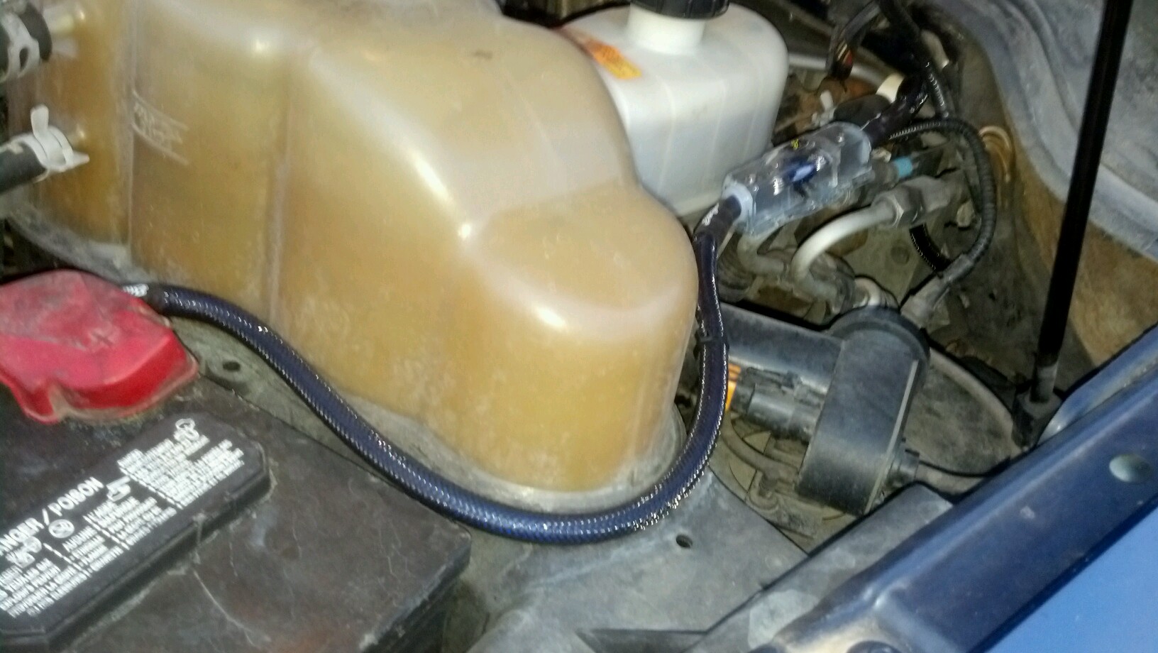

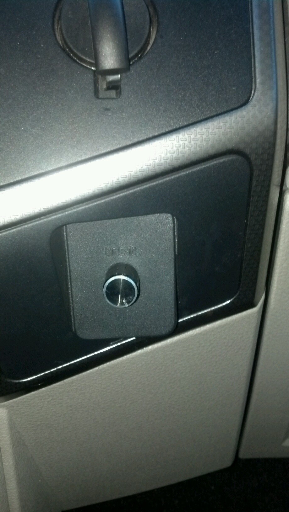

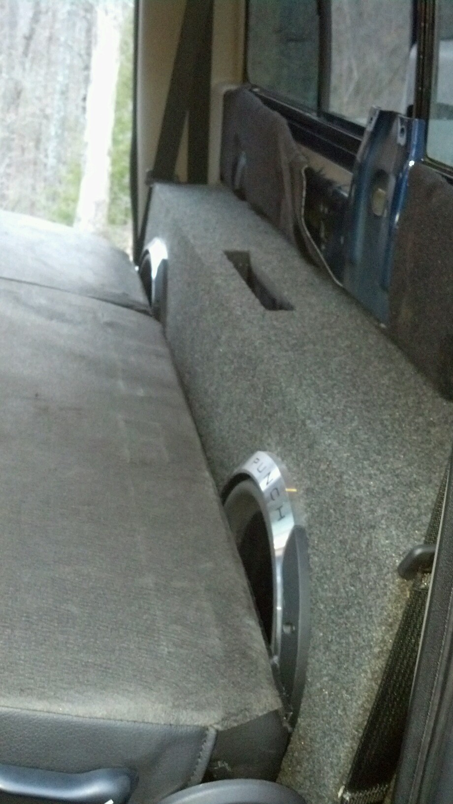

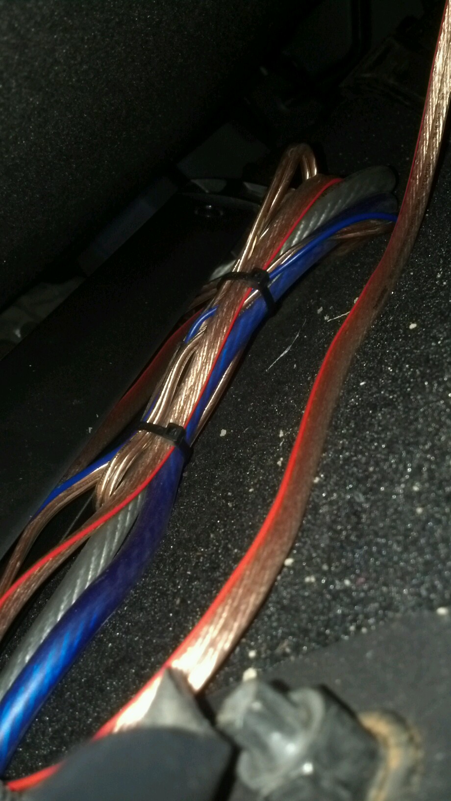

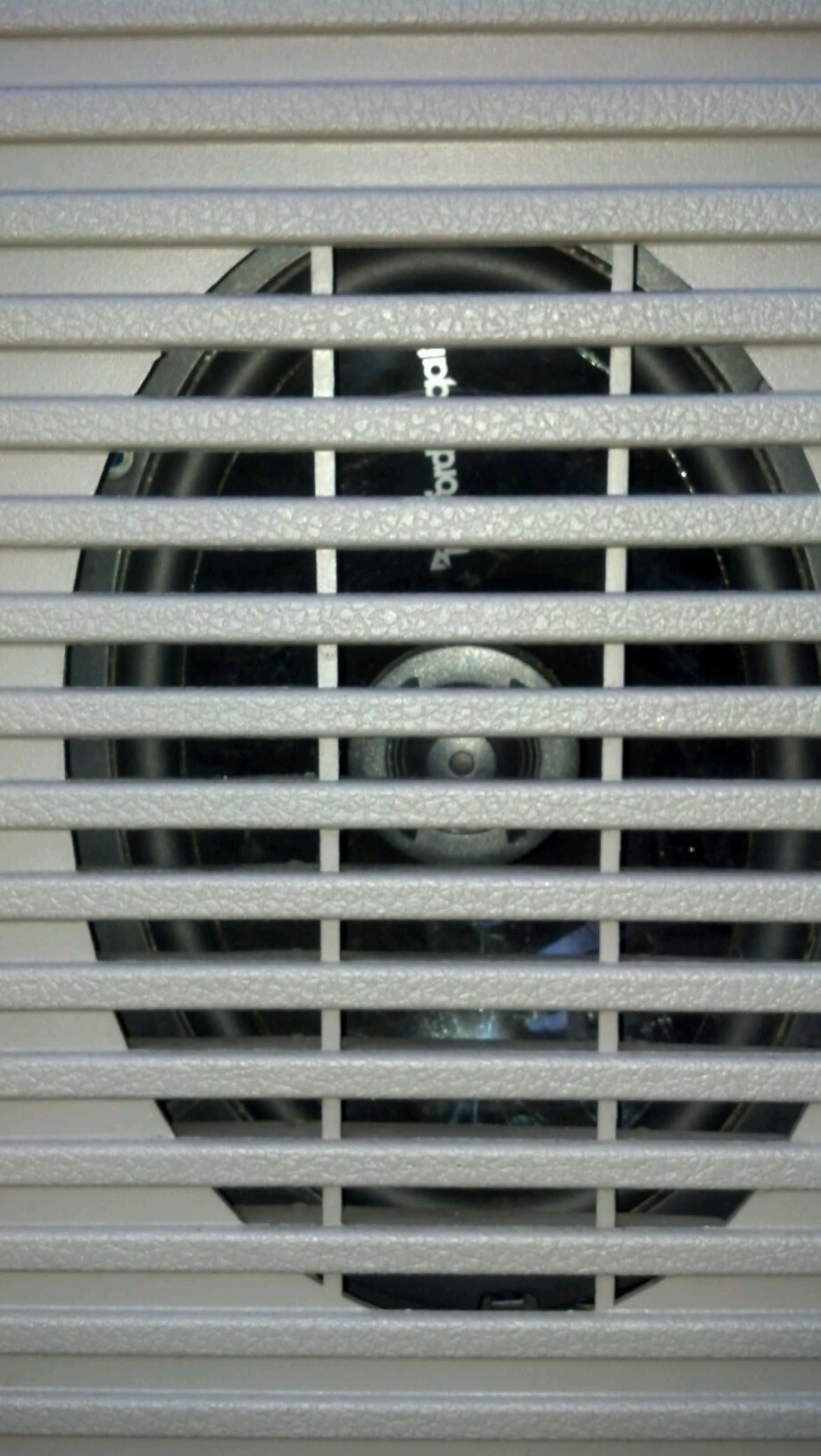

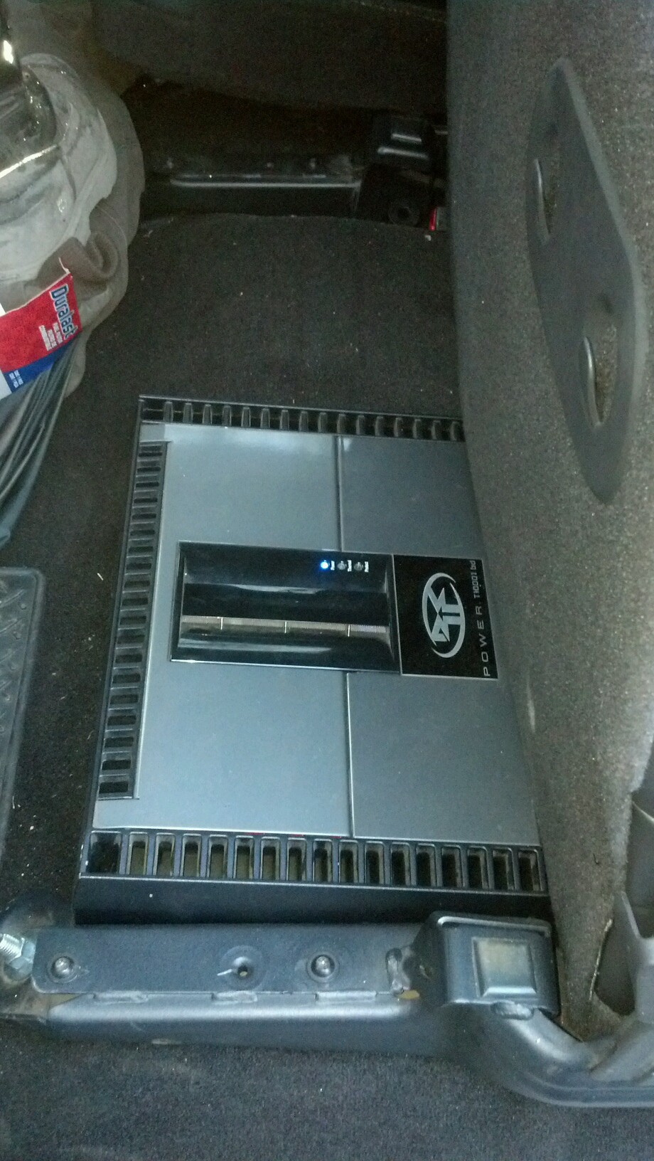

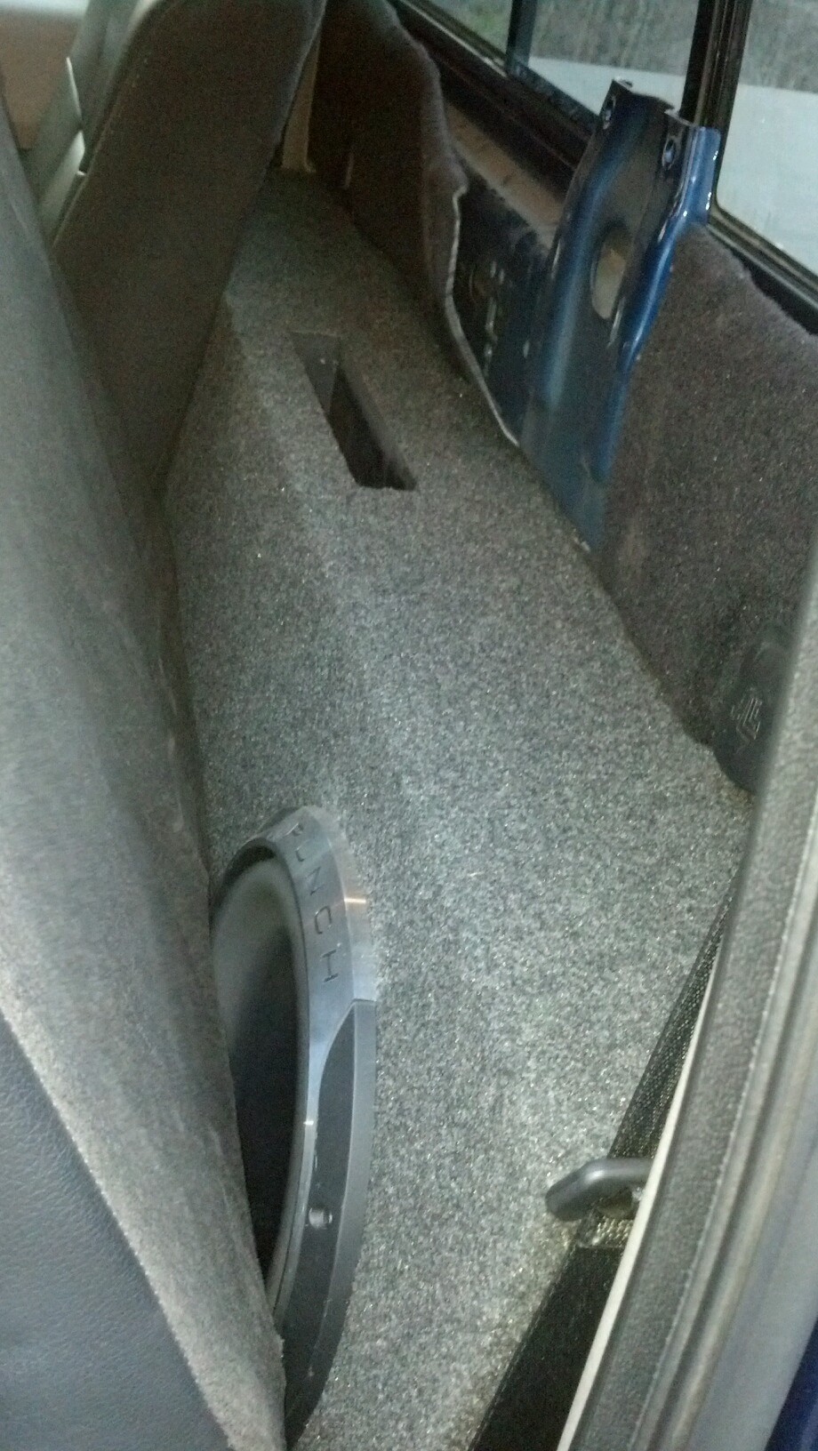

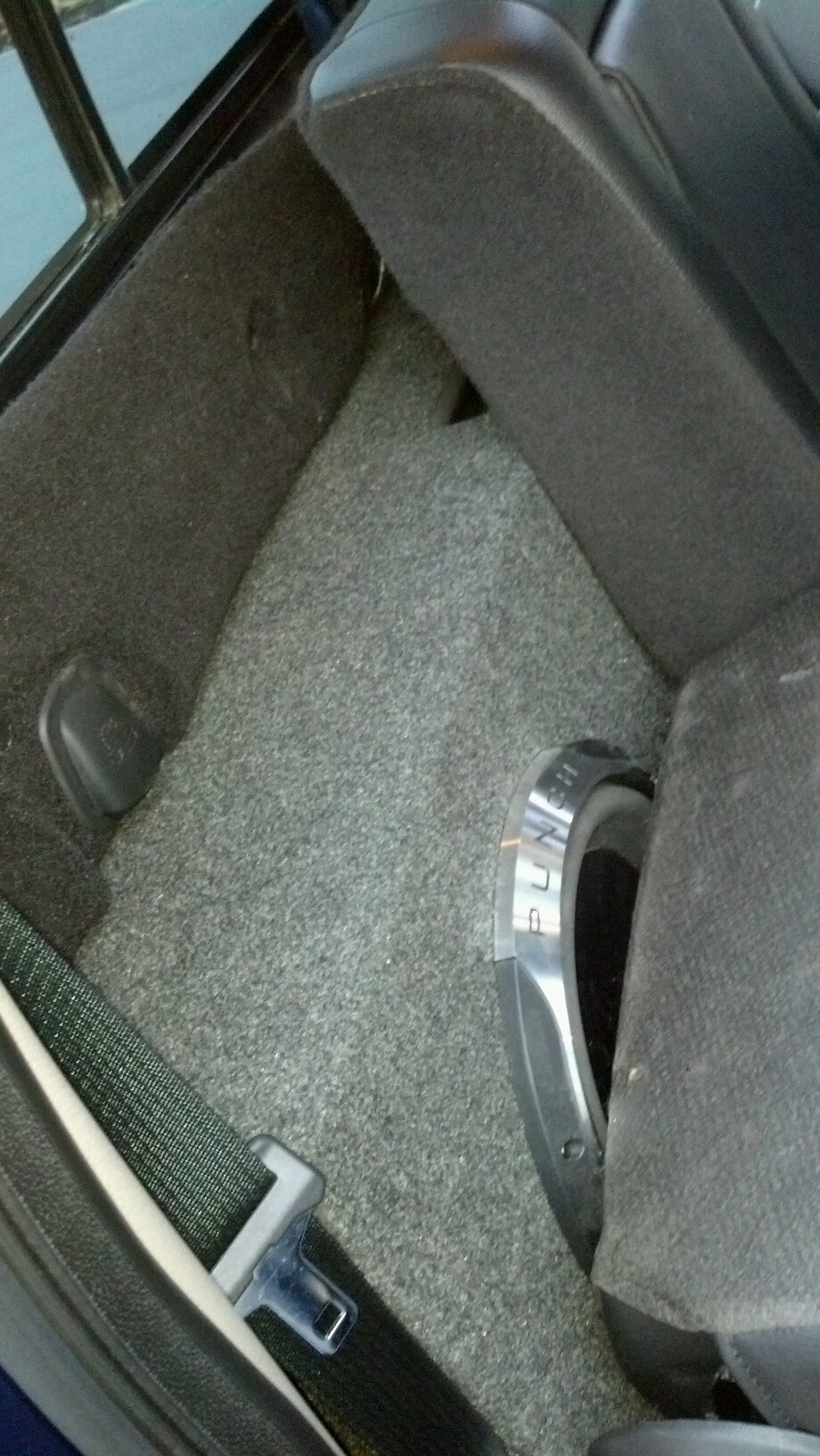

Now it was time for the Install. I took my JVC, Speakers, P3s and Amp to the audio place - American Audio in Knoxville TN - dropped off my truck and 10 hours, yes 10 hours later, I got my tuck back with an amazing sound system in it. Sadly I didnt get any pictures of the actual install but I got these tips from the audio place. They Built the ported box all made of wood, and crammed it behind the backseat. Just a little over 4 cubic feet in the box. They had to take the rear middle seat belt bracket out to get the most out of the area. We had talked about it before and I was okay with it. NO cutting was done to the back carpet. The subs seem tight and flush up against the seat but there is a ring around them keeping them off the seat and about half the sub is open below the seat so they can breath really well. The huge amp is mounted under the driver rear seat with all the wires tucked and hid. There is only a few wires I could find, and believe me, I looked. Since I didnt want 1000 watts hitting me in the head all the time I had a Bass Equalizer Knob installed where the factory Imput Line was. Its really nice because I can dictate how much bass I want from the from seat of my truck and it Looks factory! With the box behind the seat it still looks almost factory with the rear doors open. You can barely see the box back there. There is no sign of a system in the truck unless you look for it.

I know this is an older post but can you provide dimensions on the box? Mainly on the width on top and bottom. how does it sound? Thanks
JrStroker
Apr 10, 2013
1,899
Ahead of the competition
The box is 7.5 inches wide at top and 10 inches wide at bottom. Its 58 inches long and 16.5 inches high.
Its got a port in the middle that's 12 inches long and 2 inches wide.
The sound is great. Its struggles with the deep deep notes because it doesn't have enough air space to for the P3s to move. They need about 6 cu/ft and its got around 4 cu/ft. But over all. Great great box.
