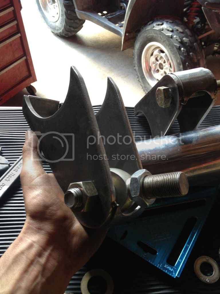

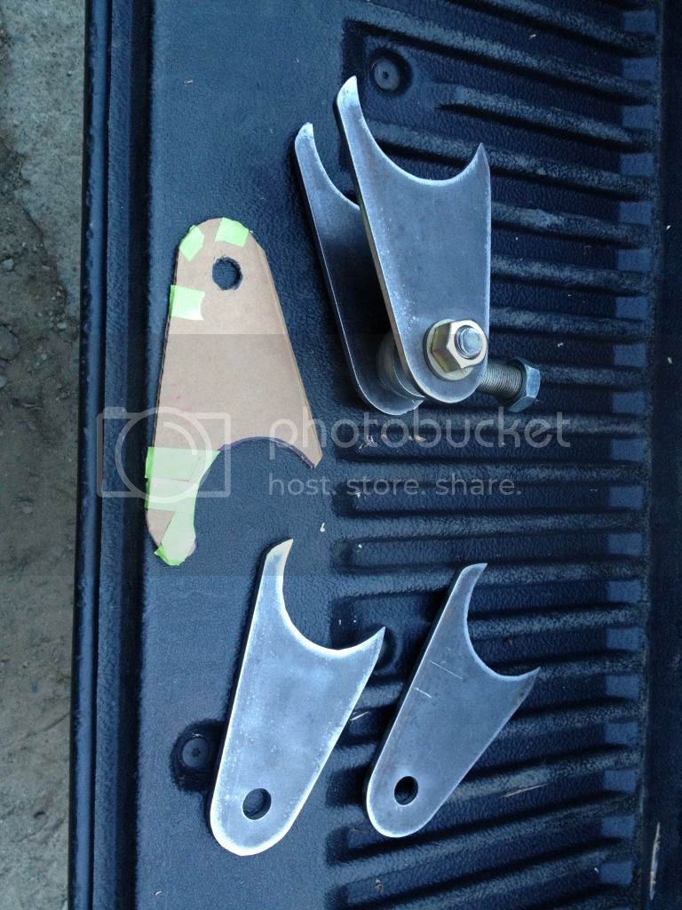

Started building my traction bars today after school. I got the rear mounts started and should have the rest of my heims Thursday I'm hoping. I will update as I get more done rear mounts should be about done tmrw afternoon. Here's a few pics mounts are 1/4".

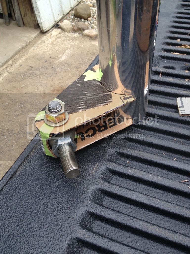

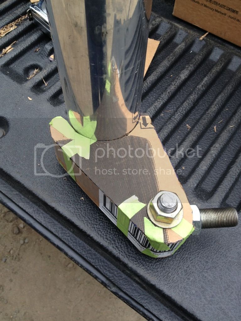

Templates cut out and 3.5" tube for axle mockup.
No fancy tools used here just a drill press plasma and grinder.

I like the brackets. I'm more a poly bushing fan over spherical rod ends. Leaf springs do not allow the axle to travel in an arc, and the rod ends have no give. Suspension will bind during axle travel.

yep... but its better than nothing at all.

Ill be using bushings on the frame end to allow give and isolate road noise/vibration.

Rear mounts are all tac welded. Hoping to see my bushings tmrw and get started on the frame mounts.
