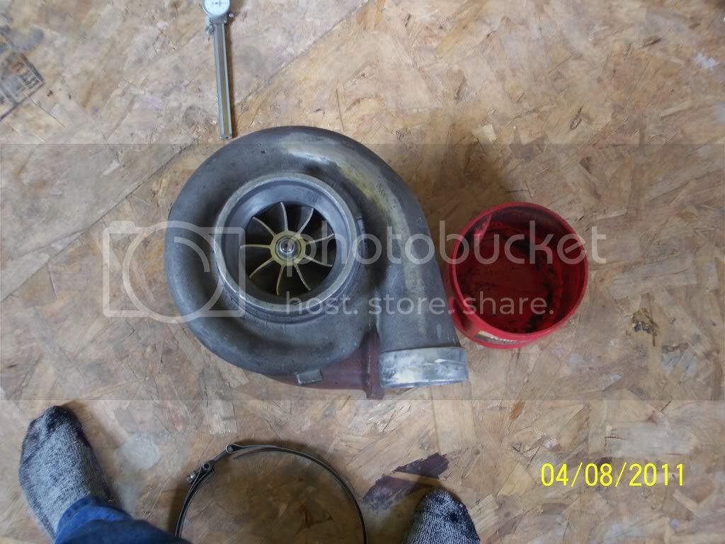

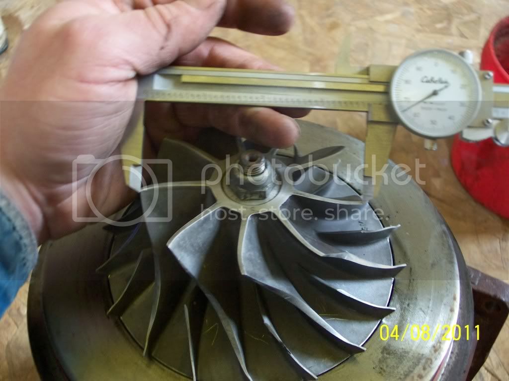

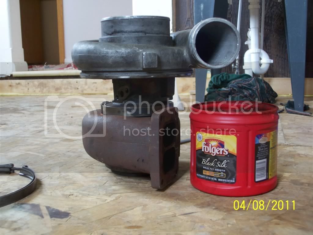

stock turbos in the valley, with a big atmospheric turbo mounted off to the side in one fender, probably spool retarded fast, make good power, just have to double gate it i bet... who's gunna try it?

That being said the total mass air flow is determined by the atmospheric turbo anyway, so put a 88mm gt47 out front, two 44mm gates, let it eat... kinda wish i would have tried it honestly.
Piping would have kinda been a bastard, mostly on the hot pipe, but the inlet pipe from the big turbo to the stockers would have been easy because the inlet is already 3 inch, easy hose connection, little extra piping would be required compared to a big twin set up where everything must be fabricated
