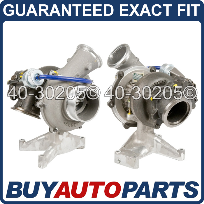

The turbo is different. I have one from when I stuck a t444e in my truck. Its goofy. Superduty collector, obs compressor housing, and a nonwastegated turbine housing.

Is the turbo yall are reffering to called a garret 37 of some sort. We have a f750 at work with a t444e, and it looks totally different than any 7.3 turbo ive seen. I used to have a pic of it
