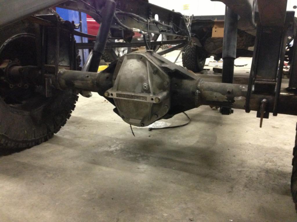

Dana 80 37 spline, spool
300m axles, ultimate 80 cover

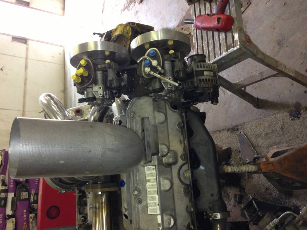

Running dual k16 with our custom mount
Ported rails
Our ported heads
Colt billet stage 2 cam
Custom ported intake
Custom turbo mount for single

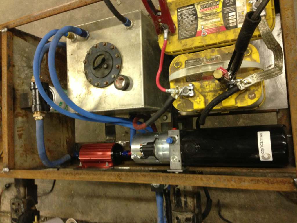

Custom fuel cell in weight box
A1000 pump with all custom fuel system

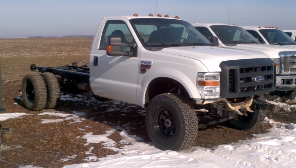

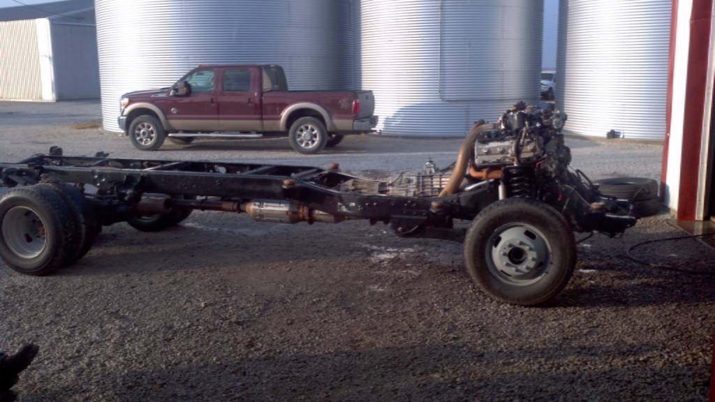

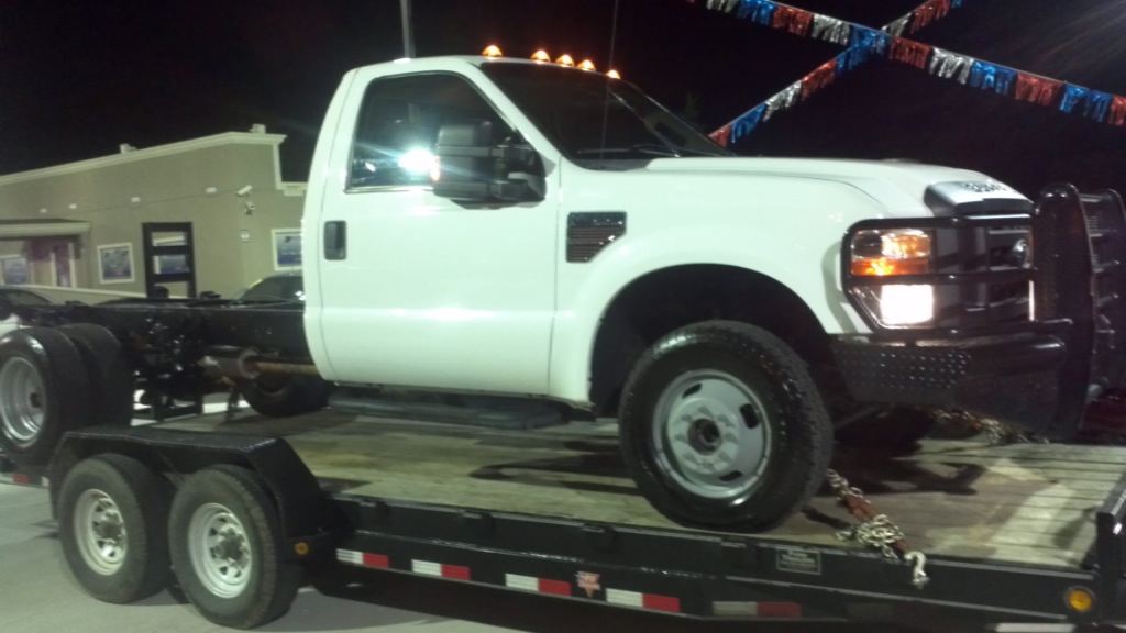

Here she is when I drove to Oklahoma City to pick it up. That trip cost me an engine when my tow rig scattered rods on the interstate halfway there about 6 hour from home. But that's a whole nother story.

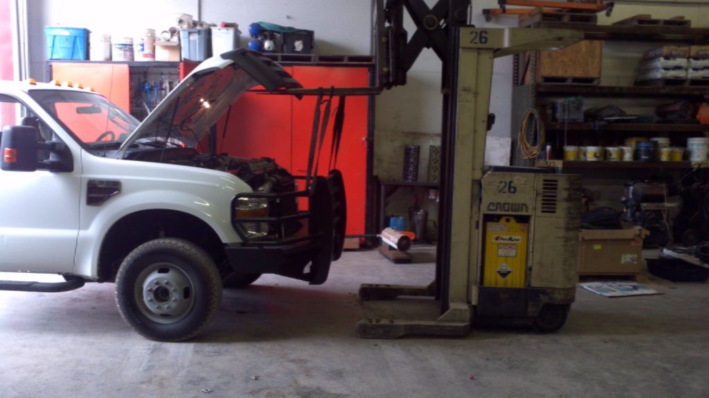

First order of business was losing the bumper

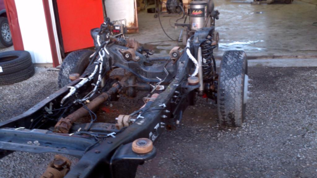

And commence to stripping a truck that I just purchased and was a perfect runner down to nothing!

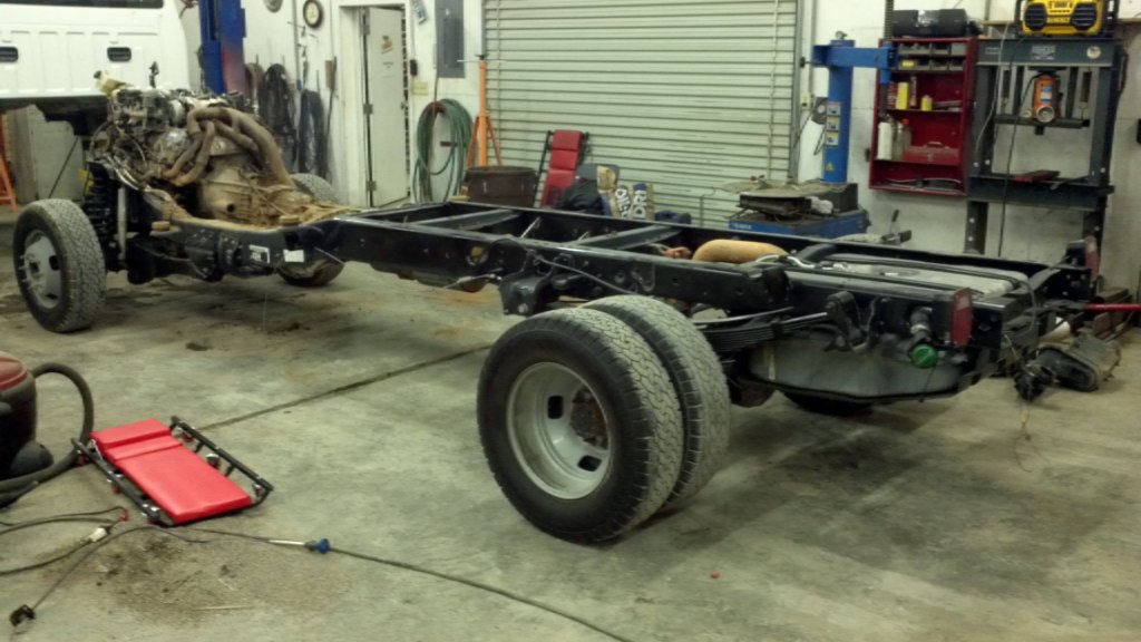

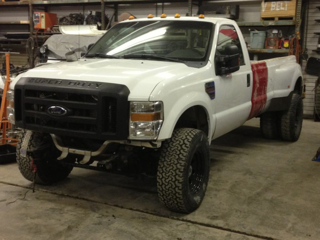

And there it sets gutted waiting five months to get a spot back in the shop for some love (hence why i didn't start a build thread then). Although it got some tires more for for pulling.

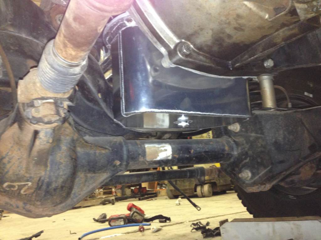

Lots of busy work kept me from doing a whole lot for a while.
You'll understand this pic when you see a later one.

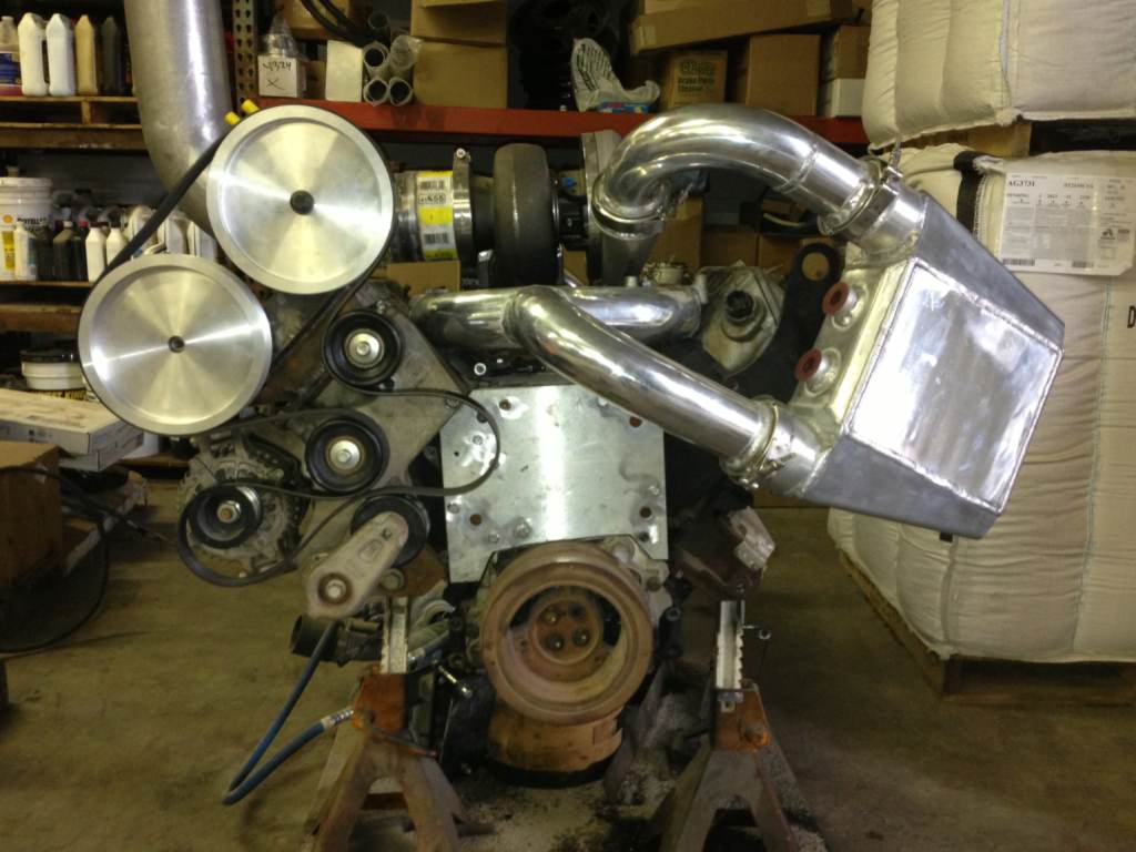

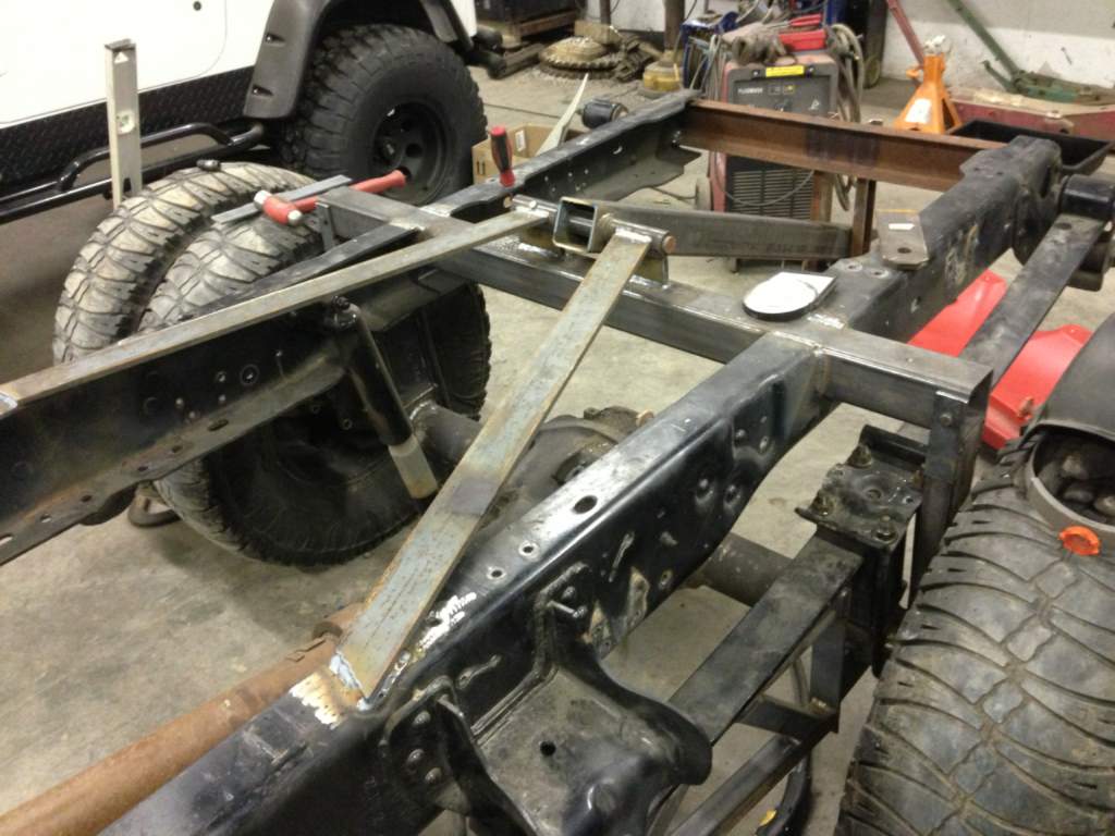

Some mock up work
And more ........

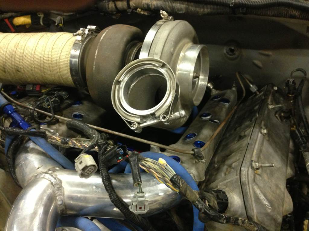

You may notice a recurring theme of things never attempted before on a 6.4
Like those and this

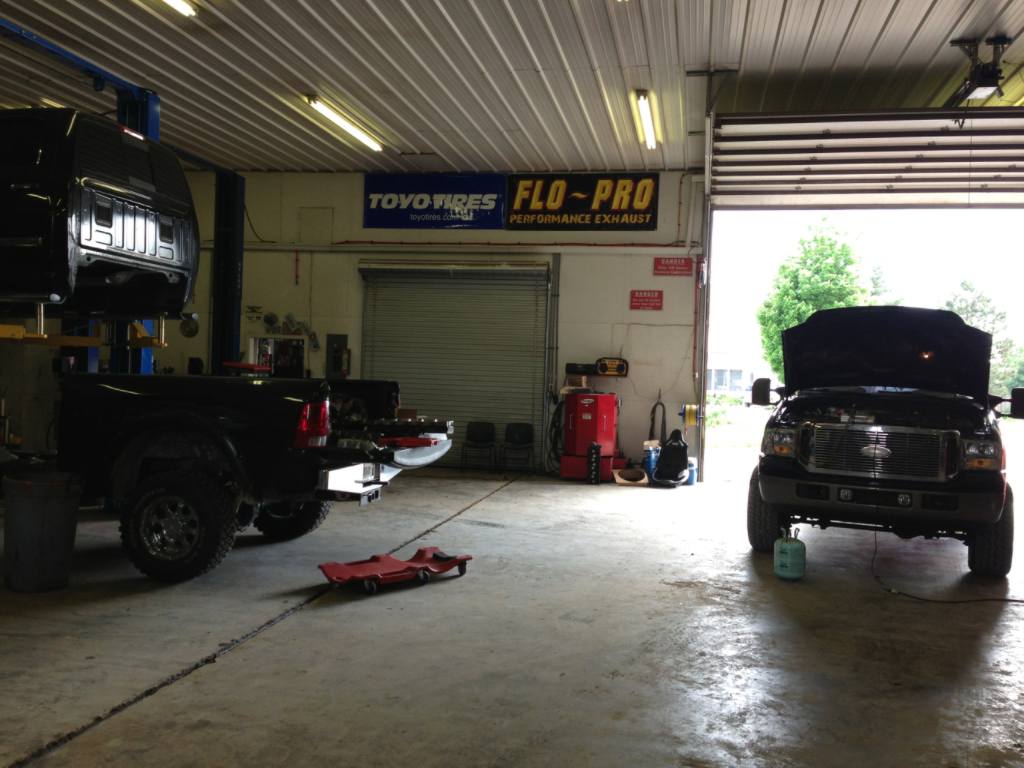

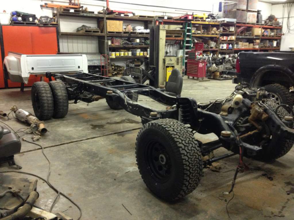

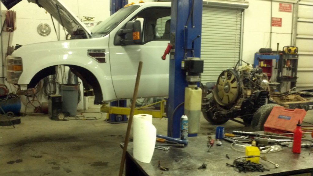

Time to get some room in the shop for pull truck work

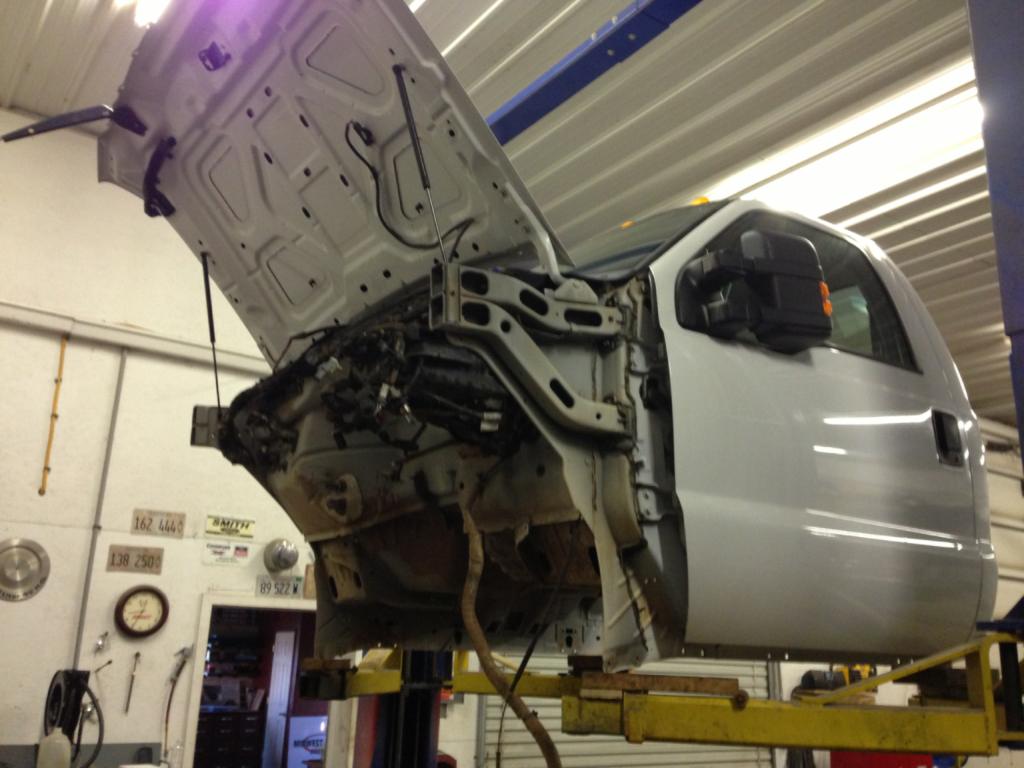

More stripping. Everything that's not important is unbolted, pried, beat or cut off!

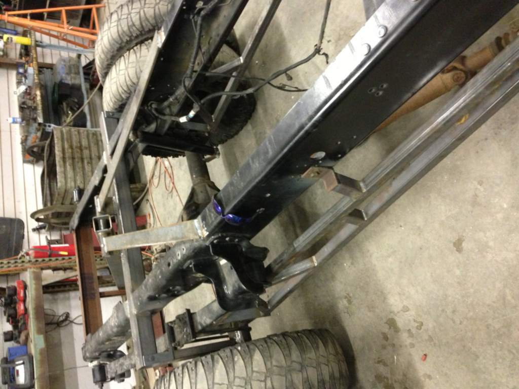

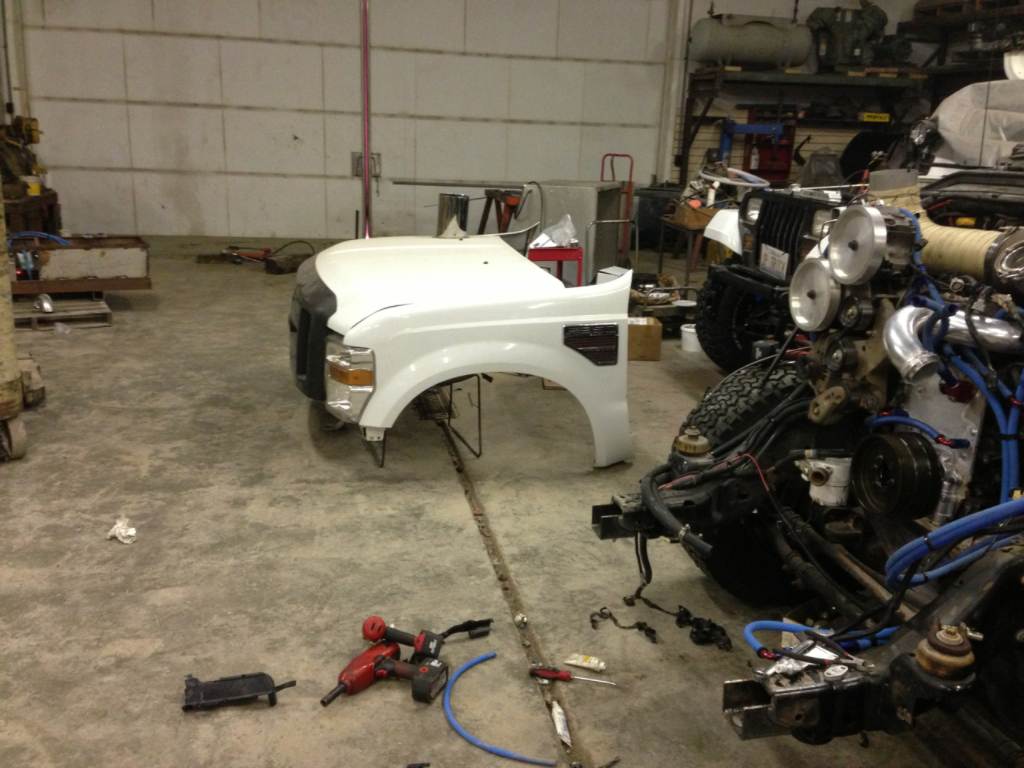

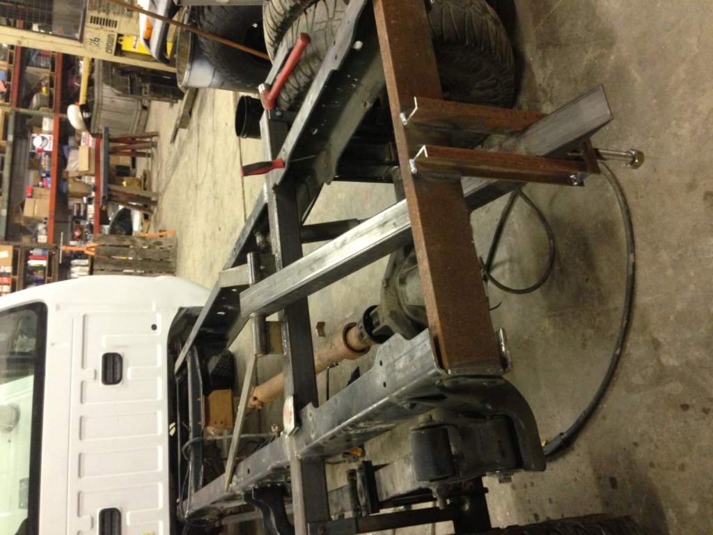

Removable front clip in the making
That should make the above picture clearer.
Looking like something now!

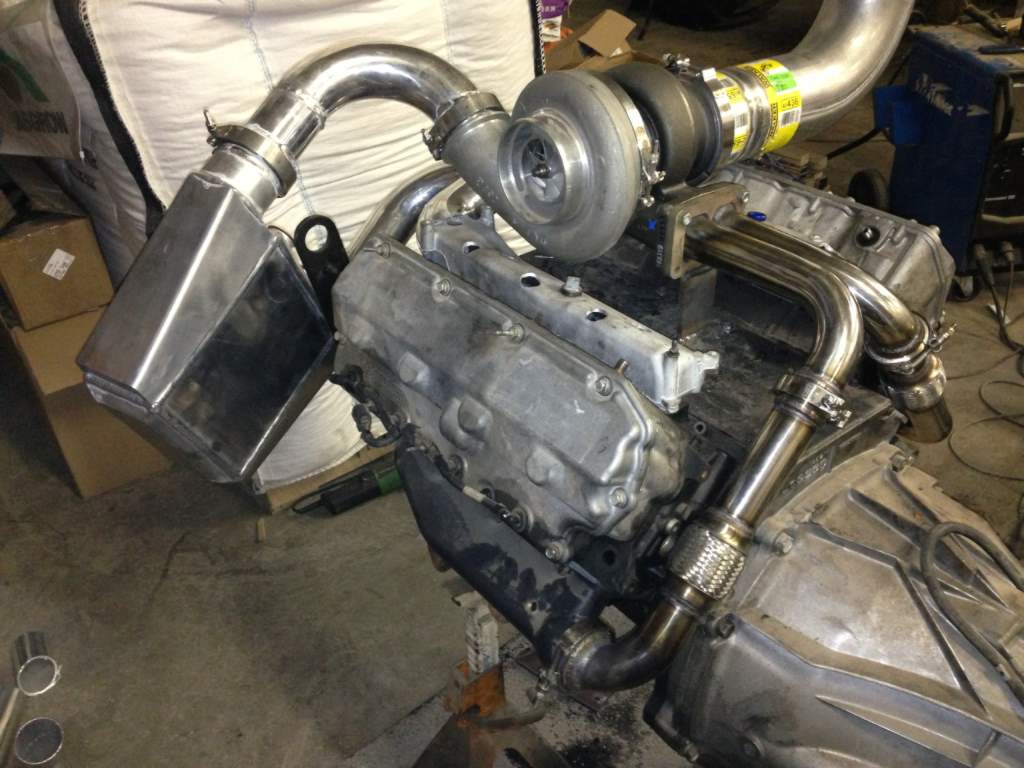

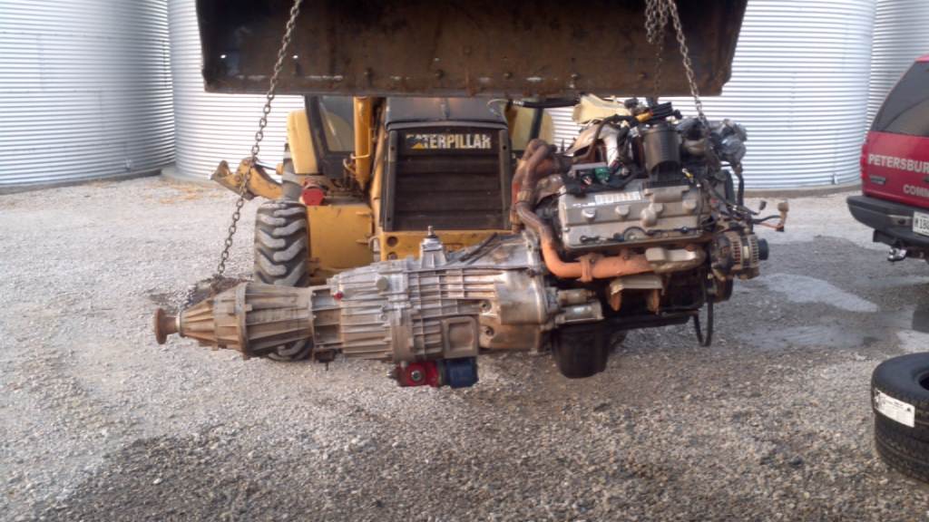

In the last week we built the new engine, pulled the mockup engine (the one you have seen in the pics so far) are in process of installing the built engine and working out all the custom bugs. Hopefully a startup vid in the next few days!

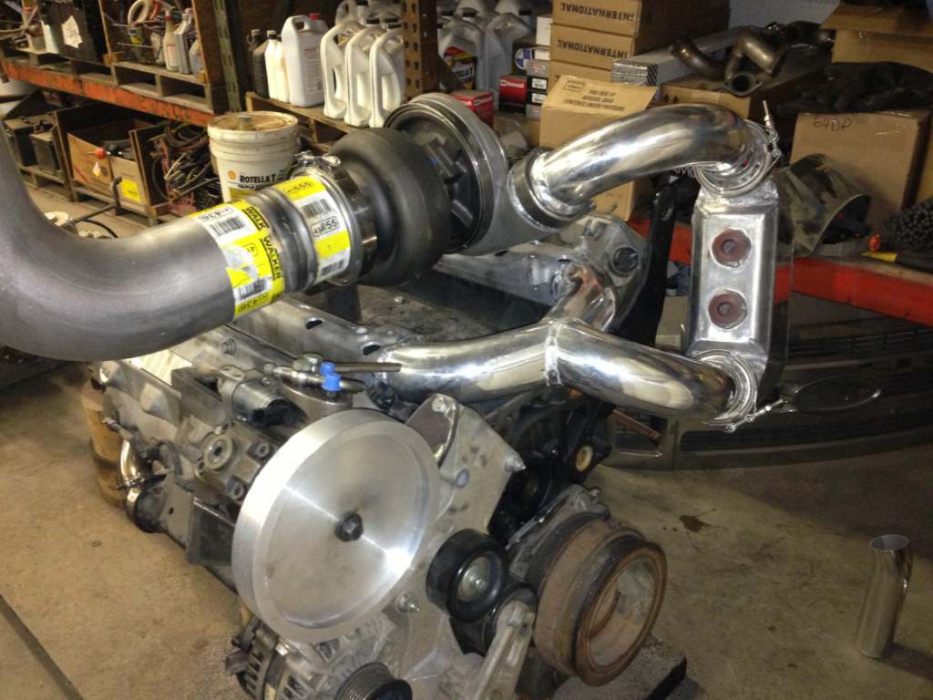

It will end up running a good clipped wheel precision or hx60. But for now its gonna run the S475. I'd rather now take out a $5-6k charger trying to get things dialed in. If the S blows or I decide that it's ready, I will put a good charger on it.

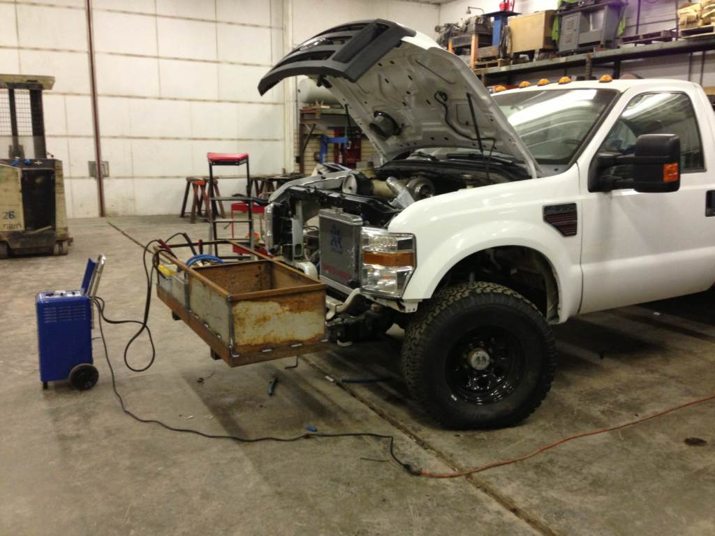

How it looked this morning when I walked in
It will totally be runnable without the front clip as the radiator now stays with the frame. Takes 5 minutes to remove the front clip and the hood usually stays on the truck. But we pulled the hood this time to get enough room to pull the engine without lifting the cab.

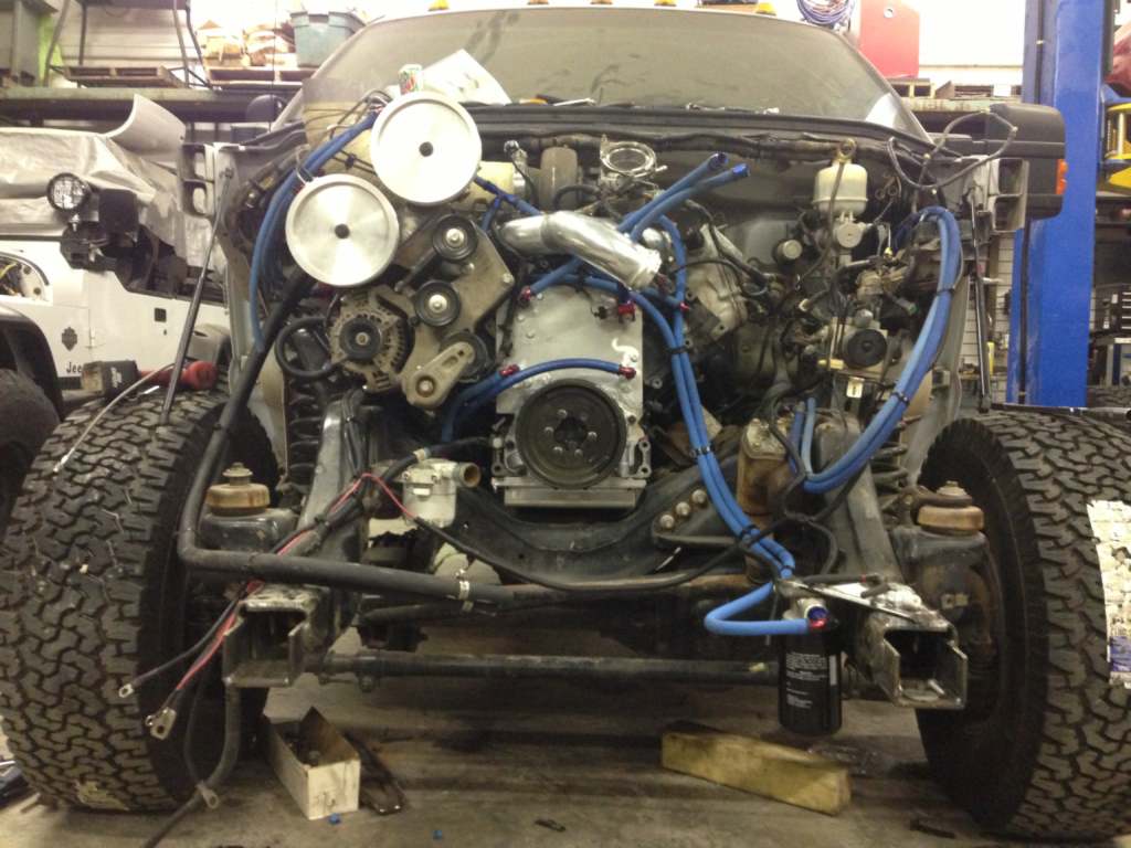

Here a pic of the octopus. There's lines everywhere lol. There literally isn't one factory oil, coolant or fuel line on this truck. If I knew how much I spent on lines and fitting I would probably be sick. I'm guessing at least couple thousand right now.

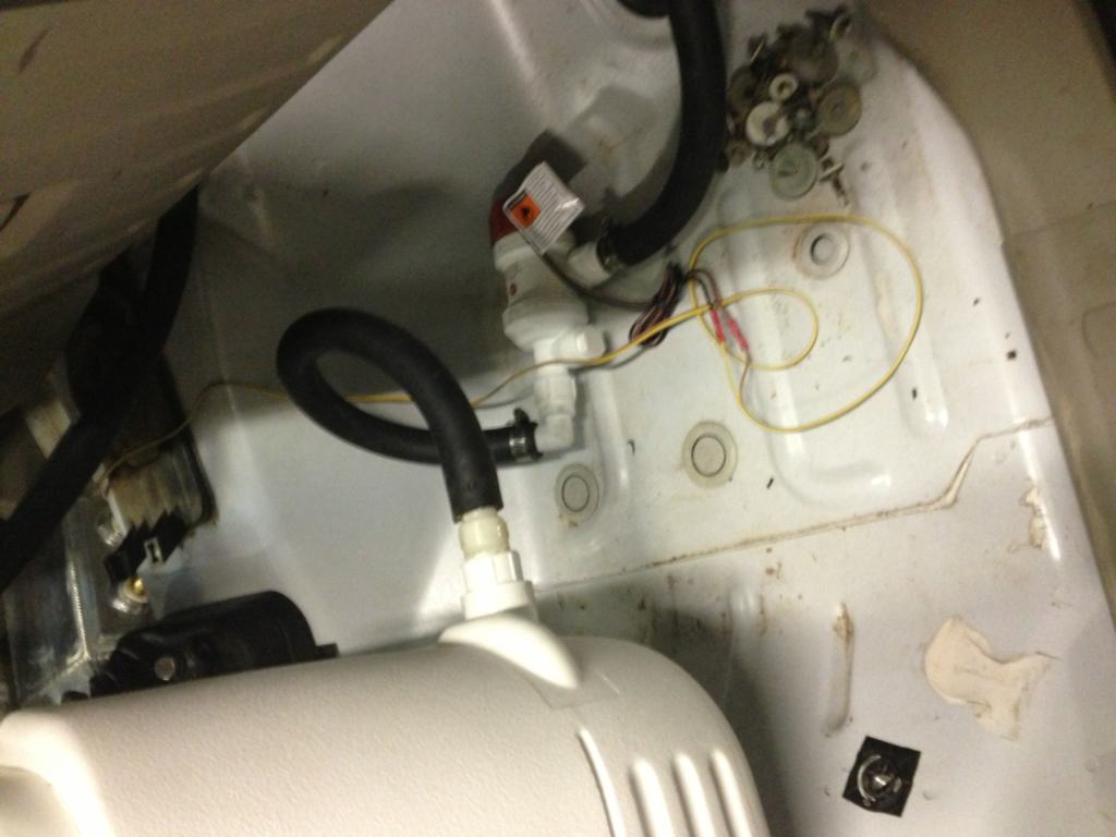

Sweet live well pump action! Straight from the boat shop lol. It's funny, this truck has up fitter switches and its got electric power steering on #1, engine coolant pump on #2 and after cooler water circulation on #3. I don't think ford ever planned on them being for that. But thank you ford you made my wiring so much easier. Lol, looks like a stock truck on the dash, until you hit the up-fitter and have power steering even without the engine running!
