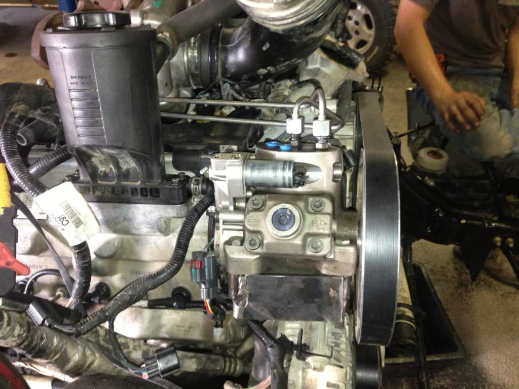

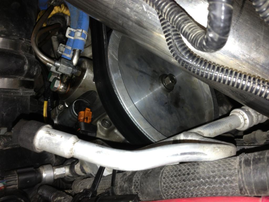

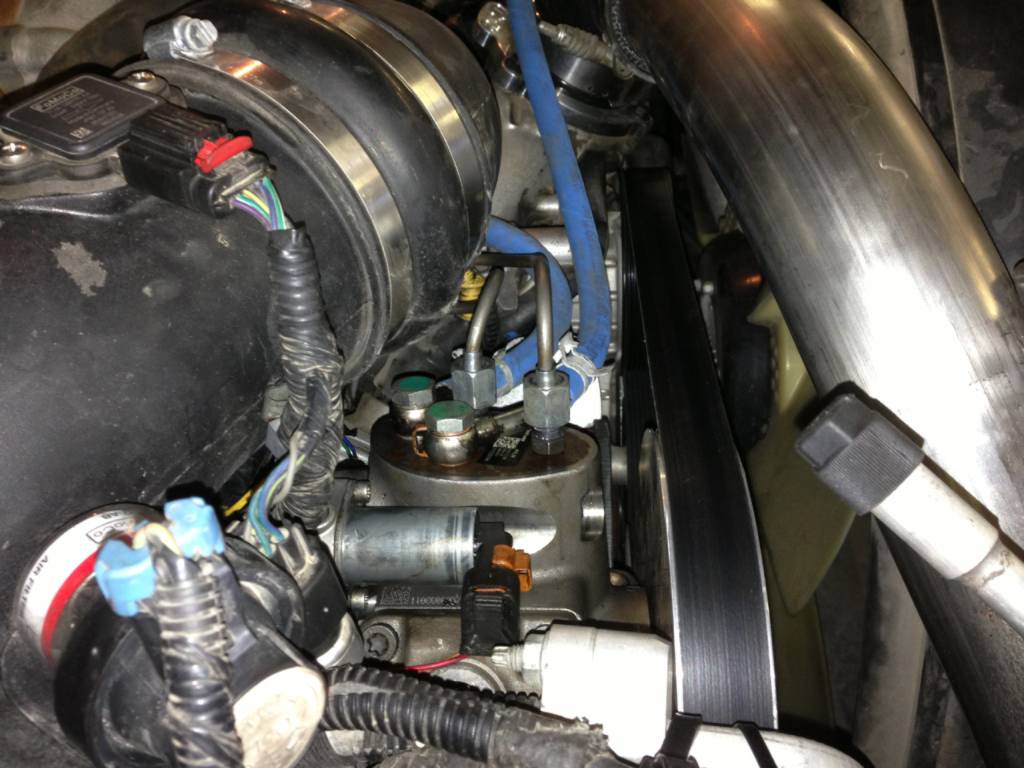

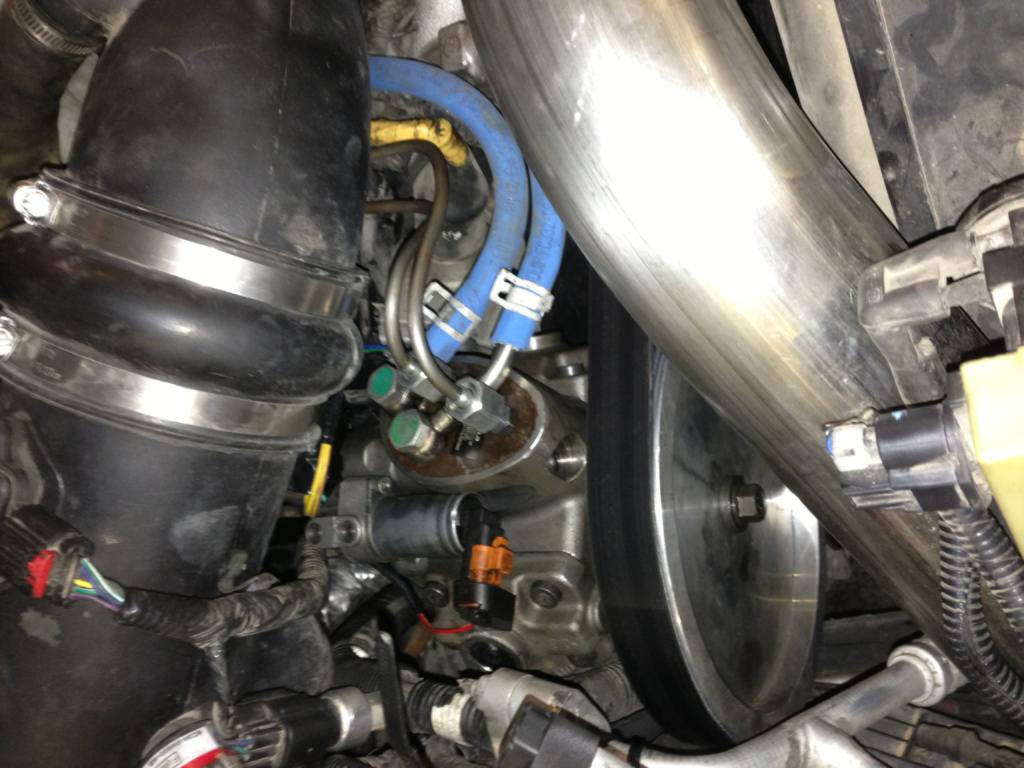

This is an informative thread here. Not selling this yet. So here's a sneak peek on the new "original" kit I'm working on.
Mounts on top to keep the factory alternator.
Run on the main belt no extra idlers, pulley or tensioners.
Solid 1 piece mount made of 3/8" thick material fully welded.
Uses stock k16

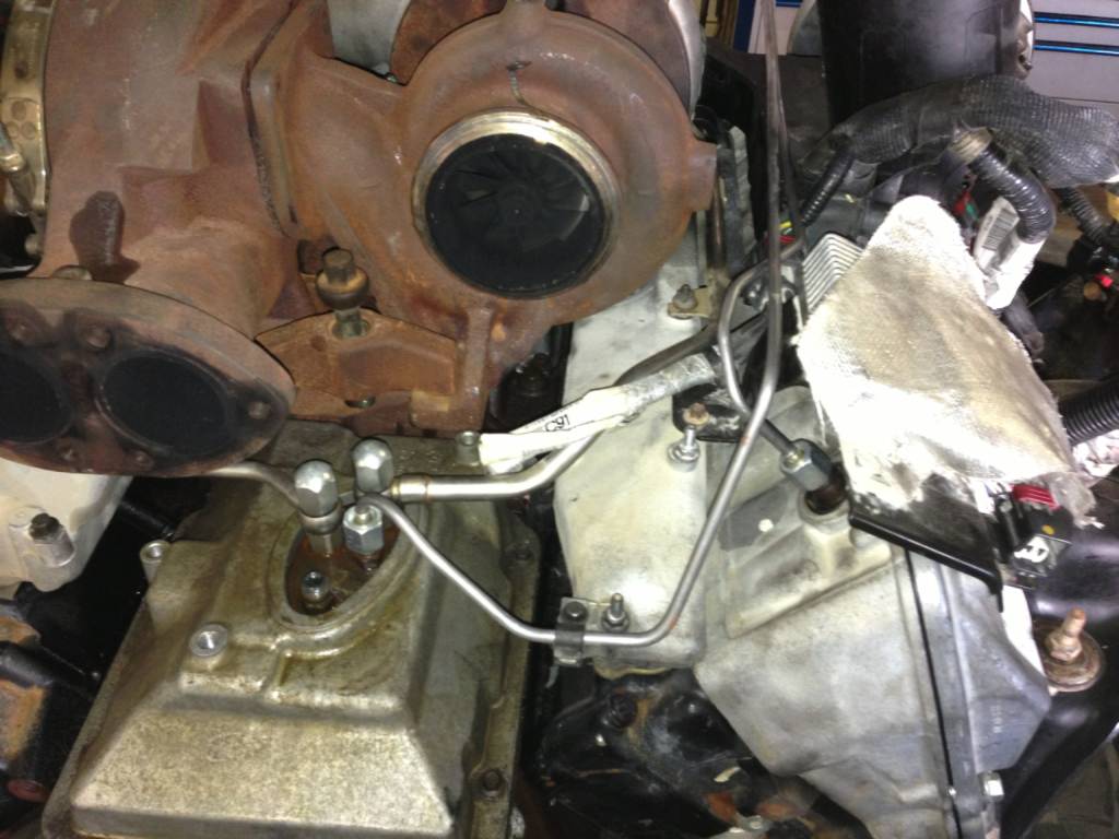

Two Hp lines feed the rail and other pump without t-fittings.
Kit is gonna be affordable and an improvement over others out there currently.
Only requires trimming the battery box and fan shroud.
We've got them running with no problems so far.

It could be done, but you'd need a body lift, battery box ****** and reroute a bunch of stuff to make room. And it was a pita to make lol.

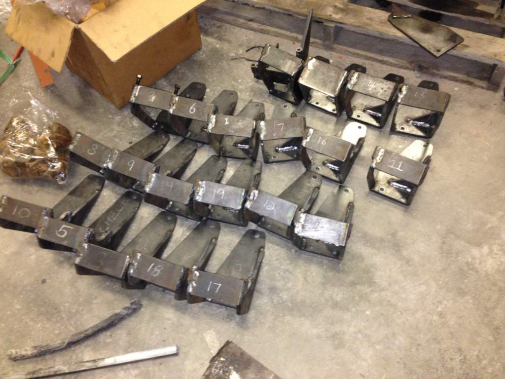

First batch of brackets back from the weld shop. Can't decide either to paint or powder coat. I'd like to powder coat but someone may not want the color I pick. And pairing will keep costs down. What do you guys think?
And right now I'm waiting on line sets. I will have quite a few ready when the lines are here.

powder coat al of them black. if they want a diff color its their choice to redo on their own accord.

I agree with mike powder coat them black keeps it simple!

Very nice Morgan and I agree powder coat them all black.

powder coat them all black and have a couple set aside for special orders if someone wants a different color...or do what mike said and let them worry about another color them self

looks good, really like how the lines are run.
