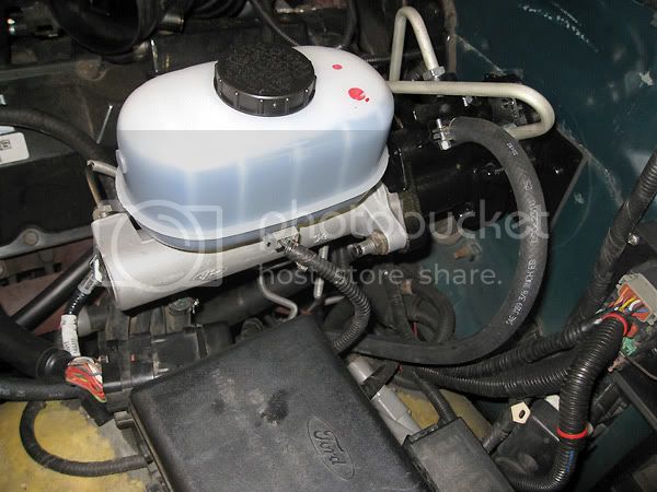

New 1 5/16 master on the left, original 1 1/4 master on the right.
The new master came with a revised harness adapter for the cruise control sensor. It's a direct plug in as is the fluid level sensor.
Both brake lines are a direct fit too, no adapters required. The big silver sensor if for my BrakeSmart controller.

This project took me about 5hrs. It was awful hot and humid so I had to work slow and take some breaks along the way. Refilled the steering system with Schaeffers transmission fluid, master was topped off with blue ATE brake fluid.
My impressions during the test drive were excellent, pedal feel is firm and consistent with less pressure being required to stop the truck than before. As a test I backed my 25" gooseneck trailer down our steep driveway. I had no problems operating both the brakes and steering at the same time. This was a very easy mod that requires no special tools or any modifications to the parts and the results are a truck that actually stops when I want it! :thumbsup:
