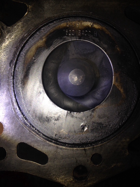

Well as some know my 97 bent a rod a week ago when I was up in Ohio. Can't complain one bit as it has 215k on it and 12K of that was over 600hp. It happened while I was getting on it hard, when I let out of it it has a strange knock. Lol. It has been giving my signs of letting go for a while now with a lot of blow by out if the passenger valve cover vent. Number 8 was the one to finally bend, piston is 3/8 shorter than the others! New 7.3 going in, but it's only a forged rod again. My plan is to run this for a while while my billet rod engine is getting built. I hope it lasts, but I don't have high expectations! LOL!

Cracked piston
Short rod at TDC

Cracked piston
Short rod at TDC
