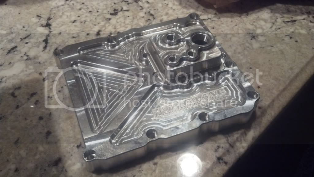

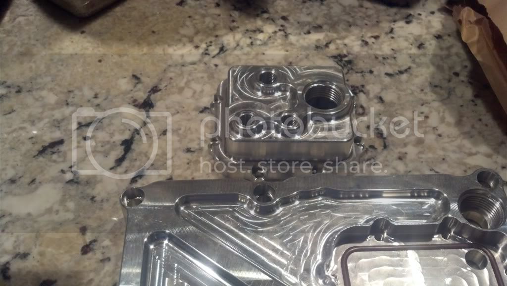

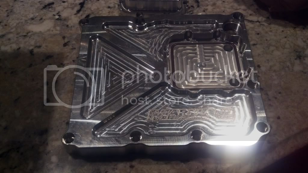

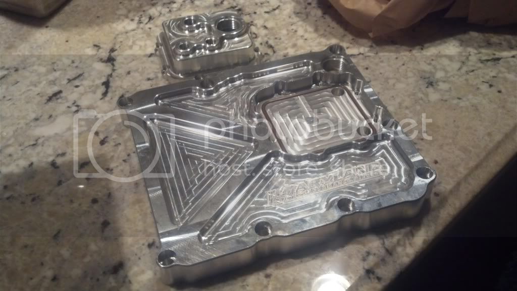

Plate showed up yesterday and it is awesome. It is a stout plate!! Going to be mocking up my own filter and cooler in the next week n a half. Few questions. What would be an adequate size for the cooler? It will be mounted up front behind the grille somewhere. Also what micron does the ford filter filter down to.
