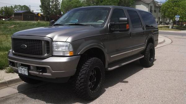

And so it has begun...
^^^ This is essentially the current status, and appearance of my '03 V-10 excursion, limited edition I bought almost 2 years ago with the intent to to a 6.4 conversion. I hoped to start on it a lot sooner, but time and funds went into my red '08. Now that I'm bored with that truck, it's time to start the excursion project.
Since it's my wife's daily driver, I will have to keep down time to a minimum. So here's the plan:

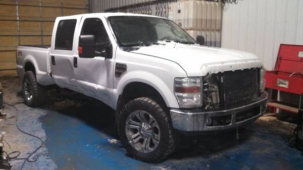

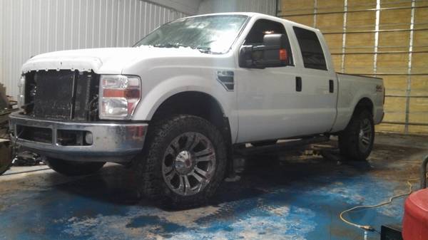

^^^Here's the project donor I bought from a friend recently, right after it got t-boned, which will be the source for the majority of the parts for the project. I expect it to be mid-late summer before I get everything done, but I plan on running the entire front clip, & drivetrain from this truck under the excursion. The frames are obviously different, and I want to have all the updates and upgrades from the newer truck, so under the cab somewhere I will graft in a rear frame section from another excursion. Before I start cutting up the excursion, I will finish the frame work, transfer the newer axle back under the newly spliced frame, connect brake lines, complete the frame electrical, build the new driveline, and wrap up whatever else I can before I get ready to set the body on. This will just be a simple splice through the windshield posts, and under the front seats. I've got some performance and reliability mods in the works for it, as well as a color change to come. I will keep this thread updated as progress continues.

We have been discussing doing one of these or a 6.7 swap into an Ex a lot the past few weeks.
Any reason your doing the whole front clip vs putting 08 cage on from firewall forward to the ex body? The frames will separate right behind the engine cross member.
It may be easier to swap the 08 front frame section on the Ex frame and not have to get another parts Ex.
I am in no way trying to tell you how to do anything, just thinking out loud.
Distance doesn't help but I have a few parts Exs if you need anything.
Looking forward to following the progress. Will be an awesome build!

I have a friend with several excursion frames with a fuel tank that I can get for next to nothing, so I won't have to disable the wifemobile until the project is further along. I was planning on doing the frame section exactly where you said. They aren't a perfect match, but close right there. the '08 has more bracing on the inside of the rails, but no big deal. It's just a matter of removing rivets, cutting factory welds, and hopefully sliding the new rear frame section in. The drivetrain will be removed for mods and engine bay paint when I do this anyway, so it should be pretty easy. If for some reason, there is an unforeseen complication with grafting at the factory joint, then at least I have the option of splicing it back a little further. There are a lot of other ways I could go about doing it, but I've had it in my mind exactly how I want it done, so this is the route I'm taking. Aside from having grade 8 bolts where rivets used to be, it will hopefully look like it came from the factory that way when it's done.
