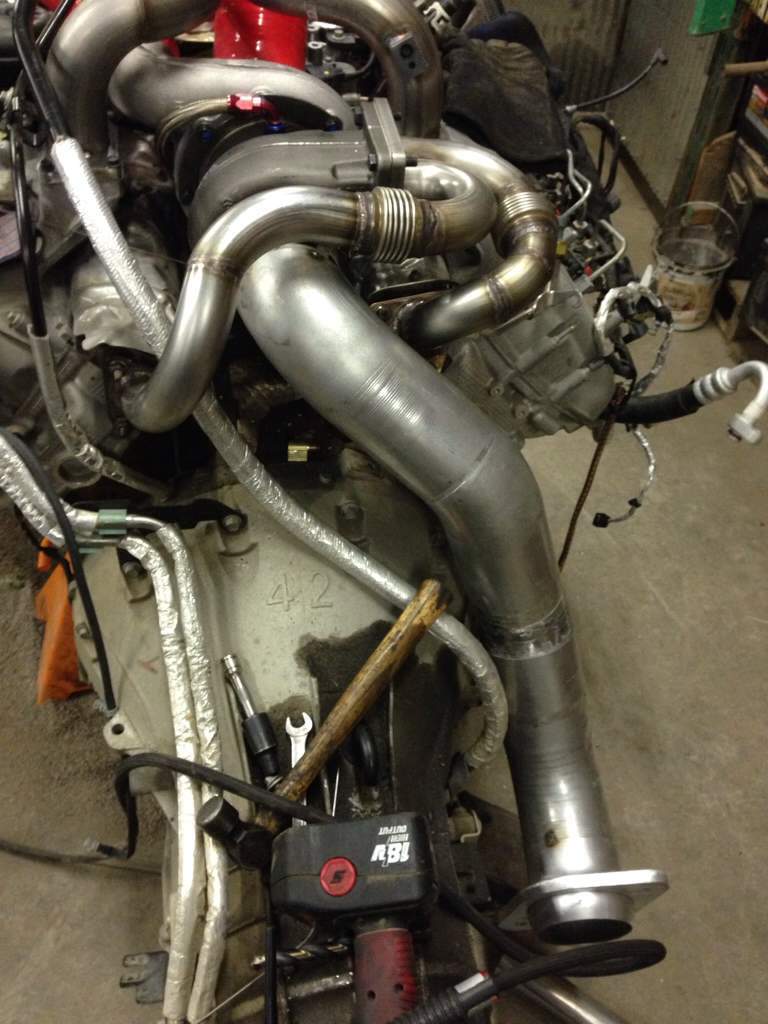

Well here's what we've been doing. Prototypes are running. You've probably seen the other 6.7 truck build we are doing. To keep that these clean here's a look at the turbo kit so far.
Pics are worth a 1000 words. But here's the basic overview. Looking for this to be the everyday budget kit that is economical for most and upgradeable for the rest who want more. T-4 flange. S300 based charger will be sold with kit, sizes and billet options will also be choices when ordering. Will be made to accommodate either s&b or afe cold air intake. Complete with everything needed to install. Color instructions. All 304 stainless piping. Will be a wastegate option as well.
So what do you think and what would you like to see?

Going for simple, upgradeable, affordable and quality.
Pricing has not been set so please don't ask. Will have more details to come. This truck has a 66/74 .91 on it. Lights very well and the video was from a dead dig and no spooling.

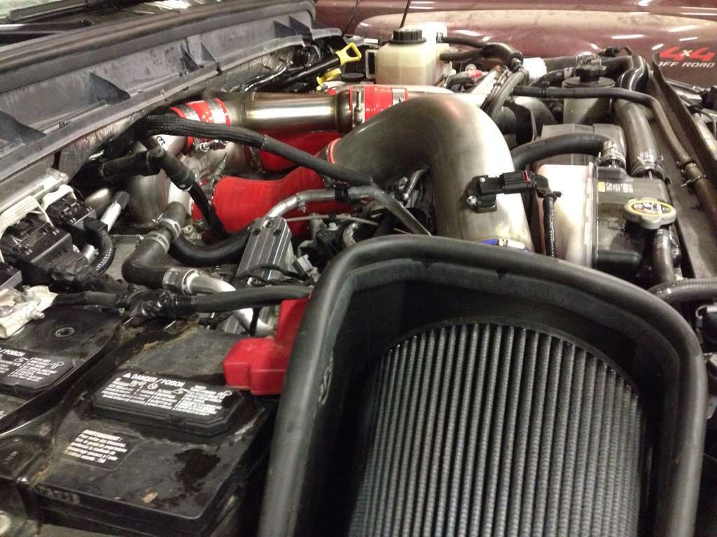

It definitely runs well. 40 psi of boost. Absolutely smokeless at wot. And is clean when driving normal. Pulls much harder than it used to.

It's a lot of fun to drive. Really it is very comparable in driving characteristics to a tuned 6.4. And just the box h&s for now. I am going to try a few different thing but I don't wanna get too wild. This truck is just being used for testing and fitment. The race truck is going to be the one getting the real abuse.

Looks great!
I like the bellows and the cold side pipes a lot.
Thank you. Spent a lot of time on the way I wanted it to come out.

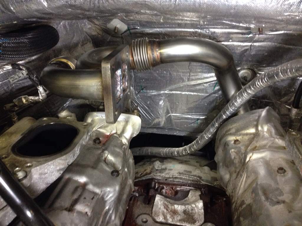

Fwiw the hot side pipe is stock. Save money for the budget aspect. It also retains the factory pedestal. Drops it just like the factory turbo, oil supply and drain are incorporated into the design like the factory. Drain is internal in the pedestal, no extra line.
Budget base kit and offer some upgrades like ss hot pipe kit and wastegate for the more performance oriented crowd. And compound add on in the future.
