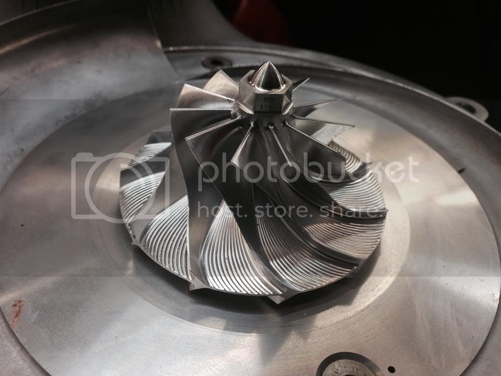

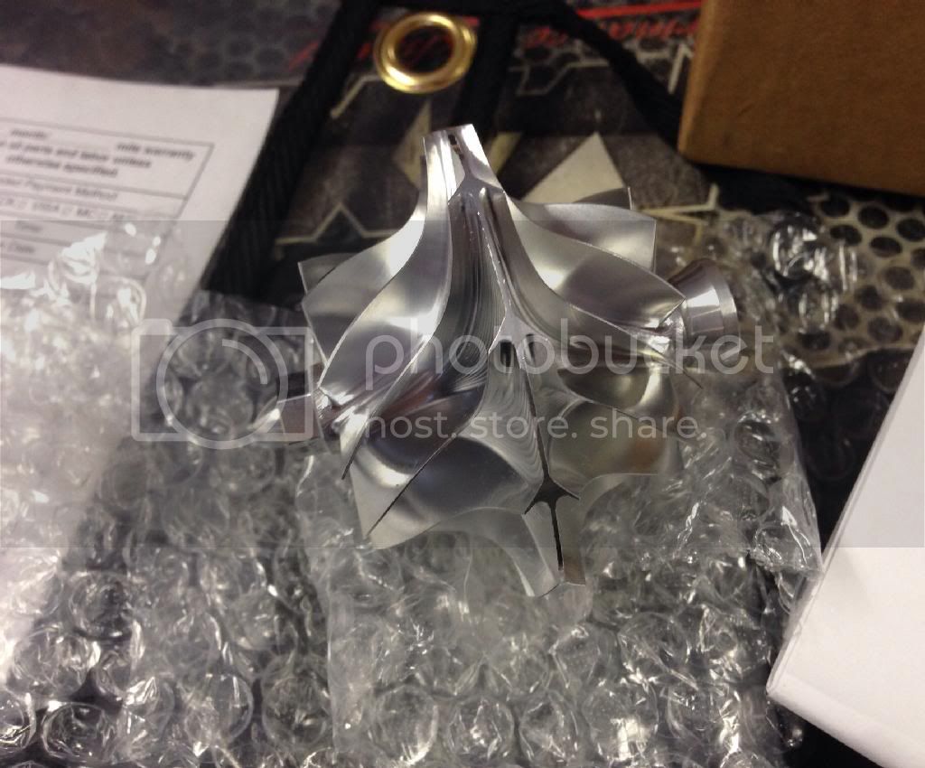

Finished the install on a stock not deleted truck. Definitely more power thanks tock. Worth the money!!!

According to south east power and bob Riley it does not need to be balance because the large frame garret turbos are component balanced. Shaft speed is reduced because it's more efficient. The OE wheel has 10 blades, WW2 has 11. OE is not round, the WW2 is. OE is 4.2oz, WW2 is 3.8oz.

So wouldn't less Rpms and less weight mean less stress on the shaft ?

Well the drop in rpms and bp should really help the stock charger stay alive. I'm glad to see some info on these. Please keep us posted it could be a very good "reliability" upgrade.

so in saying that it should drop shaft speed, does that mean its producing more boost and it opens the gate sooner in return dropping shaft rpm and easing stress?
the only thing i'm now wondering is how turbo rpm can drop if utilizing a lighter wheel. i wanna believe it boost increases, bp and rpm will go up. just remedial thinking here on my end. now if it spools slower that may help with the low end bp these things are known for making.

if this wheel builds boost easier, would that mean that it doesnt have to spin as fast? Cast wheel that flexes more needs more rpm to build boost? Billet wheel that isnt suppose to flex needs less rpm to build the same amount of boost as the cast wheel?
