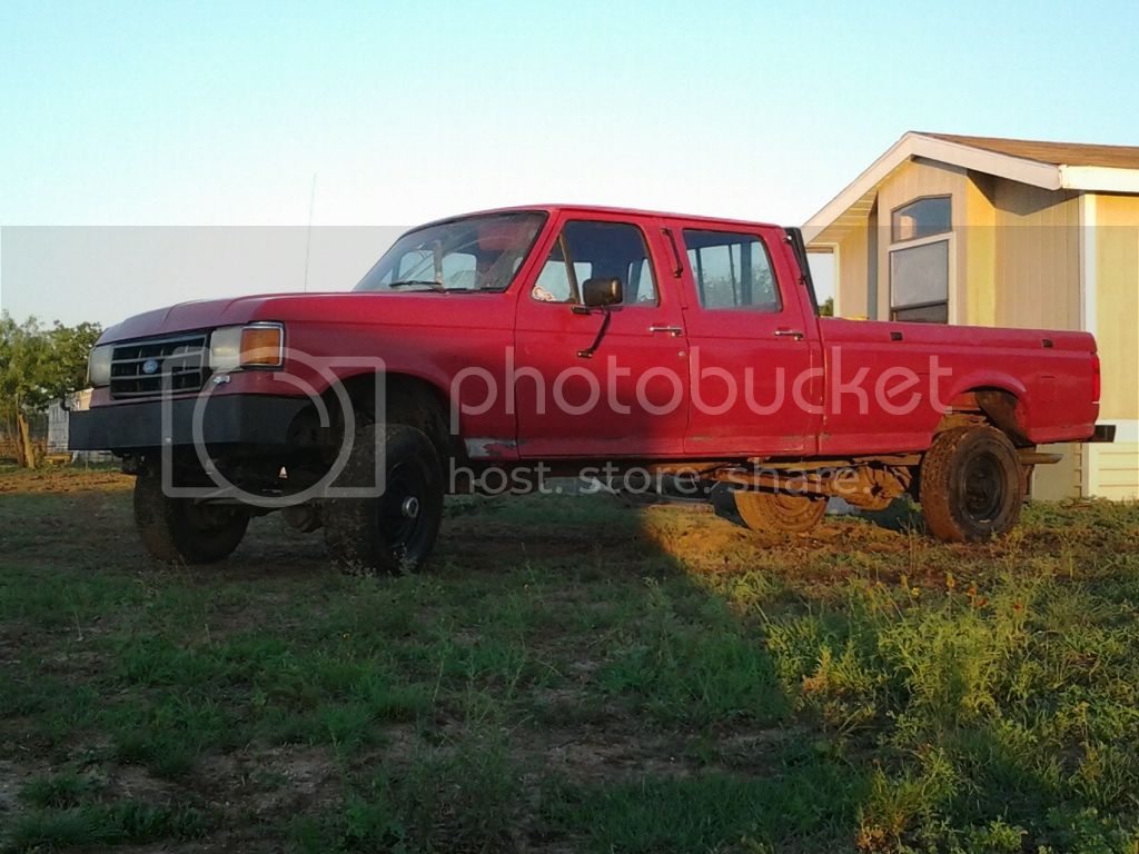

Going to be helping my buddy out on a new project of his and wouldn't mind some advice and guidance. Probably will be using a 12v in it or a p-pump 24v. Whatever he can find a good deal on, as it will be a budget build. It will also be getting 05 axles this week, since he just picked up a full 05 rolling chassis for parts. Right now we are trying to figure out what trans to use in it. Have a few e40d's that need rebuilt laying around the shop so it might just get one of those. Any suggestions, or guidance on where to get conversion parts (ones that we cannot build ourselves) would be awesome! I will post some pics soon. The truck should be getting the idi pulled next week and the 05 axles installed. Should be a cool project!

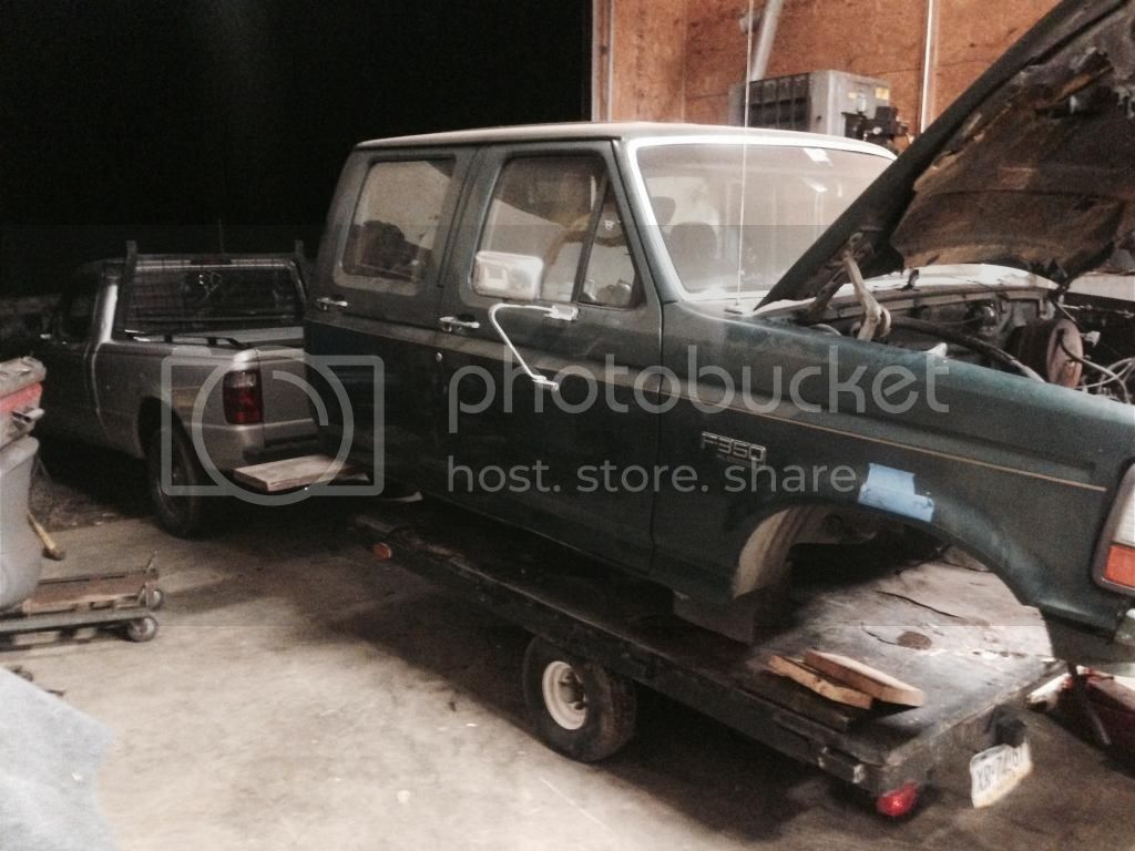

Going to have a lot more pics of this thing coming soon... We got the cab off and the IDI and trans out and gone. Stripped the frame the other day and he took it to get powdercoated. They got all the 05 front axle stuff done and ready to be bolted/welded on when the frame gets back. Everything has been mocked up, drilled, etc and is ready to go. This isn't even my truck but I love working on it! Should have more pics soon but here is a funny one :)

Oh and forgot to mention there is a 95 12v donor truck sitting outside with a mild built 47th that will be going in this truck... Just need to yank the cab off the dodge for scrap and then pull the motor/trans out.
