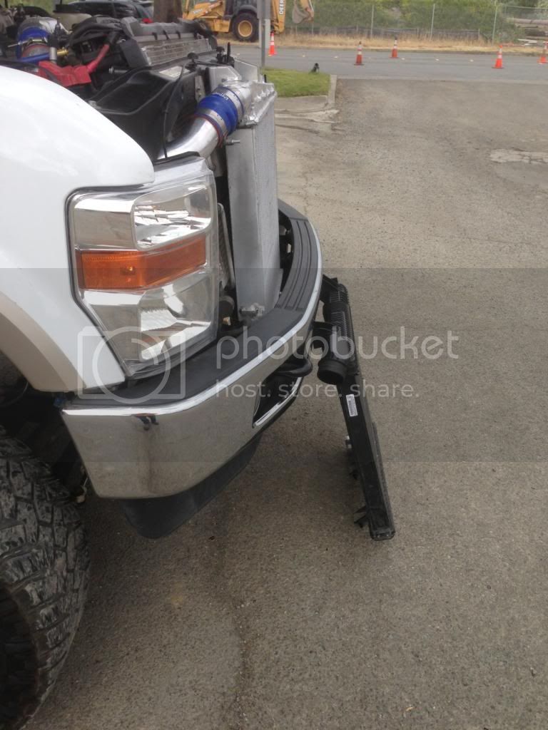

Well guys I finally got to get another one of Alradco's intercooler prototypes on a test truck last week and I have to say this blew my expectations out of the water after the first test one didn't reach our goals. I put this intercooler onto a 10 6.4 (GotStroke) with a set of 71/59 turbos, Elite Z-max intake, no limit pipes and intake and full deletes. We did a 0-70 pull in a canned H&S tow tune and with the stock cooler we hit 1,114 degrees on one pull and 1,103 on a second pull, went right back to the shop and swapped out stock intercooler for the Alradco one and went back to the same stretch of road and did it again. Same tune, same 0-70 and practically same out side temp we hit at full throttle 910 EGT's and with another run to back it up did 912 for EGT's. I have to say I was really happy by that, wasn't expecting a 200 degree drop unloaded with just an intercooler swap especially because back in the day a couple people did back to back test and saw very small changes, nothing compared to this. Next week we will be doing some towing test with his truck and my truck so stay tuned for those results!

Good to hear that you like what you have seen thus far. Looks like a very nice intercooler and looking forward to seeing how this performs when put behind a built engine with some large turbos.

Thanks for the independent testing, input, and update Nick. Look forward to more results soon.
