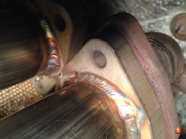

Right now I stand with everything removed and the pedestal ready to bolt up but.. One problem. The kit did not come with longer bolts for the Uppipe to pedestal and no threads so do I just have to go get longer bolts and nuts?
Here's with the bolt in

It's all good I appreciate it though! Gonna pick up some bolts soon so I can have it running tonight.
It did not directly come from y'all, I bought it from a member here who never decided to put the kit on so they could have been misplaced somewhere else.
