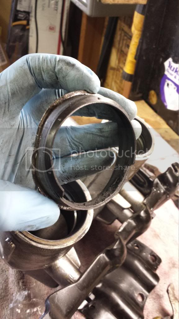

I had a very similar, high pitched noise when a seal let go in the crossover pipe.
It was still sealing for the most part.
It was only down a little on total boost.
Main identifier was the noise for me.
Tore it apart and found this

After hearing the exhaust and the picture of your U-Pipe along with you saying the Atmosphere is not wore out, I bet the seal is gone.
Also I would do a CCV re-route. If that much oil is from blow by and coating everything.
