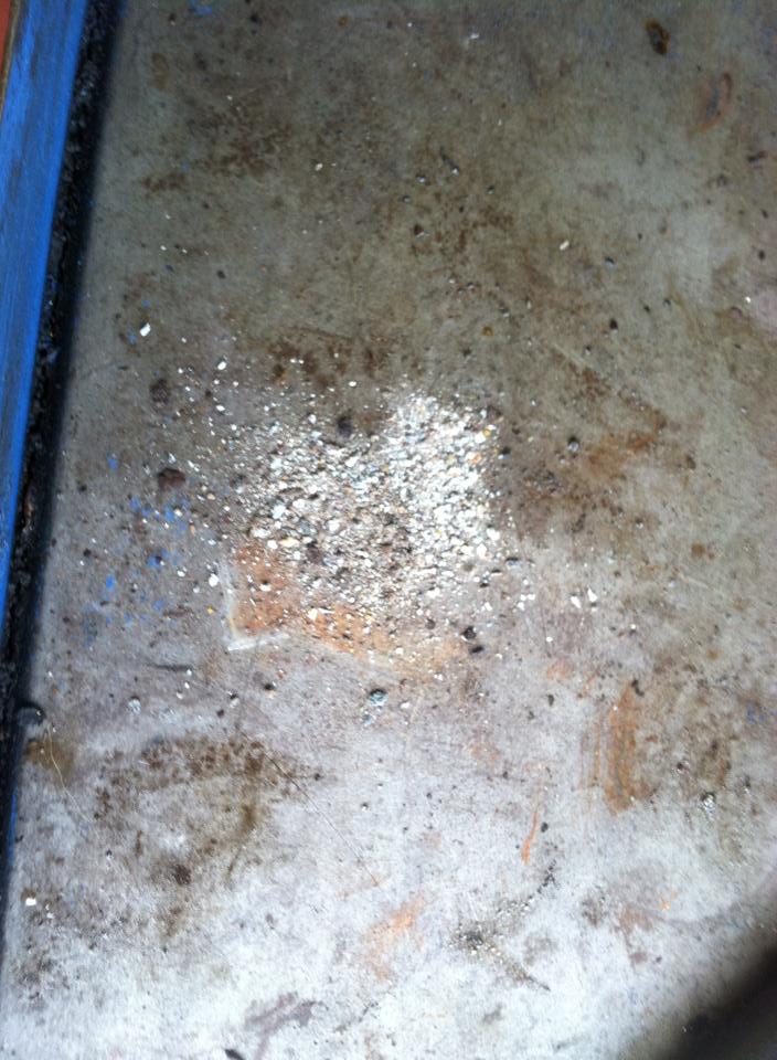

Problem resolved..
I'll post pictures later..
OK..
Master cylinder body.. aluminum..
Hydroboost body.. cast iron..
I live in a state where they use road salt in the winter time (may be a factor, may not be)..
The master cylinder was rotted onto the hydroboost unit.. When I finally got it off and air-hammered apart to retrieve the push rod, there was a shload of corrosion, rust, and assorted nastiness packed around the push-piston of the hydroboost unit, binding the piston.
JLDickmon
2,149
49048
here's the crap.. here's the bore I dug it out of...
