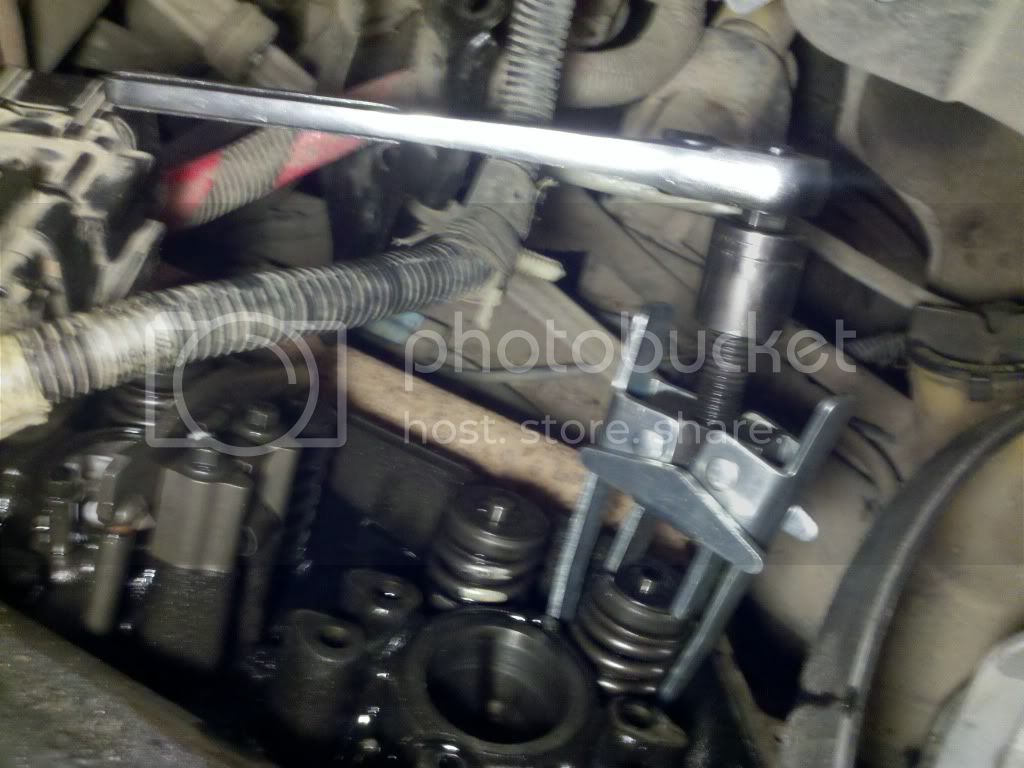

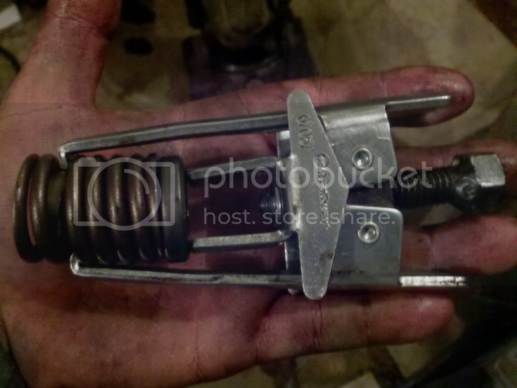

You will need a valve spring compressor to go on. I have this type shown below. It will need the bolt cut in half and a nut welded to the end as shown. I regularly loan mine out if you need one.

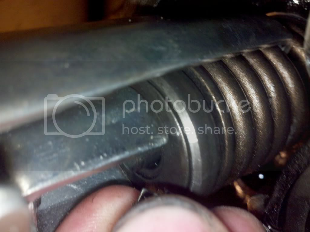

Put the compressor on the spring and tighten it down.

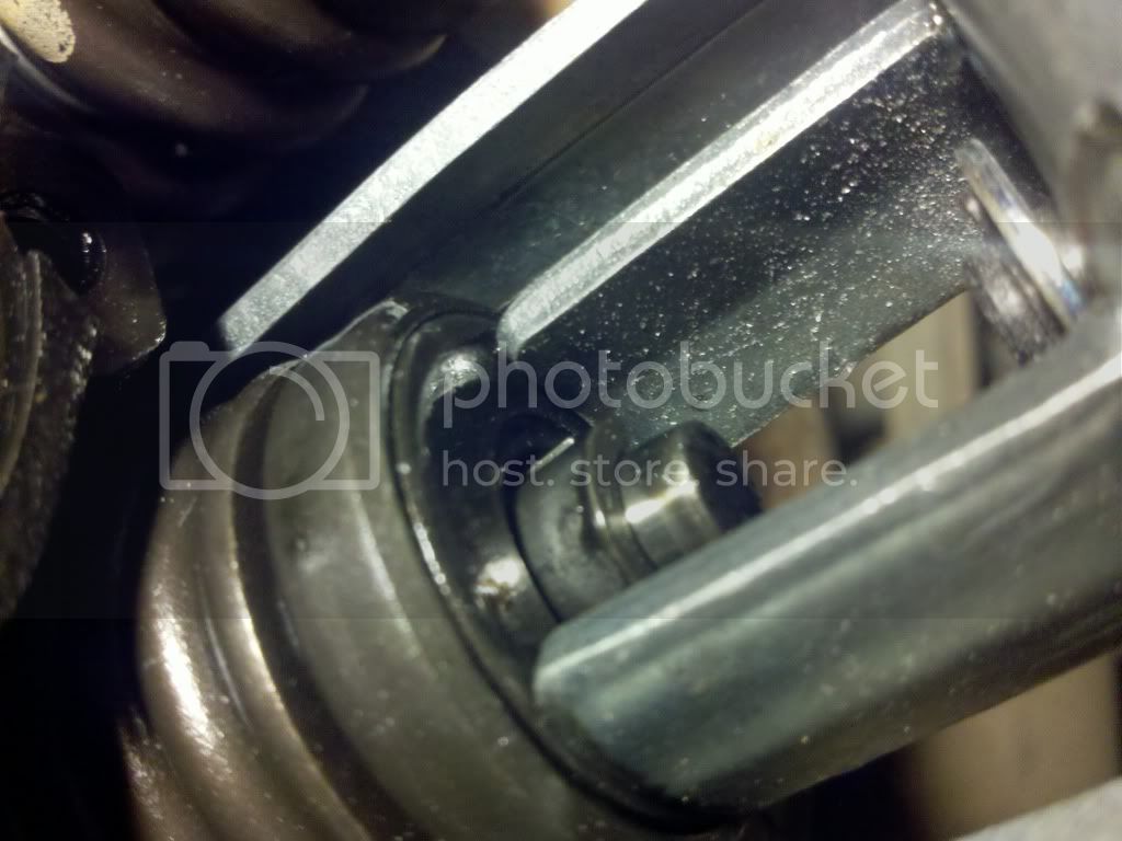

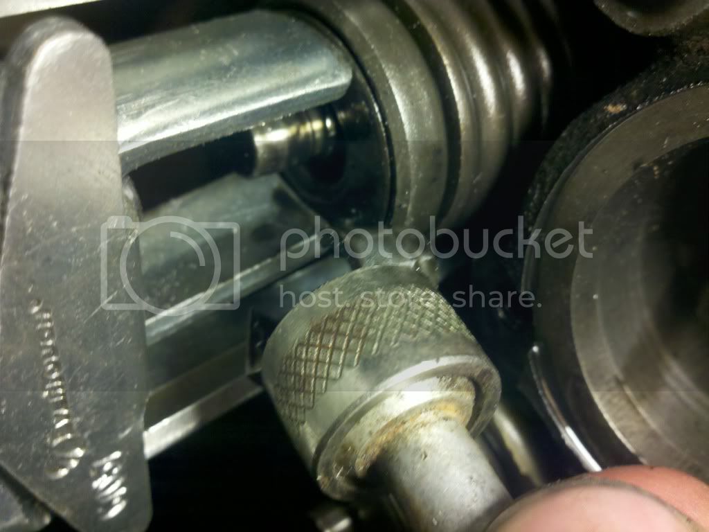

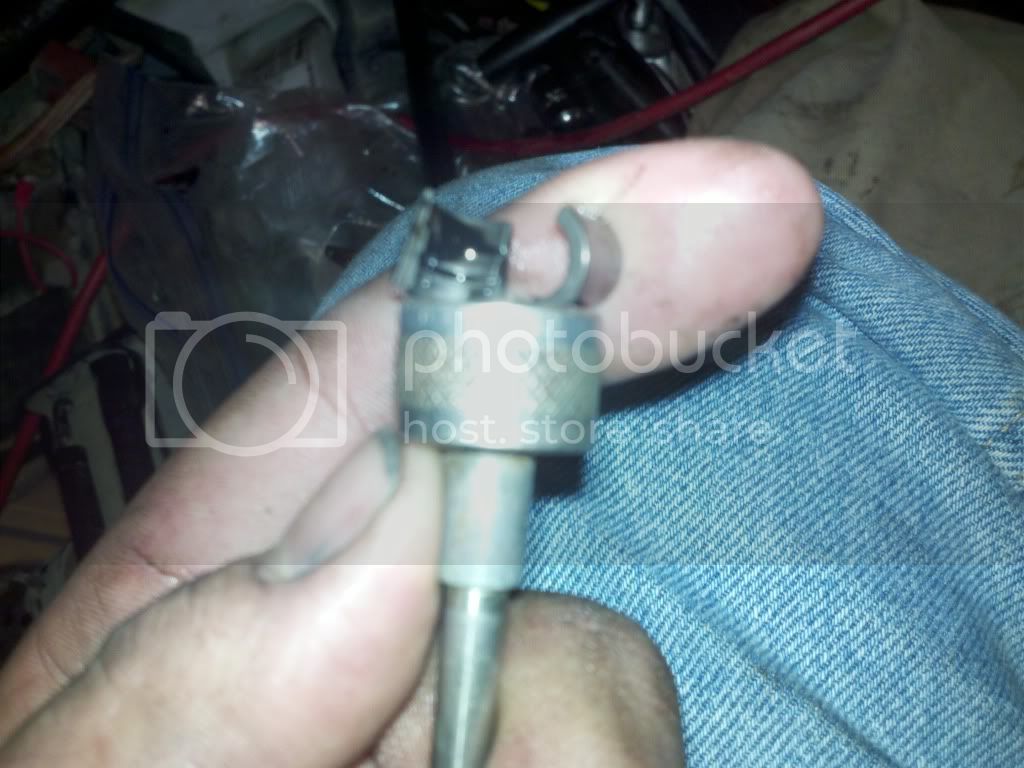

Once it is compressed the two keepers will come out. The best thing to do is use a telescopic magnet to get them out as you push the spring down.
Then just slide the compressor and spring off.

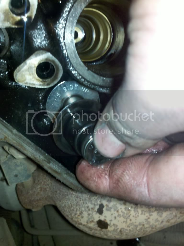

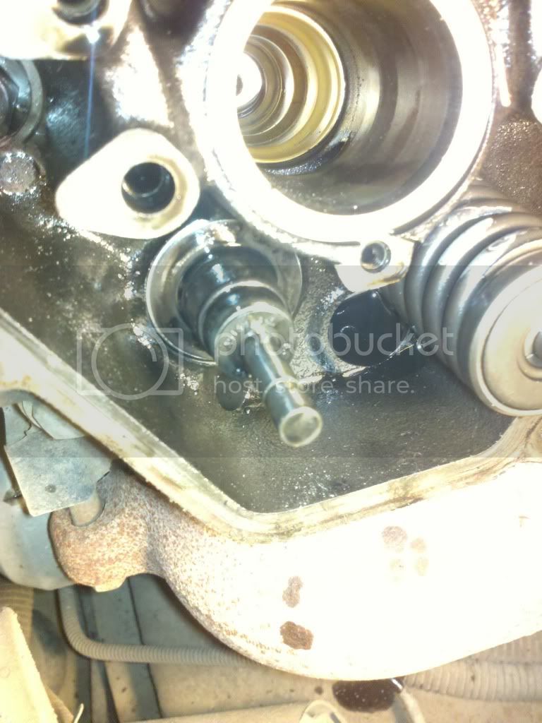

Then pull the valve seal off. Under the seal you will put the CORRECT shim.
Ensure the shim is completely seated. There are ridges around it where the factory machined the seat. It must fully seat onto the machined surface. Then replace the valve seal. You may have to pull up on the valve while pushing on the seal to move on to the next step.

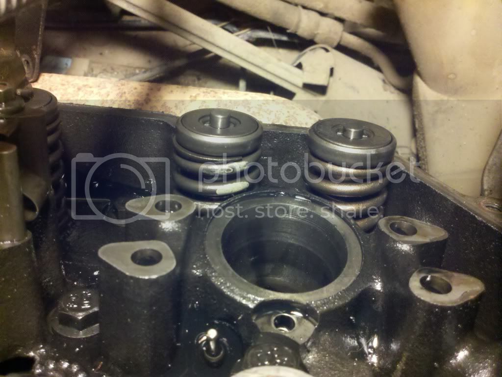

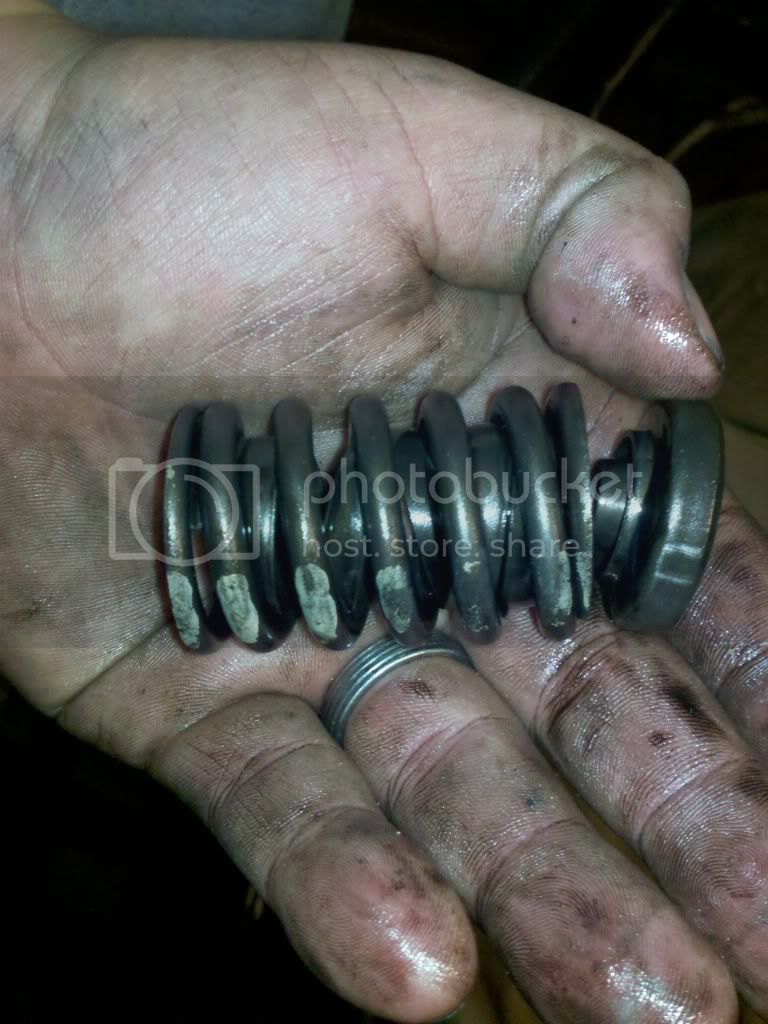

Next compress the new comp910-16 valve spring with the spring head on.
Now insert the spring onto the valve.
Now reinstall the keepers. They're kinda fiddly little things so it is a good idea to put a rag behind the spring in case you drop one. Install them as they came out and release the tension on the spring.

As far as if you have to remove injectors, I think you can do it with injectors in. You will want to pull the glow plugs for the test rod to look for TDC. Also, I did mine without pulling the air box.
My valve spring compressor looks exactly like that also. On the passenger side I used a ratcheting box end wrench (no room for a socket and ratchet, air box was in the way).
