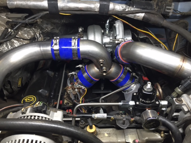

One of the only complaints about OBS T4 kits has been the down pipe, but thats about to change! Our OBS T4 mount kits will now come with a complete 3" down-pipe! Firewall modification is still needed but is minimal compared to before. These are the BEST T4 kits on the market for your 7.3L! Let us know if we can set you up today! :ford:
Call 503-435-9599 or Email [email protected] with any questions!
http://www.iratediesel.com/store/buy-online/?slug=index&cPath=46_64

We are getting the Downpipes together as we speak, we have a shipment coming in (couple weeks) and for now have just barley been able to keep up with the new kits being ordered. When we get the shipment of them in we will be able to sell them individually, right now we have to make them as ordered. It will be a 2 piece down-pipe but will have the Bell at the end like a diamond eye exhaust, some may need to cut that off and get an adapter to finish it out as per your exhaust, but it will at least get you all the way down to it now. As of now this is the only way we are having them made. I will update when we get some better pics so you all can take a look. Sorry for the delays here but this time of the year is extremely busy!

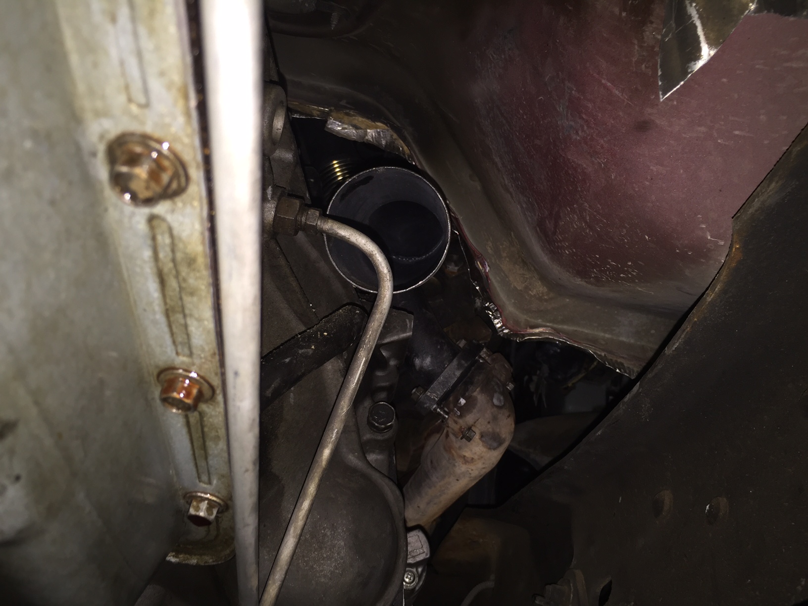

I have a question, why is this down pipe like this? Do I have the right one? basb on an obs. It is directly in the path of the trans line, and there is absolutely NO way to "bend" the lines out of the way, the DP is in direct path of the fitting coming out of the trans.
IF I was able to bend the lines out of the way, there is no way the trans dipstick would fit.
not sure what is going on, but its going to be a huge undertaking on getting this to fit around the trans lines.
Help me out here Irate, am I doing something wrong? can't imagine what the issue would be, its pretty forward bolt in deal on the down pipe, not sure how I could screw that up lol.
thanks

my issue though is the damn down pipe is almost hitting the trans line, there is no way I could bend that line, its actually almost touching the trans fitting. i'm not sure how a cab bushing would affect this though, the motor is bolted to the frame, and the trans is bolted to the frame crossmember/motor, so If the cab bushing was bad, I would have fit issues with the downpipe hitting the cab.
maybe i'm way off base. thanks for your help and input, but something is just not right with this set up.

My thought is if your cab bushings are bad, that's keeping the downpipe from taking a path over the trans cooler line and fitting. Just something to consider with these old trucks.

I had something similar a couple years ago with an Irate downpipe. I had to end up cutting and reconfiguring it to where it should be.

oh I see, the front of the cab might be facing down, but wouldn't I see gap issues on the fender/door spacing?

I had to replace cab bushings when I did my t4 swap. I had issues getting uppipes to play nice until the mounts were done
