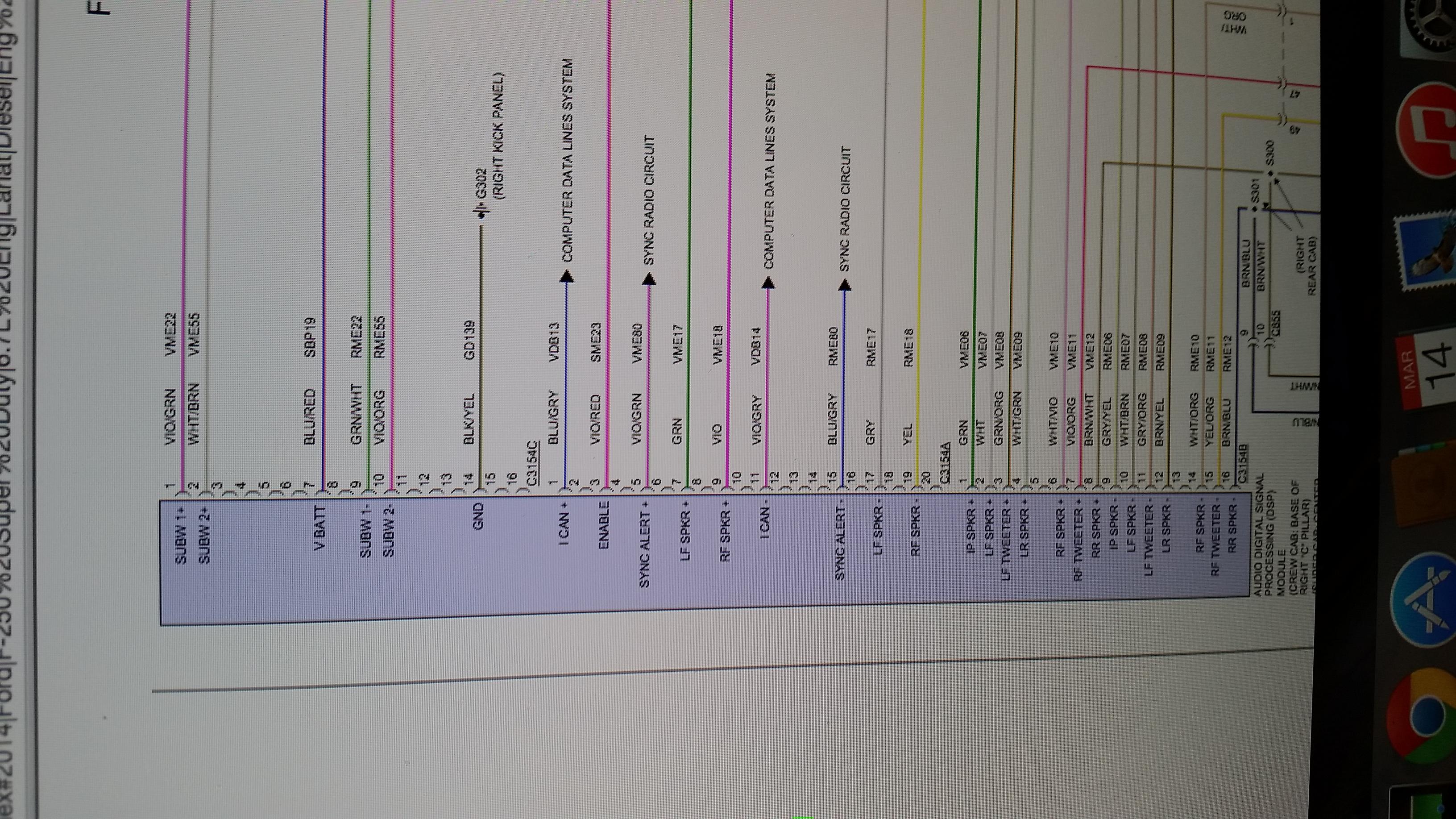

Hey guys, I am installing an aftermarket 13" JL behind the seat of a ccsb with a factory sub. I am using an audio control LC2 to send the signal to the amp. Does anyone have the wiring schematic for this? I just need to know which wires going to the factory woofer are (+) (-) and Left and Right. Truck is a 14. Thank you in advance!
powerstroke22
Apr 17, 2013
591
Long Island, NY
That's Navigation circuit w/ Sony, if you need something else let me know I have them all.
