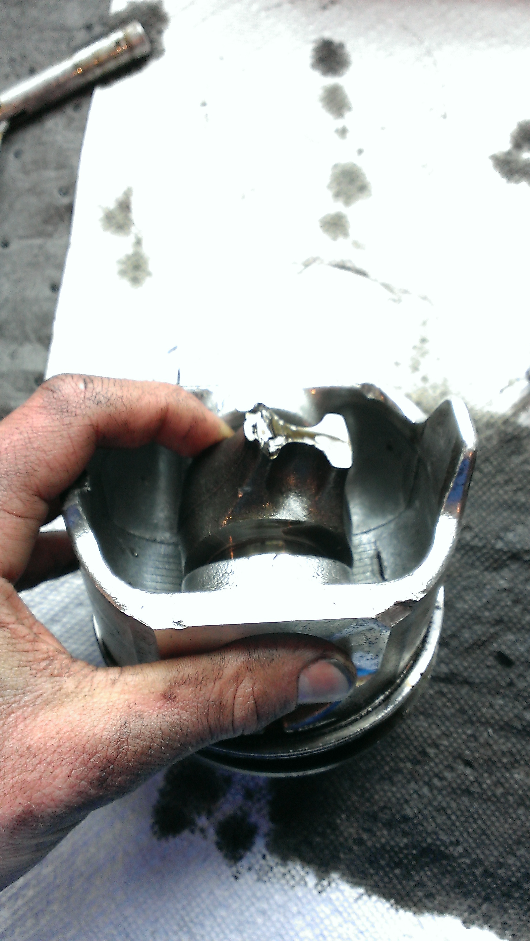

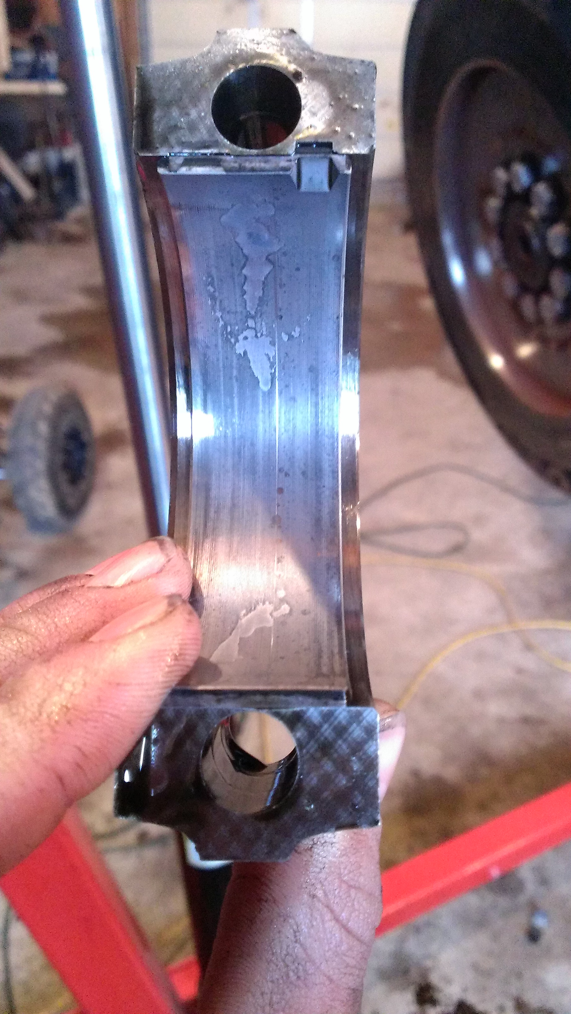

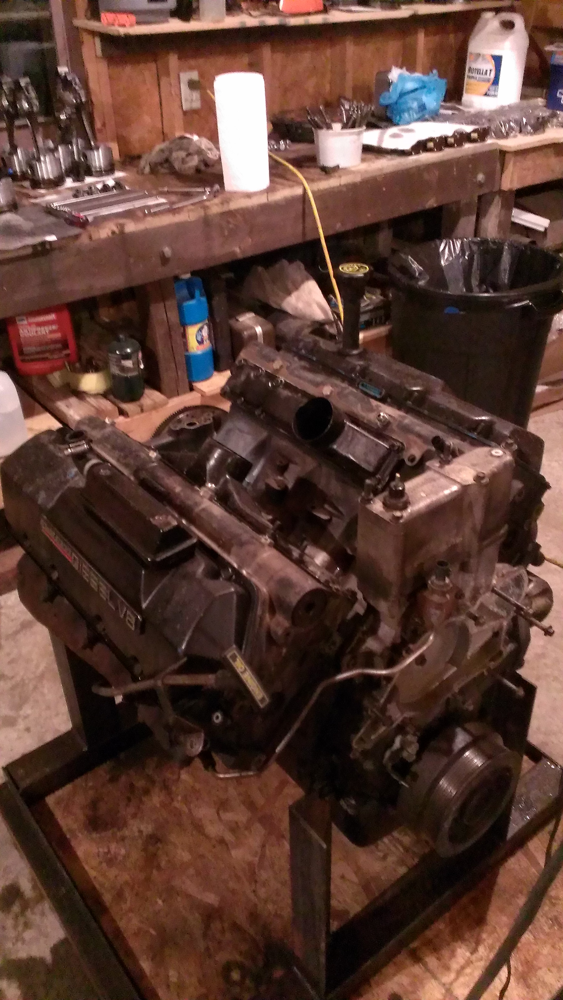

well since she's been on the road for a while i figured id let you guys know how she was doing. for those who don't know she split number 3 in into about a million nice shiny pieces. it split on decel and since its a stick i think is why it didn't lock up because it came apart at the top right below the wrist pin and proceeded to have a field day with everything above and below it. it made a hell of a sound so i tore it all down and found this..

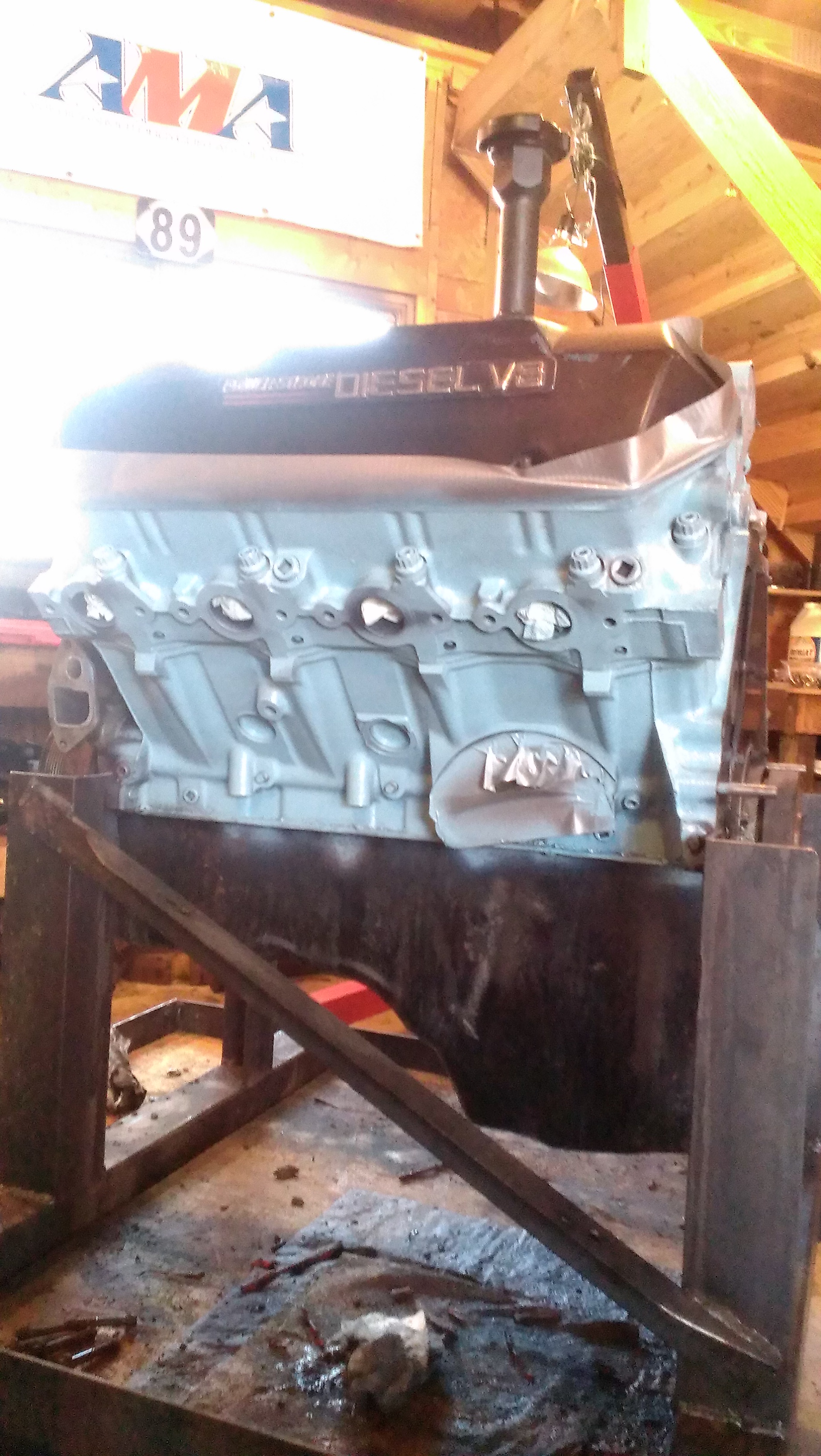

so after talking to marty and dave at swamps for a couple weeks i still didn't know what i wanted to do because everything from the heads down was trash accept for 4 or 5 piston and rod assemblies. then i heard about another user having a built block with hypermax rods pistons girdle and fire ring heads i decided that was the best route to go for right now...

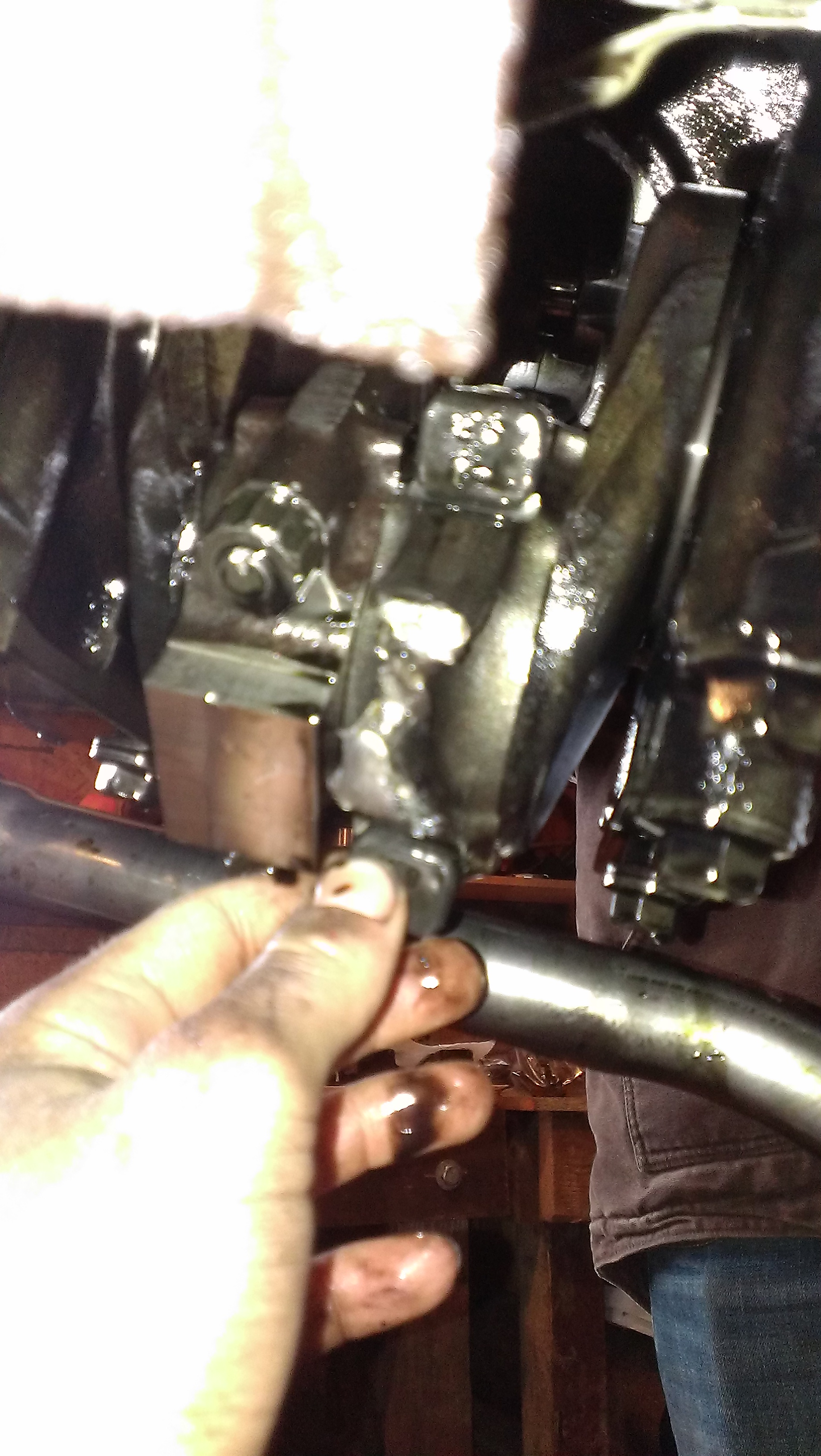

so went and picked up the engine. had about 10k on it since it was built and the guy had it in the garage so that was all good. brought her home in this sweet azz crate and heres what she looked like. got her prepped and painted up and outfitted with my injectors and plenums and turbo mount. i also resealed the oil pan as per recommendation because it had a red type sealant that was pretty brittle. when i took the pan off i realized that the oil pickup had a modded spacer where it bolts to the block and that was also red sealed so i took that off and sealed it with the for blue stuff... or so i thought.. but ill get to that later.

so she's full of oil coolant back on the tires ready rock and roll. half hour goes by of trying to start it. another hour. no go. ***. so i called marty and after a convo with him and not having oil psi, i filled the rails and res. well what do you know she fires... for a bout 10 seconds and dies. the disappointment is unbearable so long story short i took it to a buddy and he primed the whole oil system and she still would not grab the oil. remember how i thought i sealed up the oil pickup? yea well turns out i only sealed the one side of the spacer and not the other. rookie mistake of the year... so i tore it down again sealed it up and put humpty dumpty together again. so here she is ready to go. finally she fires. took her out for a spin and started leaking oil from the front oil cooler gasket. gaskets were replaced and she still leaks but not as much. among some other leaks I'm sick of working on it. so she's been running like that for a while. had some minor issues here and there but got about 5k on it so far of street driving. also had some OUO love from jared and got that stuff installed.
