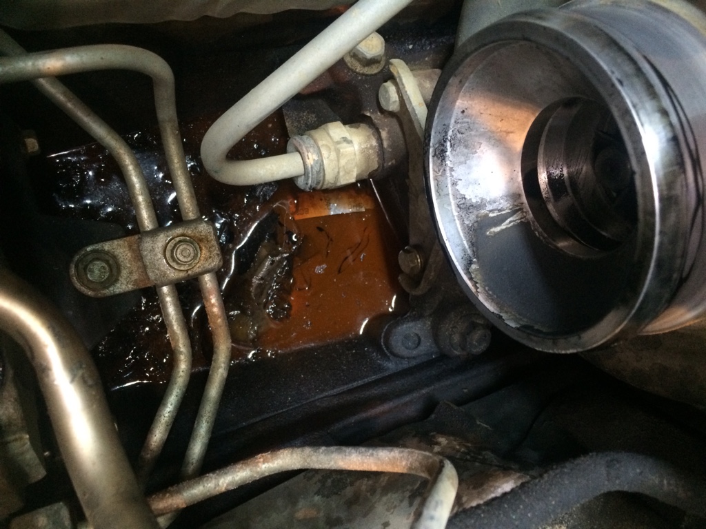

Coolant pool in front of the turbo. This connection was the first thing I checked IIRC they are prone to fail and leak.
Any idea where to look next? Working on tracking down a pressure tester at the moment.

Check the other end of the line that feed the turbo. It'll have a rubber hose and clamp on it. Also check the hose coming from the heater core that eventually ends up in the coolant crossover pipe connecting the heads at the front of the engine

I checked everything I had apart when I did the EGR delete. That metal pipe to to the snap conector that leads to the heater is dry. The tiny hose up top is dry. The short section of rubber hose leading to the turbo is dry.
I could be wrong but I would think a drip would hang on the leaking connection

You're thinking correctly. I'd wash it out and make sure it's dry and run it. Easier to find that way, unless you get a pressure tester

I dried everything up best I could. I'll get a pressure tester for sure. Rent borrow or the snappy truck stops at the mechanics shop on Friday

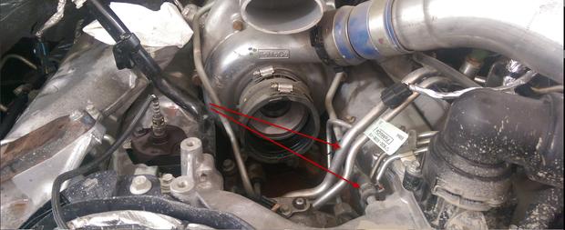

Check these two points. I had mine leak a long time ago in the valley which at first appeared that the trans line was leaking. After further inspection, found these points were leaking. Removed the stupid little pinch clamps that the arrows are pointing to and put actual hose clamps on instead. Hasnt leaked since. Hope this helps!

Well I got a hold of a pressure tester. I put 16 psi on it over an hour ago and have yet to see any drop in pressure or drips. I will replace the short piece of hose and use hose clamps as builtpowerstroketough suggested.
