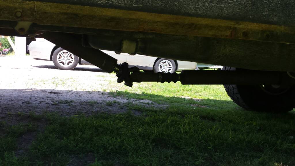

Anyone know a good reasonably priced source?
Just had u-joints and carrier bearing replaced last spring. -_-

I have only got as far as the two sorta local places and they said "you'll get vibrations with a two piece". How do duramaxes have them then? Im sick of that hokey ass setup. Im tempted to take the shaftvout of a ccsb dmax and try it.

I've had u-joint/carrier bearing issues most of the time I've had the truck. I had all the u-joints replaced by a mechanic (including the carrier bearing) last spring...and whatever aftermarket part the mechanic put on for the carrier bearing completely grenaded. SOOOOOOO sick of this 2-piece setup.
