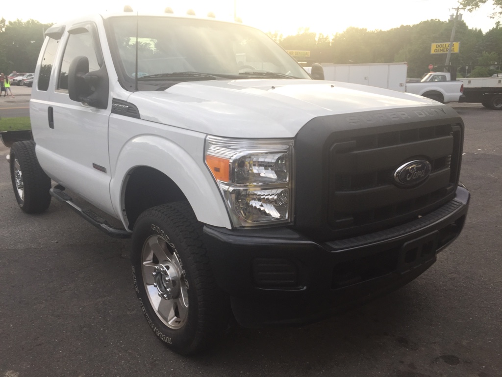

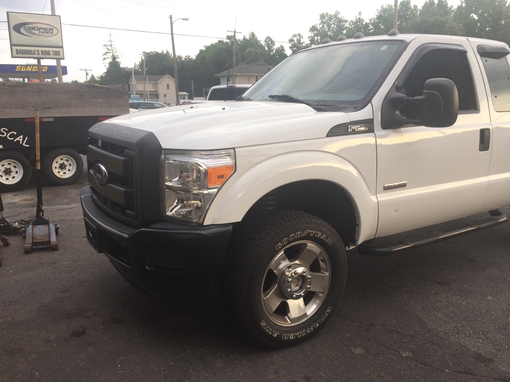

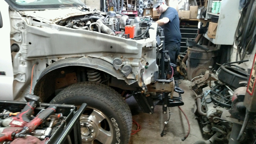

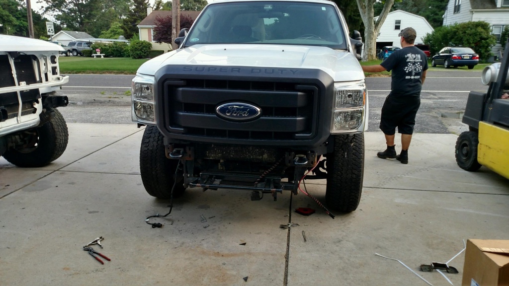

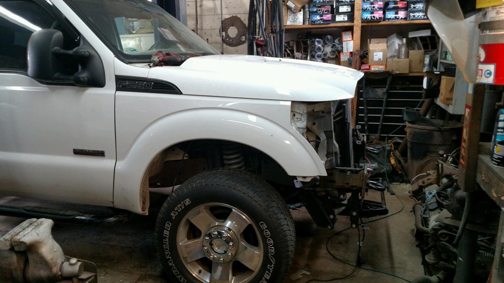

In the middle of my conversion now more pics to come. I used the mcnasty customs bracket kit to mount the sheet metal in the front. Truck is off for new paint right now. :bowfast::bowfast:

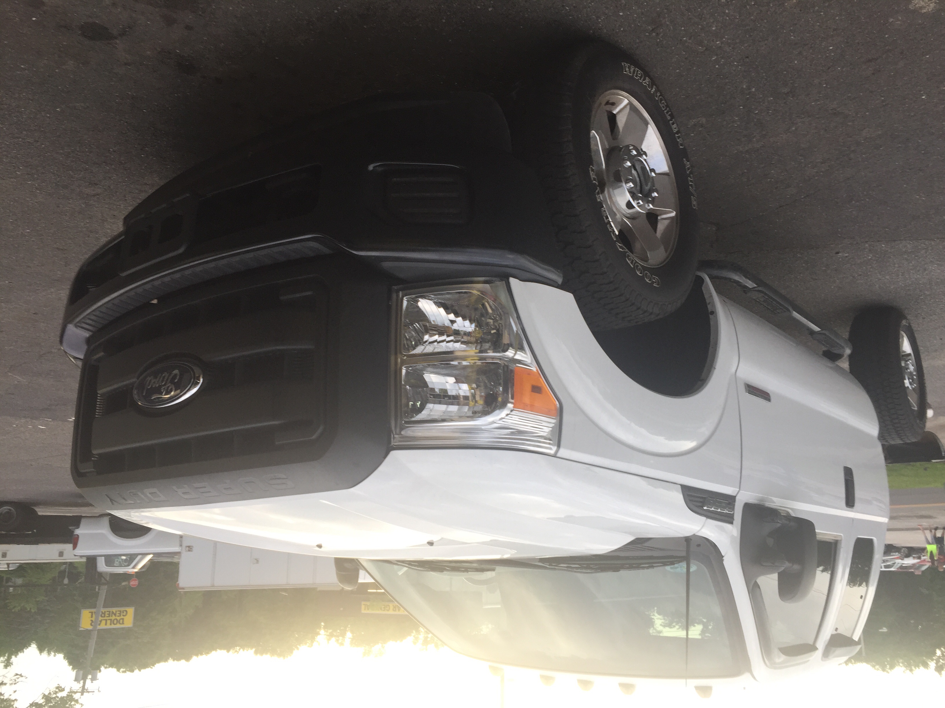

Looks good. Except that the picture is upside down. As is your avatar pic. Welcome! Lol

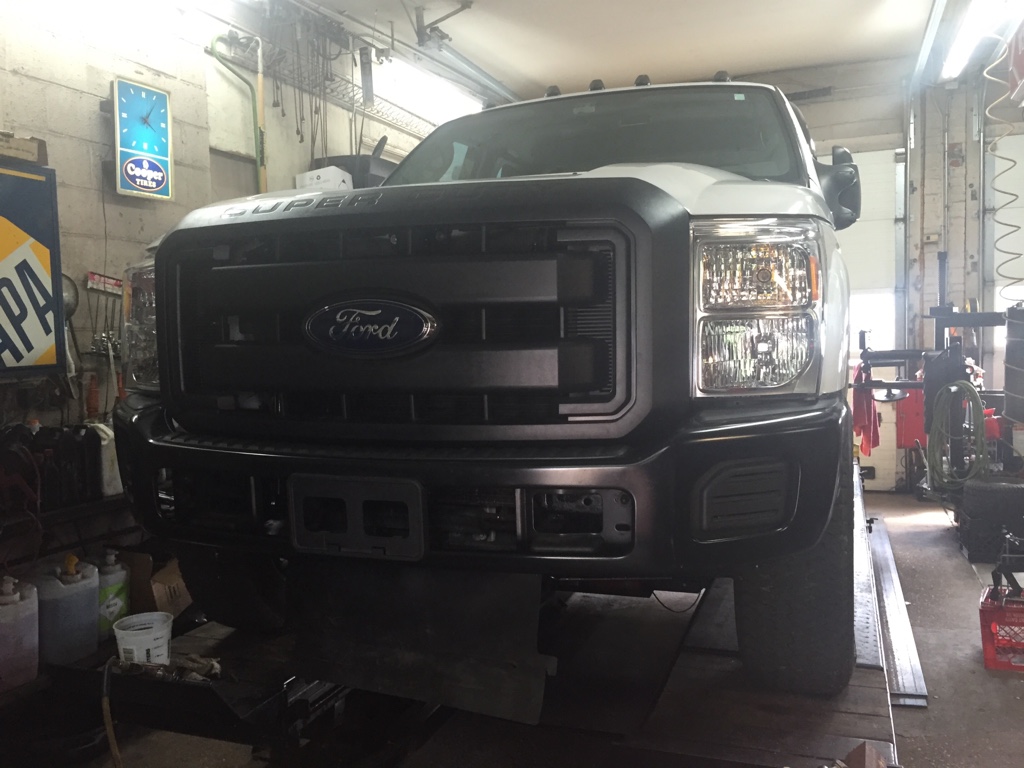

Thank you. I'm working on that. I'm thinking they are because I'm on a mobile device. I have a ton more pictures but need to get them loaded. I saw a thread on here with people hesitant about buying the mcnasty customs nose kit. I ordered one and put it in. It's a nice kit and decently built. Looks good under the hood. Still a lot of fabrication required but worth the investment for sure.

Not really I'm happy with it. It's sheet metal only. No latches, hooks, liners, or strikers. Modification of the filler neck is required as well.

Looks really good! I'm glad to see you're changing the bed. Do you have any pictures of the brackets to convert the nose?
2015sixohno
Jul 10, 2015
35
Everything you see on mcnasty's website and Facebook page are what's used. Pretty simple install for the most part. Again it's sheet metal and grill only but if you can figure that out making a bumper mount shouldn't be a big deal for most. They your into making the fender liners fit ( that's a bit tricky, I used a acetylene torch to heat the plastic and make it go where I wanted and trimmed excess off and other odds and ends ) the kit is nice and worth the money he is asking for it. Not crap material by any means. Nice 1/8 inch plate steel and painted satin black. The little things are what takes up the most time.

same brackets we used on the Harley excursion....I tell people, its a great start and the brackets really are quality. But there is still a lot of fitment and adjusting to get everything perfect atleast in our experience...but well work in in my opinion
great looking conversion!
