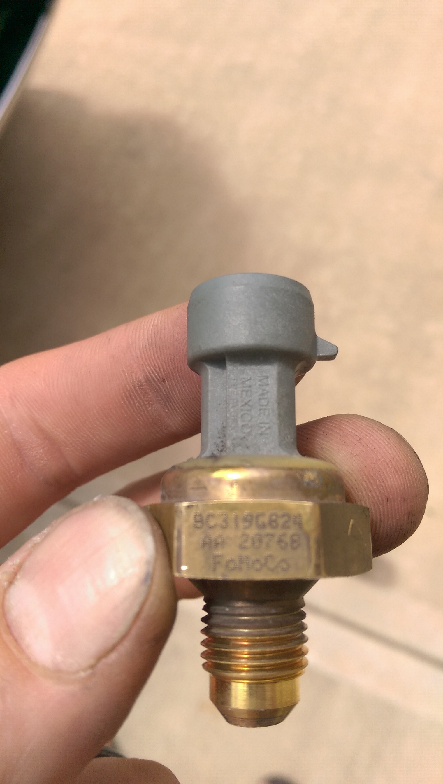

This code has troubled me in the past. It first happened back in November. At that time I just cleared the code and kept driving. Didn't really go into limp mode until a couple months ago. Everytime I tried clearing it, it would come right back and stay stuck in limp mode. So I popped the hood and found this
Put a new one in and cleared the code and it never came back. To be honest though I don't know if it was just coincidence or if it really solved the problem. As a preventative measure I had gear head write me another tune to turn that code off. So far so good.

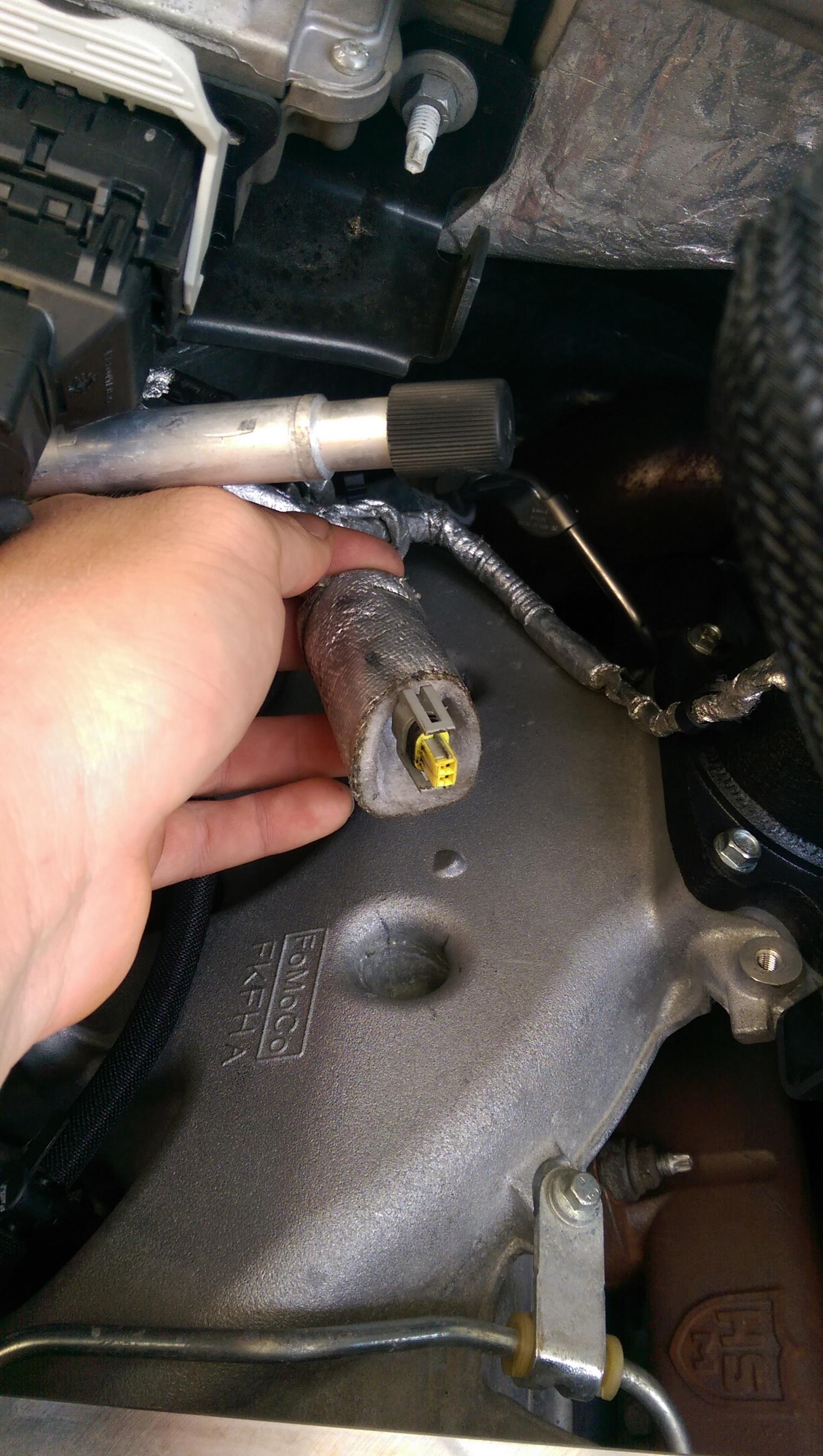

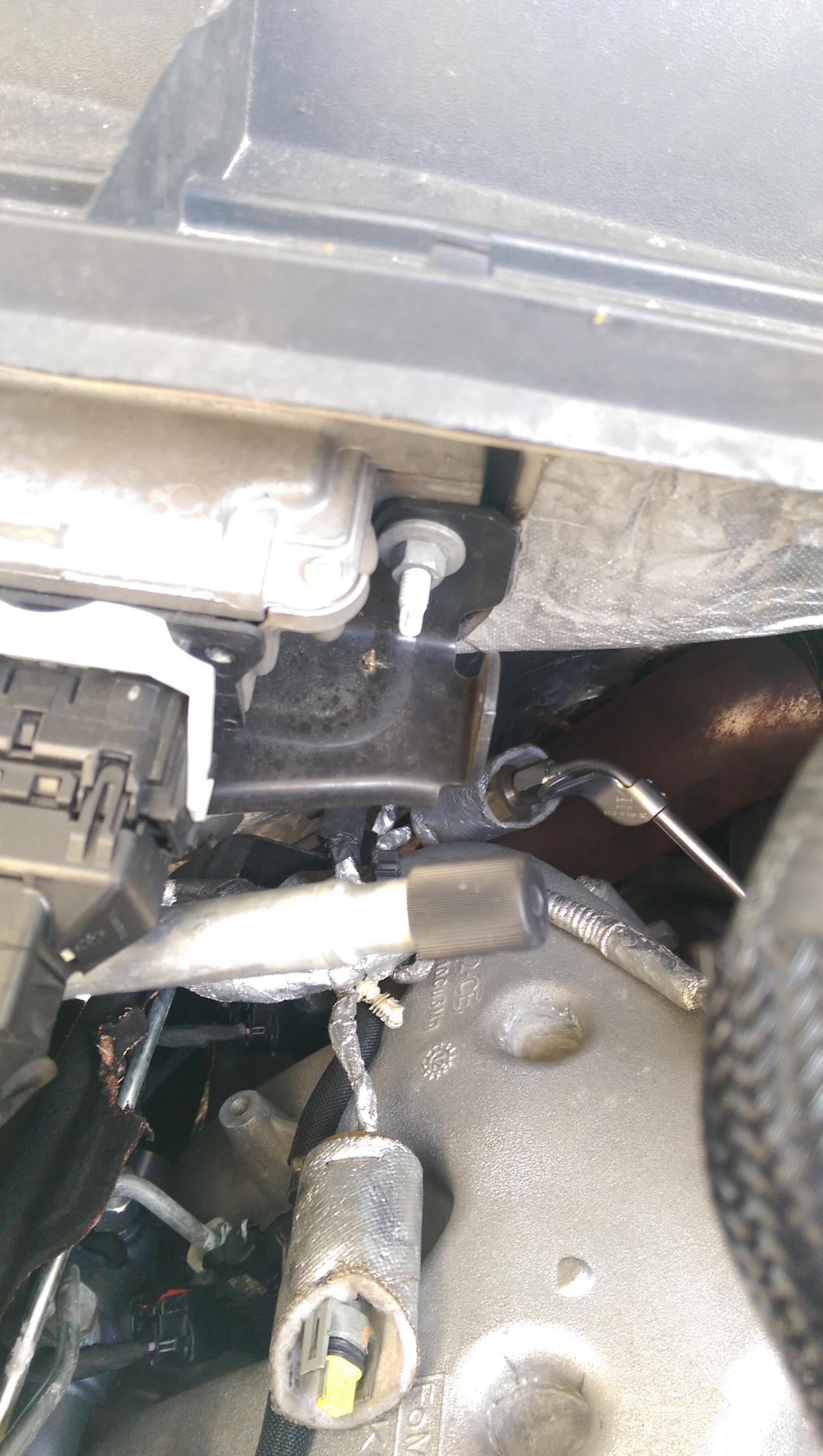

Either of these look familiar? Looks like an ebp sensor?
IHPowerstroke7.3
Aug 11, 2012
251
Toronto, Ontario
That is an EBP sensor. Should be connected to the tube coming off passenger side up pipe, Back of the intake on the passenger side.
JCain, in the first picture you posted, see the stainless steel tube that's back by your down pipe, has the almost 90 degree bend in it? That's the sensor he is speaking of.
The other wiring connector you have a picture of is the connector for your VGT, which I assume is not being used if you have a non VGT setup.

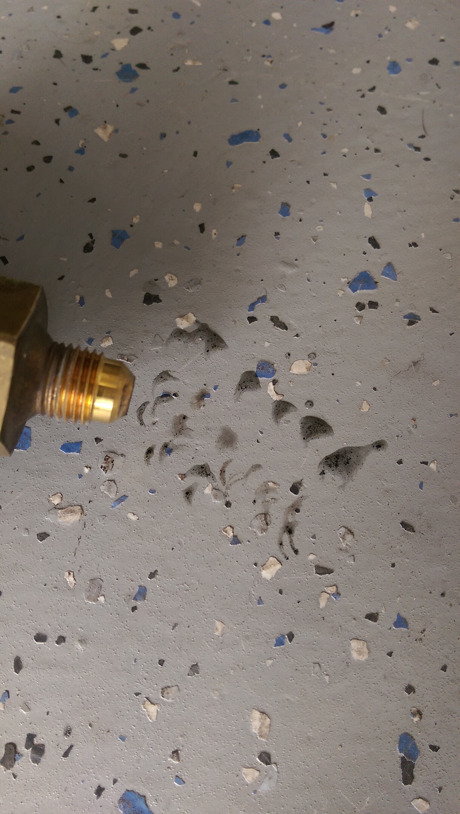

My sensor had a different code on that tube end. Pulled it out and it was full of moisture and soot. Cleaned and replaced. Let's see if that fixes it. Thanks a bunch for chiming in guys!
IHPowerstroke7.3
Aug 11, 2012
251
Toronto, Ontario
No worries, just trying to help too.
I assume by code on the sensor you're talking about the part number? All numbers stamped on the sensors are what's called an "engineering" part number. Any Ford dealer can run that number and can give you the correct part number which will always be different. So whatever number came back as a pressure sensor would be correct. EBP is an exhaust back pressure sensor.
Sometimes the tubes themselves get clogged with soot as well. I usually try to run a piece of say 18 gauge mechanics wire through the tube to clean the soot out. Sounds like you have already replaced the sensor, give it a shot and see how it goes.
