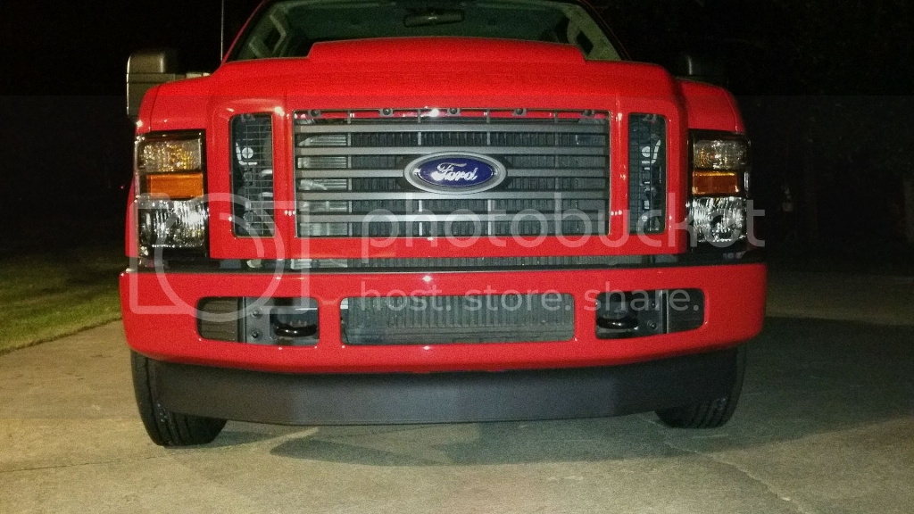

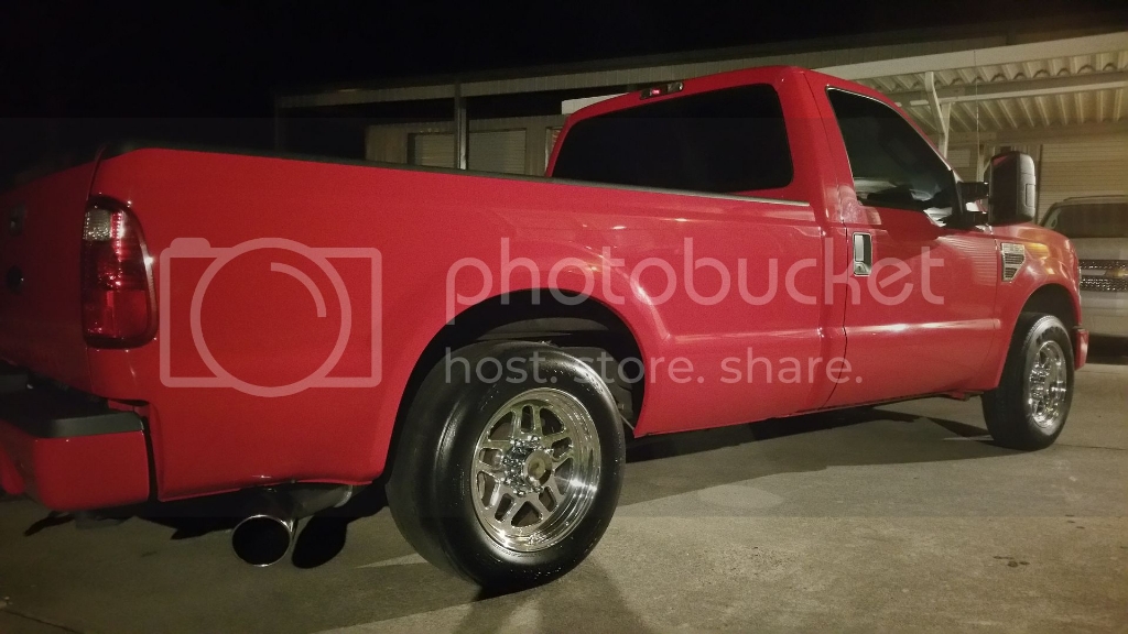

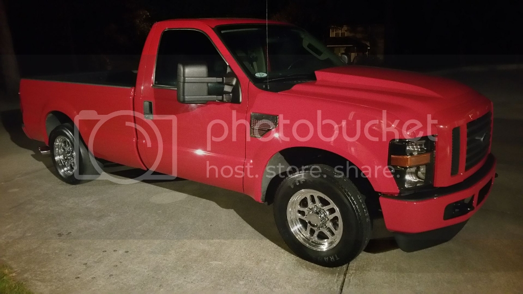

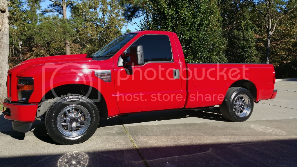

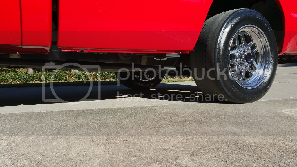

Hers some long awaited pics. And yes this thing hooks like a animal. Now its time for a new locker. thanks to BOGART, ONE UP OFFROAD, AND HOOSIER for the unbelievable traction. Truck runs amazing. Maybe some future track time is near!
Setup is: 17×7 front with 4.5 b.s. 225-75-17 Firestone transforce ht load e tire. 18x11 rear with 8" b.s. 325-45-18 Hoosier dr2 drag radial tire. All 30" diameter.
