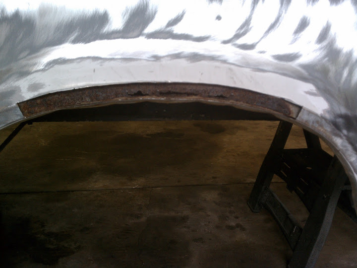

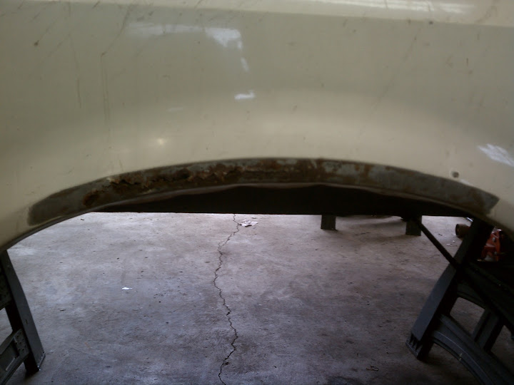

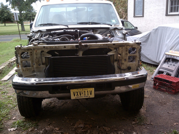

This truck started it's life as a work truck. I purchased it in 2006 and used it as a work truck. Now its time to play. Its been sitting since 2009 with a fried transmission. I stupidly forgot to blow out the trans lines and install the inline filter when I rebuilt the trans with racer x parts. While I'm getting everything together to send the trans out I decided its time to do the bodywork. The bottoms of the fenders were rotted, cab corners and upper wheel arches.

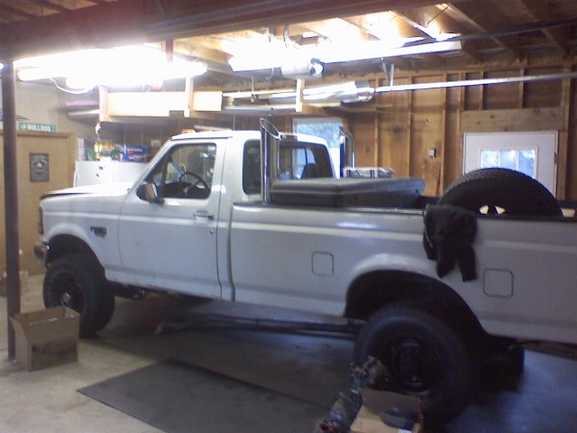

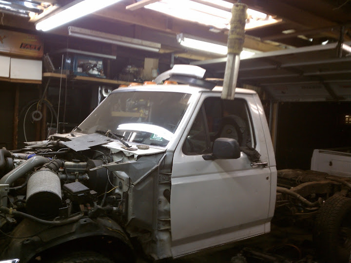

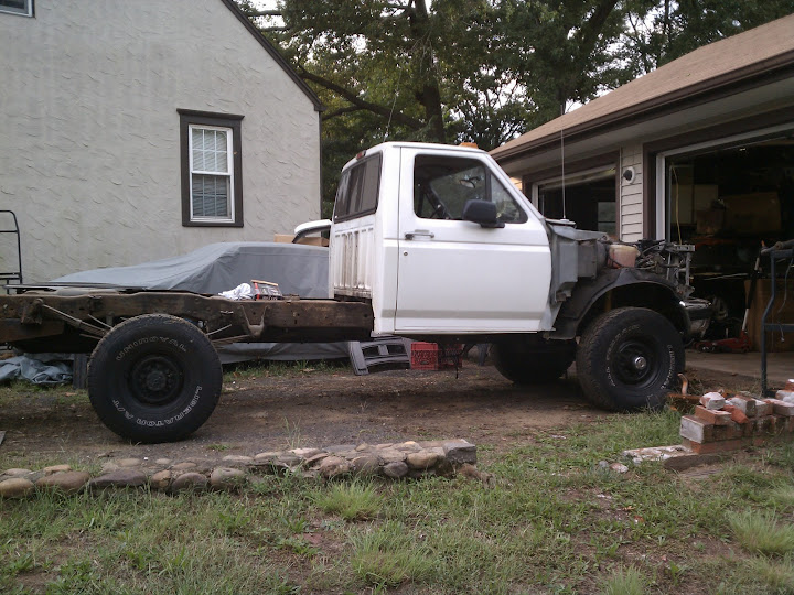

Pic from 2008 after the stacks, sticks, d66 and trans went it.

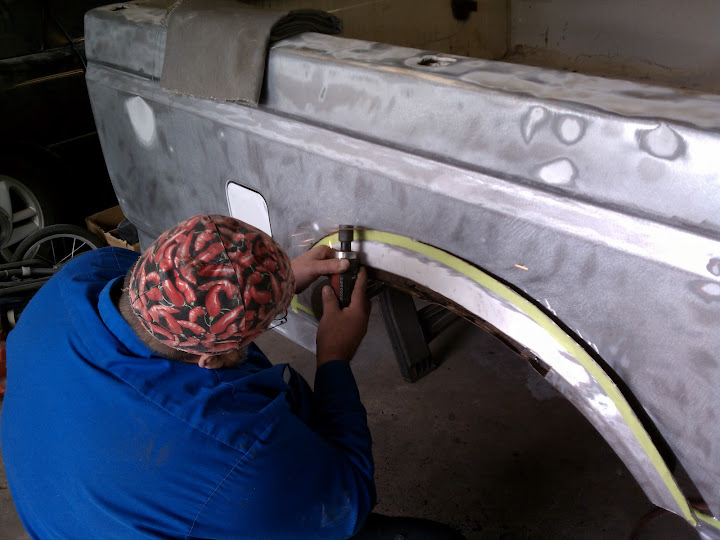

Fast forward to last week. Big thanks to my father in law for helping.
He did the drivers side, I did the passengers. I say mine came out better.

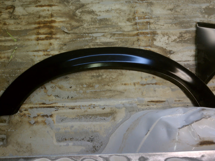

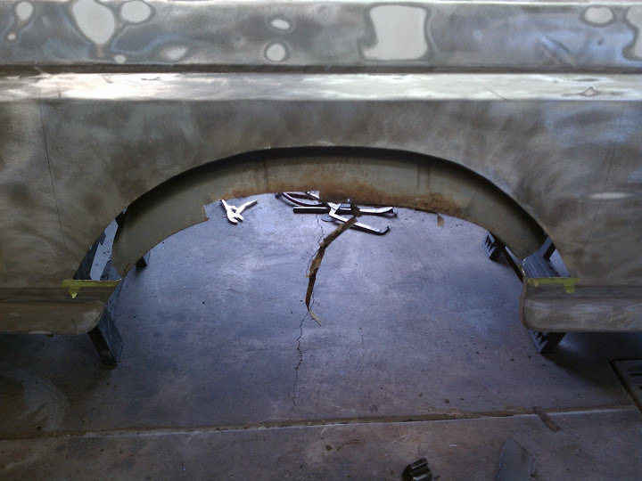

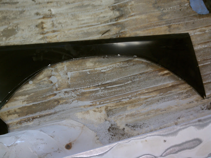

Had to rebuild the inner fender support.
New fender welded in
Tiger Hair!

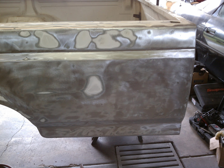

Ugh, gonna need alot of uni-spotter pins...

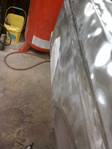

Whoever fixed the passenger side orginaly decided to bang the dent IN and not pull it out and fix it. The mud was 1/4" thick....

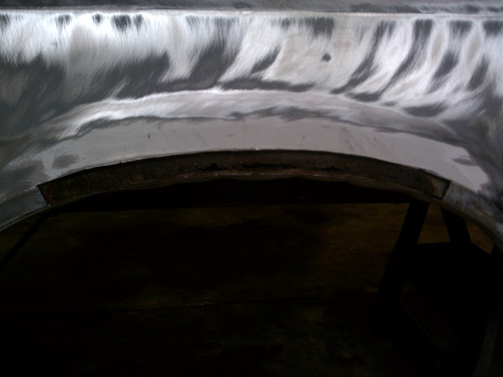

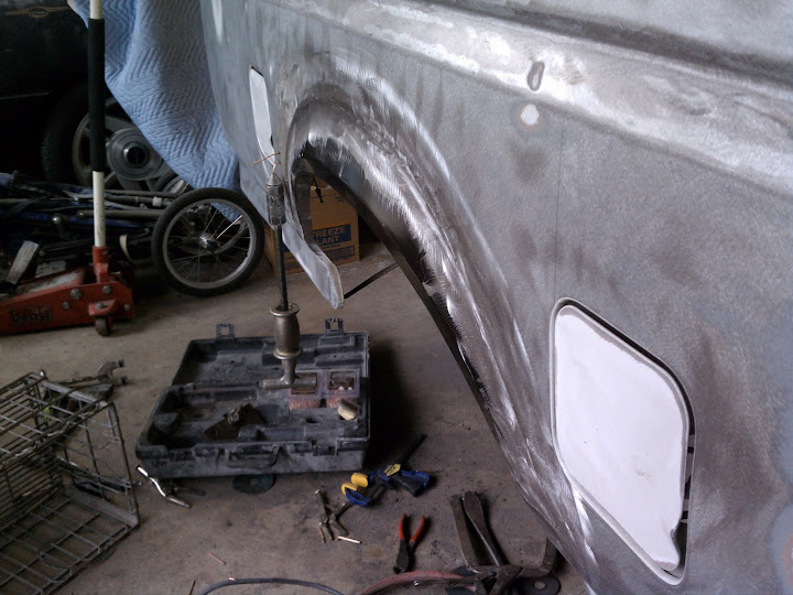

My turn..
Inner fender patch.
Cut out what I needed. Hiding the seam above the body line.
All I needed.

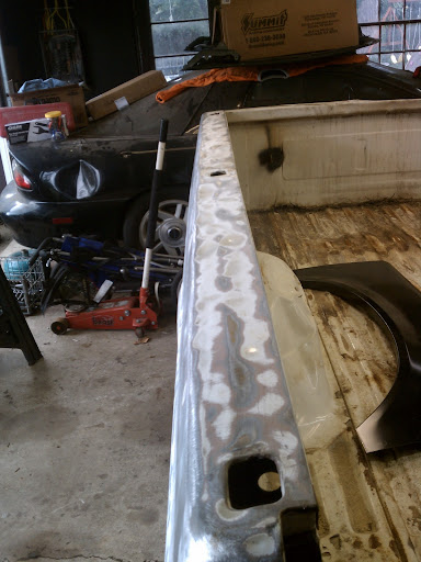

I'll get more pictures later, it was getting late. I pulled out a ton of dents and welded in my side. He'll probobly pull the top of the bed rails out and mud it for when i get home from work.

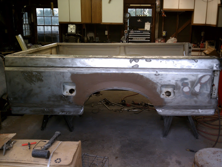

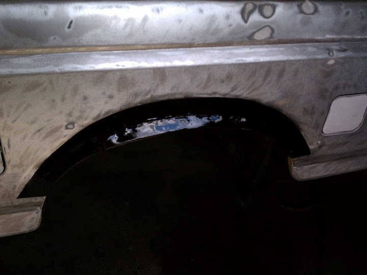

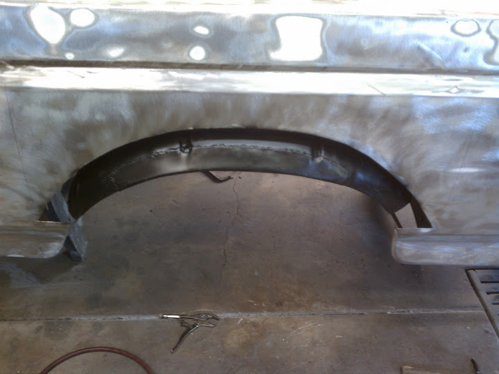

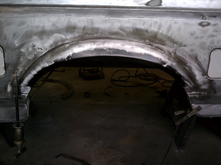

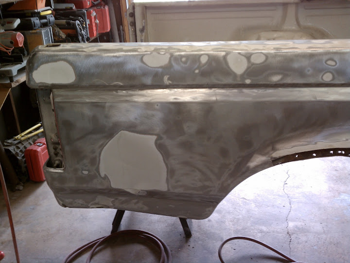

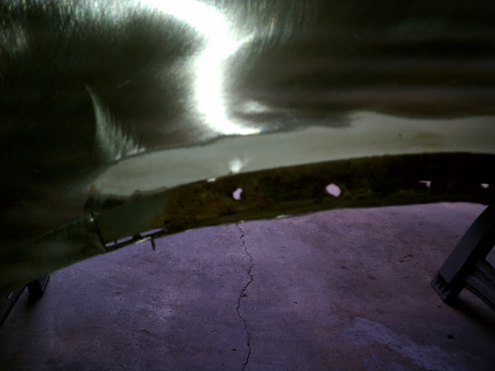

Few more pics, other side welded in, some dents pulled.

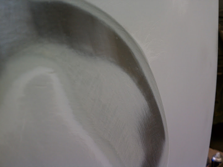

This one came out pretty good.

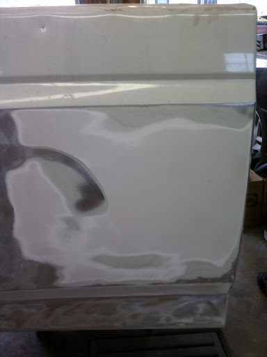

BEFORE
AFTER
Big dent pushed back out and the lower quarter straightened, needs some more work.

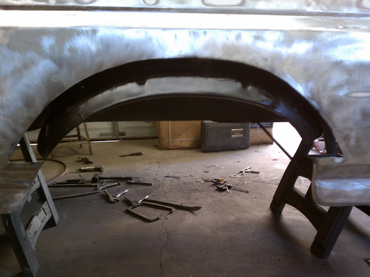

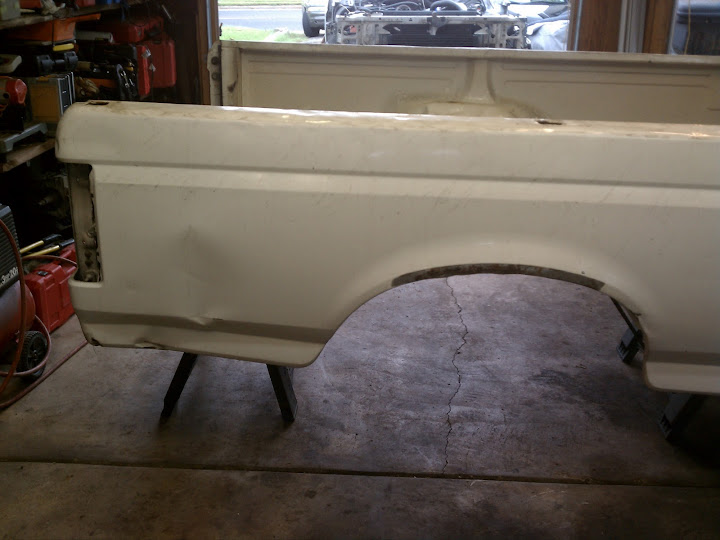

New passeger side welded in.

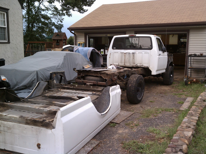

I REALLY need to do something like this to my truck. The cab is pretty bad.
One question: When you weld in a new panel, how do you coat the back side to keep it from rusting on the back side? Like when you put in the bed side, how do you get to the back to coat it? I can't see any way to get there.
fatsix
Sep 15, 2011
330
South Jersey
Take down the two pieces of inner fender. You can still get behind there. I will take pictures of this process when I do mine.

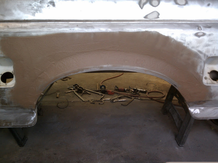

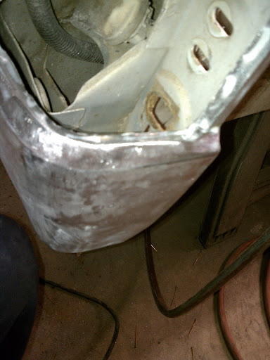

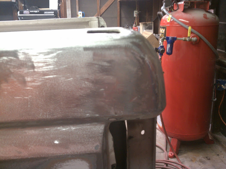

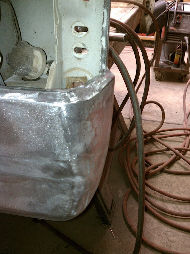

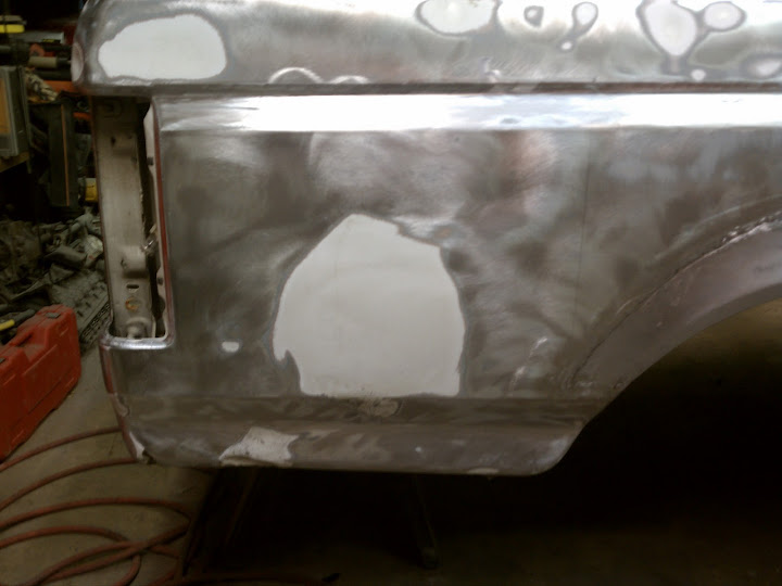

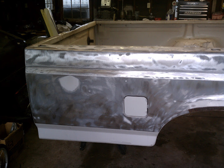

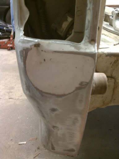

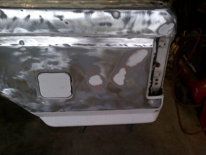

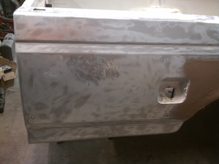

Worked on the tail light pocket a bit last night. I stopped early to watch the Phillies lose.

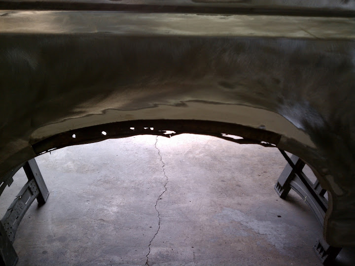

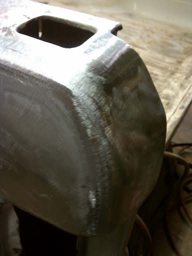

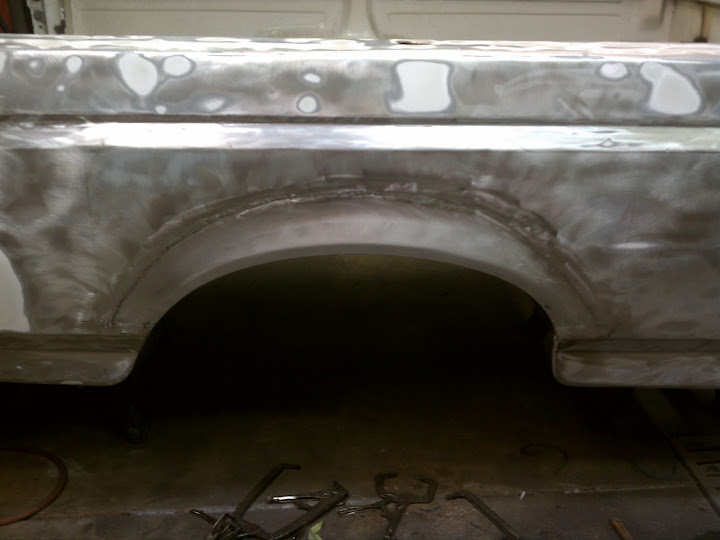

Before
After. I still need to pull the corner back square, it got pushed a little to the side of the truck. I also gotta work on the upper part of the body line.

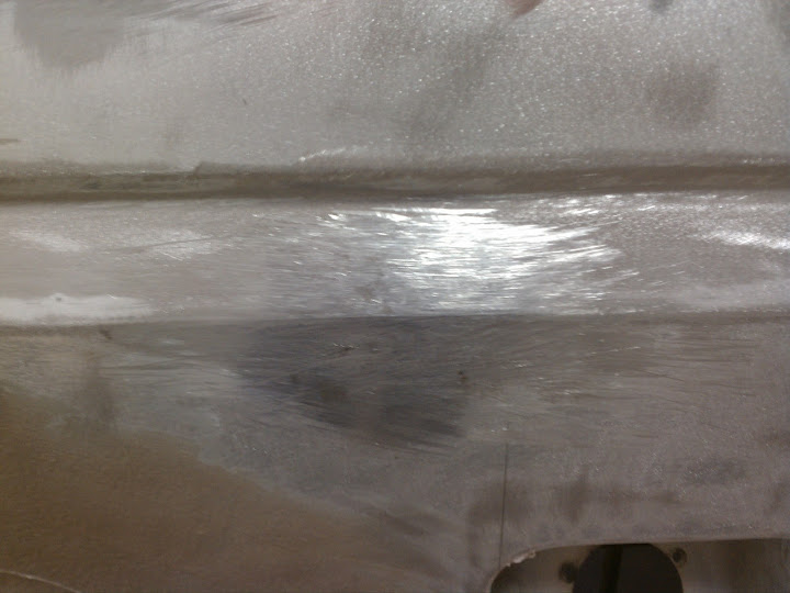

The upper part came out really good, I'm happy with it.

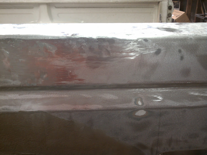

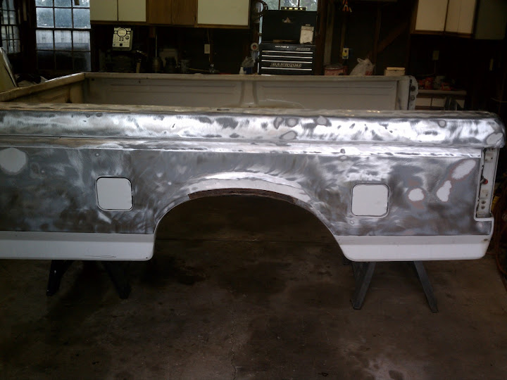

This was a dent above and below the body line. Shouldn't need any filler here either.

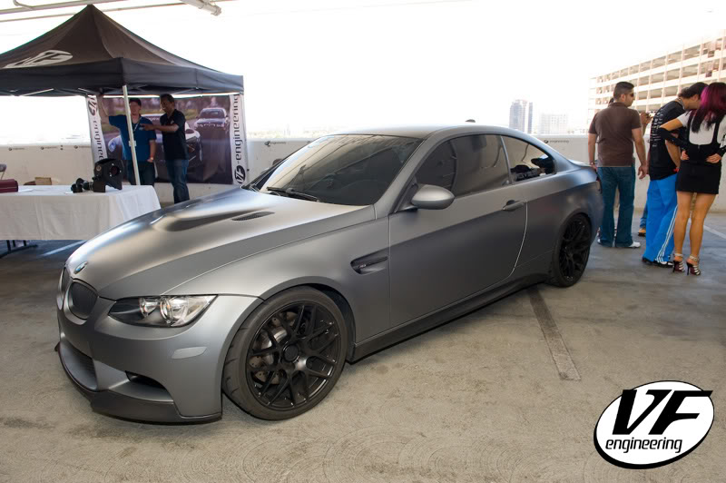

BMW frozen grey metallic its called. It should look good with the blacked out theme i want to use. It might be a little tough to spray this color in my garage since its a metallic and I have yet to paint a vehicle. I might have to pay for some booth time.
