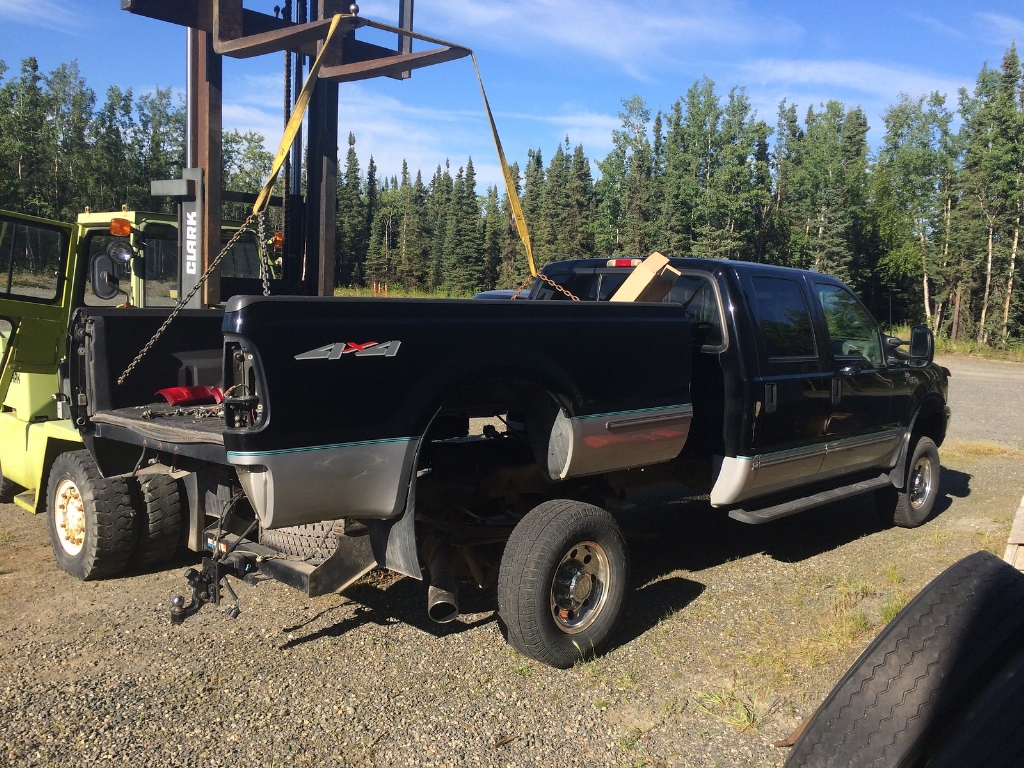

Bed lift by myself
Untitled by Jory (Cory) Hubbard, on Flickr
Off for good

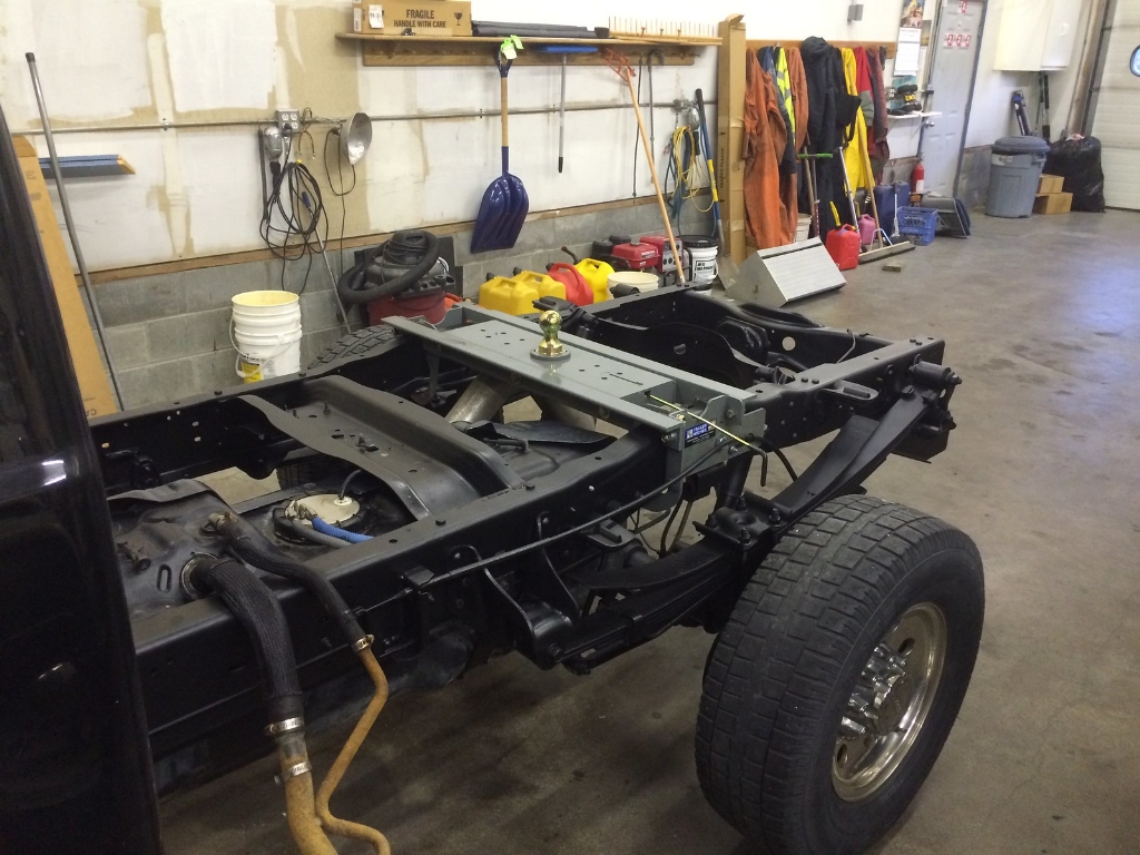

Painted with expoxy primer, fuel tank and wiring back in, upgraded 3/8 fuel lines to 5/8 for large injectors, and goose neck installed.

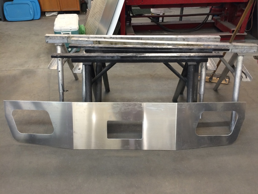

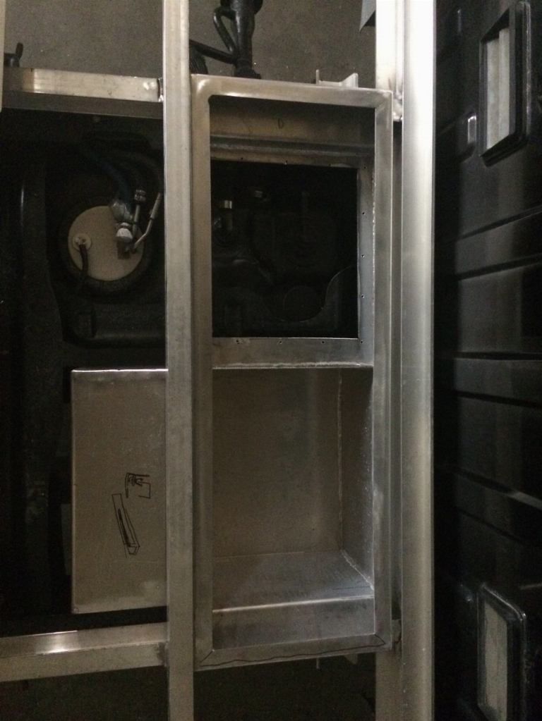

Plasma cutout 5086 3/16 for tailboard
recessed light buckets and licence plate

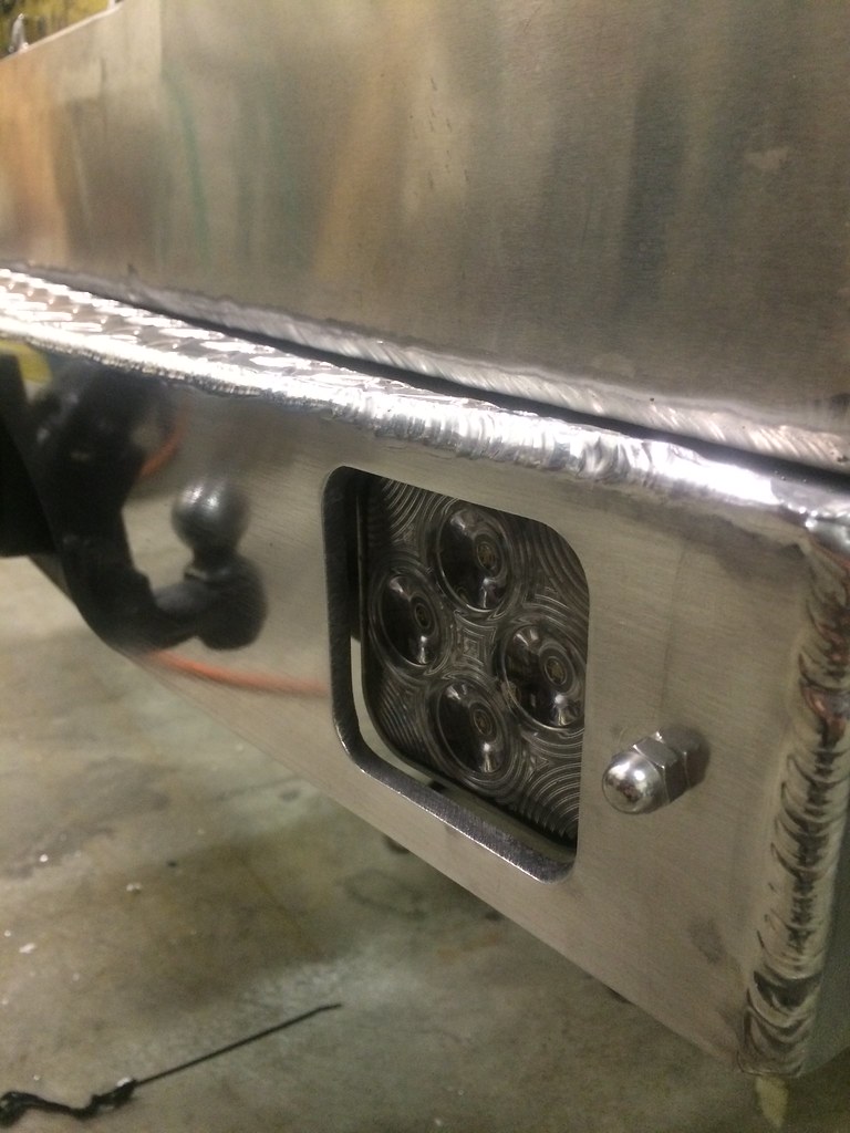

Weld shots. 6061 1/4 flatbar to 5086 3/16. thumb amperage control. (give me a break, Im only 19 :) )

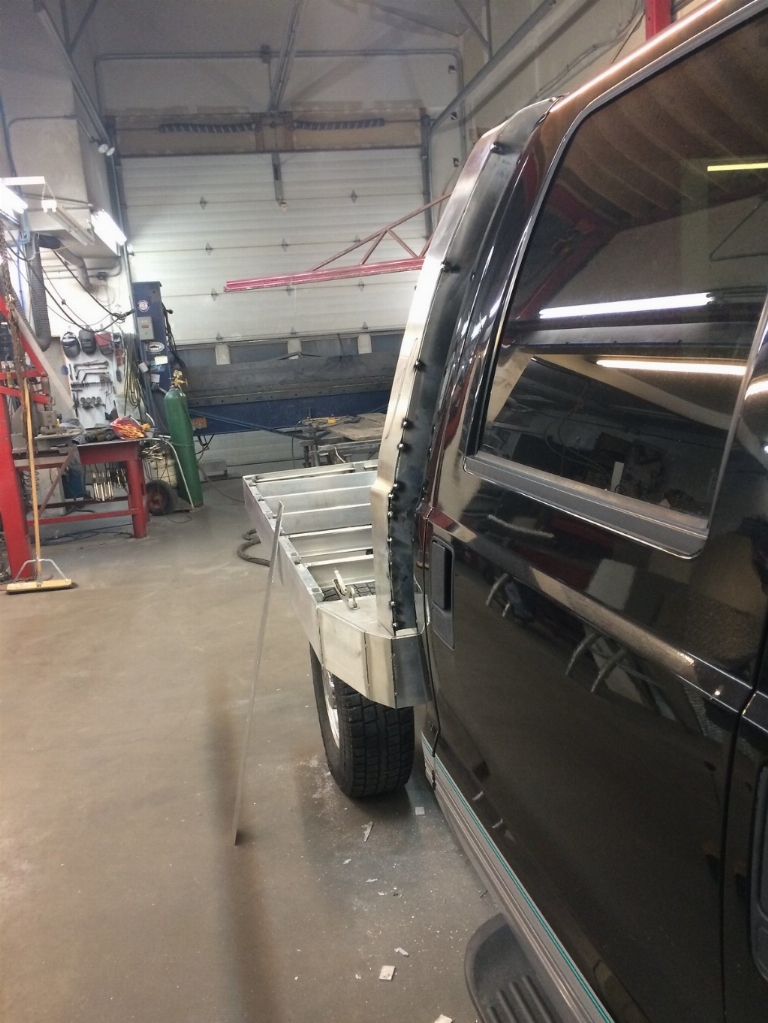

Welded on

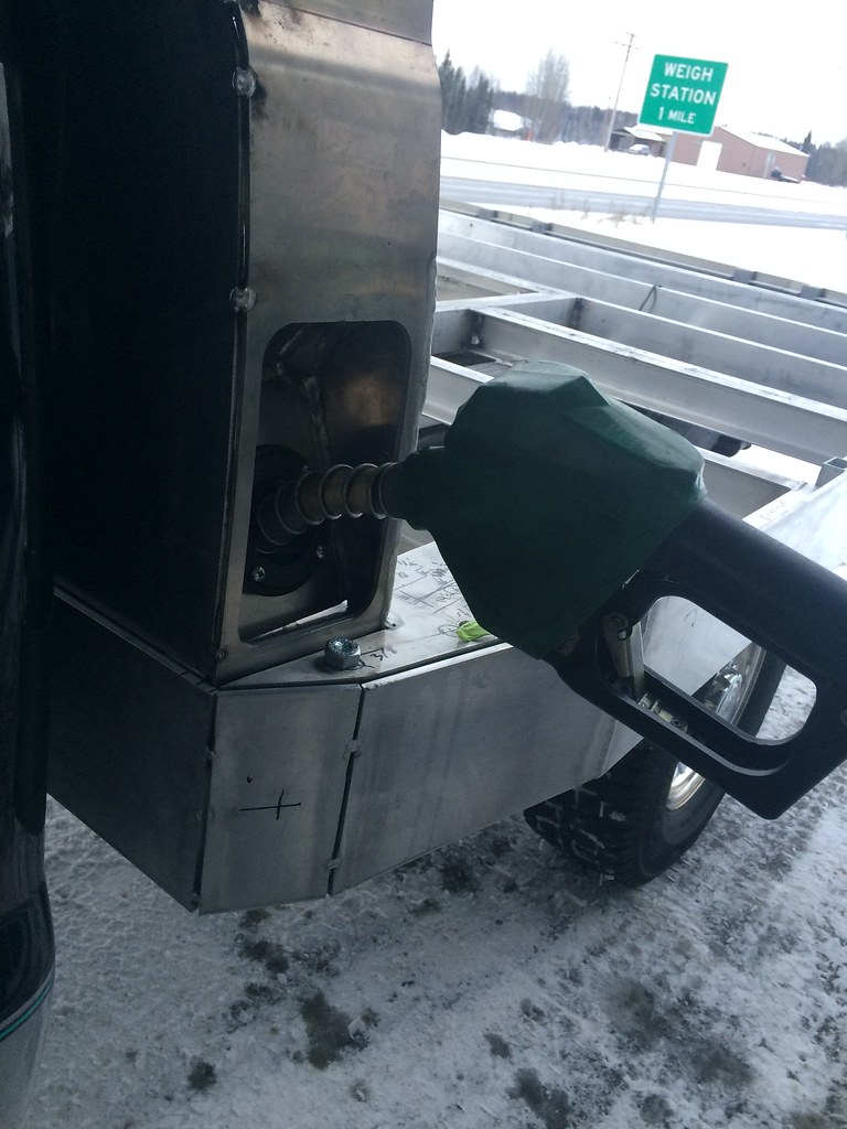

Trying out the fuel filler. Works good, flows and vents well

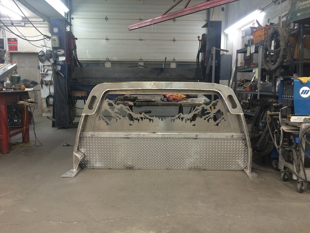

Headache rack cutout test fit, as well as lights installed.
Started welding out the headache rack
Welds? 1/8 to 1/8 5052, 3/32 tungsten, 1/16 filler, 20 cfh of argon. I'm self taught LOL. Have a lot to learn obviously but it gets the job done.

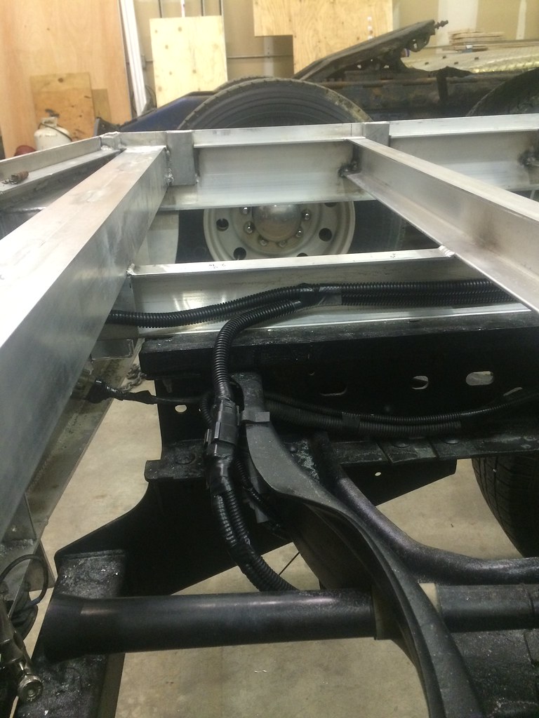

Wiring. Everything thing is done with Phillips arctic flex wire and loom. All connections are heat shrinked that have been taped up as well. I am very anal about my wiring.

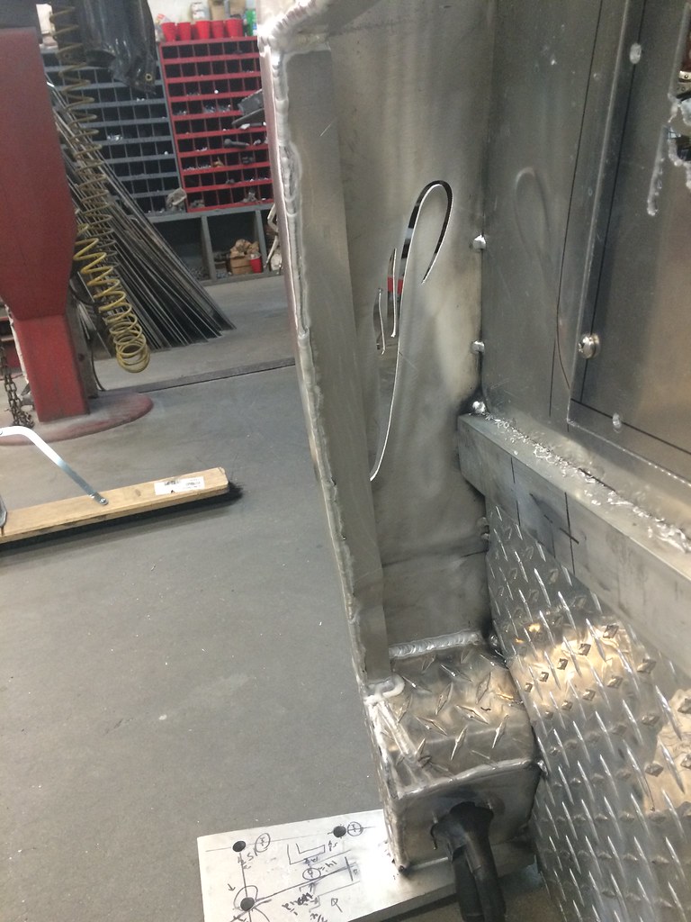

In this photo shows where I get my factory power from. I bought a stock truck bed wiring harness off another ford superduty and cut it apart and used the plug from it. That way I have factory connection that is easy to unplug and remove the flatbed. The best part is, The truck is still completely stock as I avoided cutting the plug off of it. This how I do all my wiring. I always go to junk yards and buy stock pigtails. This particular one cost me $65 just so I could avoid cutting off a factory plug, but in my mind it is well worth it.
This is a step that bolts onto the bottom of the tail board. I used it as a place to mount auxillary back up lights and my light plug. Its 6061 flatbar that I loaded into the plascam and cut out. Then I put a slight bed in it to much the flatbed angle and welded some other planes in it then welded diamond plate on the top.
Weld shot. 3/32 tungsten, 1/8 inch filler, number 7 cup
I also sanded and polished it before I put the lights and trailer plug in. I tried to get all the extrusion marks lines out. I went 220,400,600,1000, then a cut with yellow wheel and red rouge, then a hand polish. Its not perfect but It turned out very well. I think this is what I will do to the entire bed.

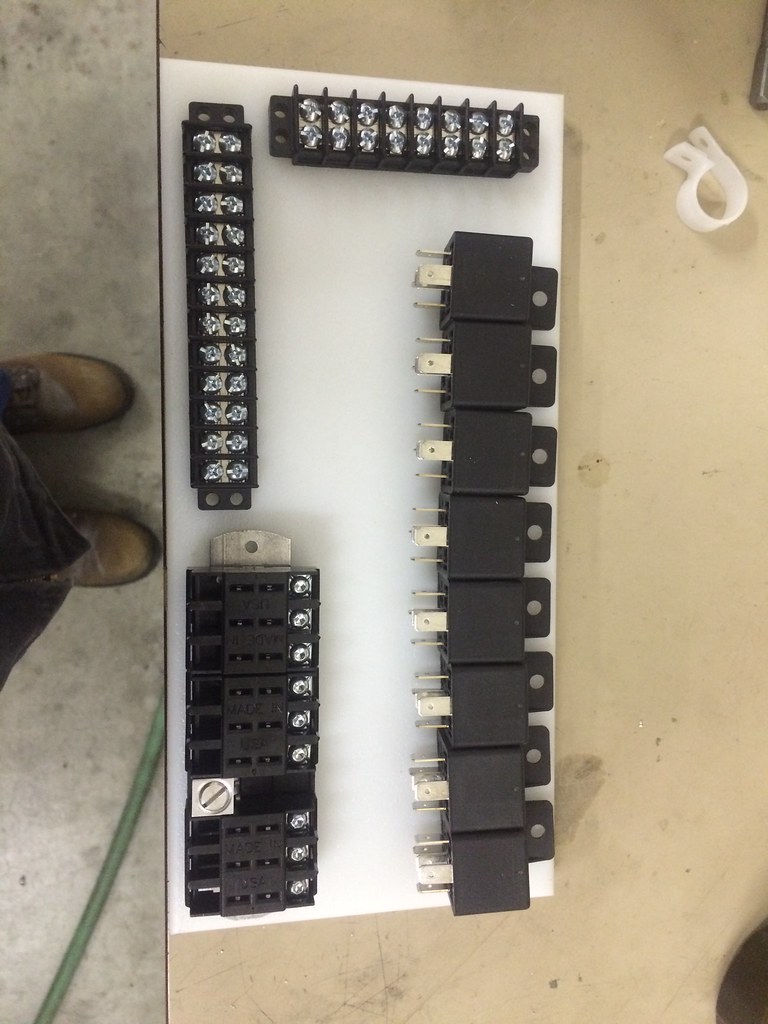

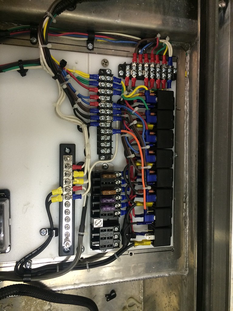

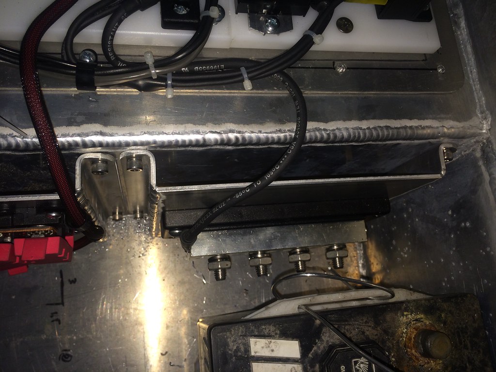

Working on the wiring in the electronic box
Battery hold down I made in the bridgeport
Start of the wiring. Done on a piece of 1/2" abs plastic

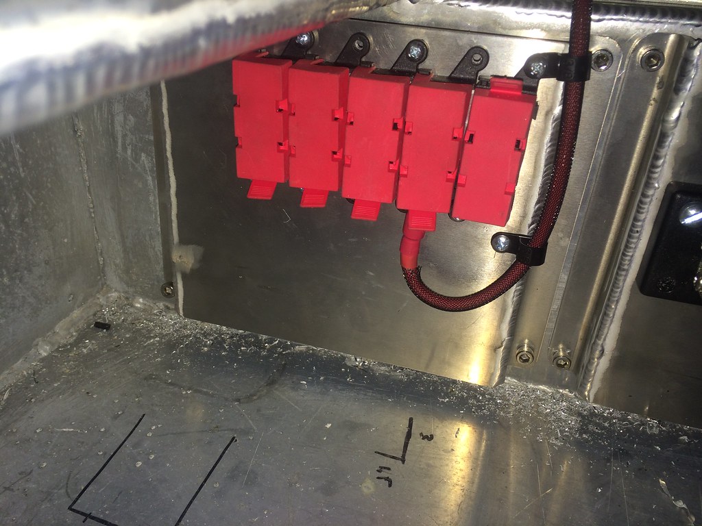

High amp fuses and bussbar for items like Amp, air compressor, inverter
Appropriate ground bus bar for the same thing

The headache rack will have body filler work and be painted gloss black when finished. The rest of the bed will be polished when done. We will see how well it holds up on Alaska roads and how much I keep up with the polishing
