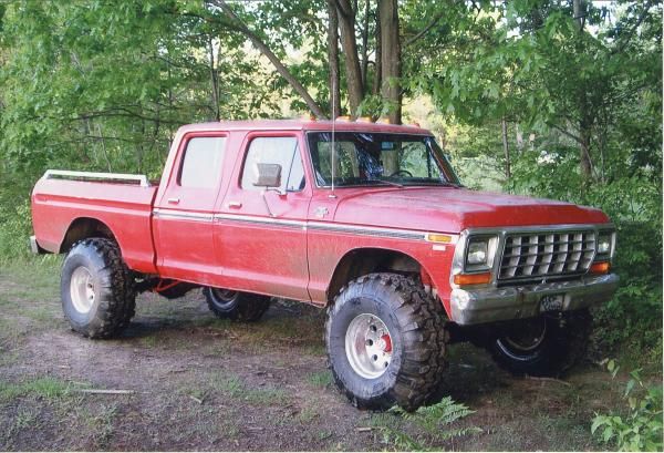

Default OE= Original Eleanor

Life has come full circle. I left NYC, I moved back to Michigan, and began my life again.
My love for big vehicles, trails, and copious amounts of mud left me with a small yearning for fun.
So I bought a suburban
then I bought a Jeep
then I bought a Full Size Bronco.
Still not the same.
"Eleanor" kept calling. So became my maniacal search to replace the red beast.

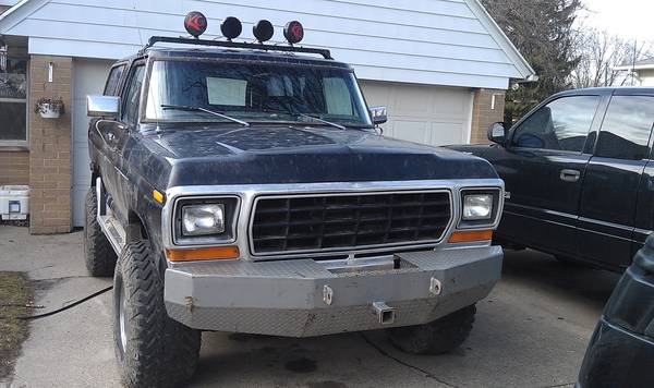

After about six months of searching, I found one. The perfect one in my opinion. Only one problem: It was in Washington (the State).
Eleanor; part 2. This was how I got her, minus the bigger tires( he was nice and gave me some rollers)
The seller thought I was insane. My girlfriend (ex now) thought so too. As did my son. After convincing the seller I was not insane, nor a craigslist killer, and that I could be there in a few days, he finally agreed to hold it for me.
So my oldest son and I loaded up the trailer (i wasn't sure if the crew cab would fit on my tow truck/hauler; ((more on that later))) and hitched up my truck to take a long Sunday drive.
My son and I slept and drove in 4 hour shifts. All the way from Zeeland, MI to Forks, WA. Looked over the potential "Eleanor", called it good, paid the guy $1000 for the drive-train-less truck, and continued to drive back cross country to Zeeland, MI. We did it in 3 1/2 days!

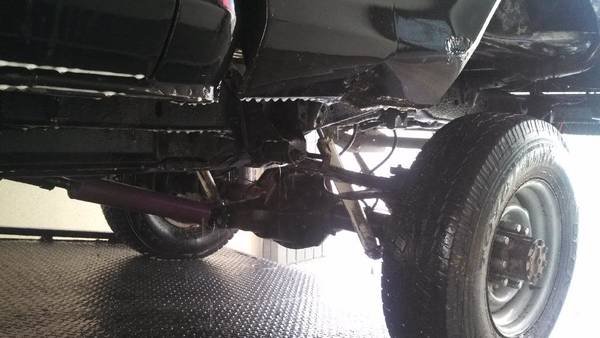

When I bought it, they had swapped a sterling 10.25 for the rear. Still retains the dana 44 in the front.
Keeping the sterling for sure. Bought and had a correct Dana 60 rebuilt for the front, as too many have warned me the D44 wouldn't last long with that 7.3 calling the shots.

What I got with the Crew Cab:
* no motor, no trans, no transfer case
* solid interior, headliner as well
* an education on "Krummy's" (apparently the west coasters referenced these trucks as Krummy)
* 4 inch body lift (which made the PS 7.3 install that much easier)
* 4 inch suspension lift
* 10.25 sterling axle rear

They painted some of the suspension "barney" purple. Wow, just wow.
Frame is pretty clean overall.

That's a lot of steel for $800. Taking up lots of space in my garage. Will need to disassemble and sell some of this.
What the seller didn't tell me, which I would have gladly paid extra for, is that the rear was disc brake converted. Bonus!

Default front bumper
A few years ago, I was on a business trip. I did as I always do and searched the internet for local parts.
I came across a super heavy duty ranch hand style bumper. I bought it for Eleanor, before I ever bought Eleanor.
Weird how the mind works sometimes...
Anyway, I put the bumper on my Bronco, and now that Eleanor is here, and not running yet, I wanted to put the bumper on anyway to determine how the additional weight (its heavy) would effect the rake/stance.
__________________
If it was easy, everybody would have done it.
  #77
Old 02-19-2016, 06:19 AM
1killerz's Avatar
1killerz 1killerz is offline
Sergeant
Member's Gallery
Join Date: Feb 2016
Location: Western Michigan
Posts: 342
Default front bumper continued...
As it was on the bronco...
[IMG]<img src="http://powerstrokearmy.com/photopost/data/500/medium/front_16.jpg" />[/IMG]
Needed to pull it off and I will put on the tube bumpers I bought to replace on the Bronco.
Pretty stout bumper...
It fits, but it needs to be set back to be more flush like I had on the bronco.
Still working out ideas for the rear bumper. I think I got an idea. More on that later.

So I sent the D60 out for a rebuild. They did all the innards, re-geared it to 4:10 to match the rear, and took care of the outer shafts.
While it was away at the shop, decided to convert the rear sterling axle to disc brake.
It actually wasn't as bad as I thought it would be.
__________________

So not that I have stopped the process, its just that more of my time was spent with my little one as he has team sports currently. That didn't stop me though from Craigslist and ebay searches for what I needed/wanted, including a Baja rack.
For you purist on these old trucks, please turn away, back out etc. You will be more than likely be butt hurt by what I am adding to Eleanor (as if the diesel wasn't bad enough).
As for the rest of you that are not going to be butt hurt, This is essentially something I wanted all along, just not in this color...
The good news is what I paid for it, I couldn't have even bought the metal to try and make it.
A quad will fit between the rails ( a smaller quad that it is), although it is designed to handle two dirt bikes.
It designed to handle two spare tires, but not sure if:
a. it will fit with these 37" MTR's
b. that would be a heavy lift.
Lights were included. Looking for military grade lockers (weather proof) such as Pelicans to put on the top rack for storage, etc.

Default spare tire carrier ideas
38.5 and a half inch tire on a 78-79 bronco. would still have access to my bed with the bronco inspired design...
But since I am running 37's, and I know the possibility of finding a replacement tire in BFE would be a small challenge, I wanted to at least be able to run the capability of carrying two spares...left side is for Jerry Can style carrying...but replace and modify for another spare tire holder...
__________________

Default got the D60 back
New from end to end...
My better half has volunteered to add some artistic touches to the differential cover. We shall see...

Picked up Eleanor Thursday night from Four On Fabrication. If you need a guy, I know a guy. Gary's a good dude who enjoys this type of work.
The Baja rack is secured in place know, properly thanks to Gary.
The big bumper wouldn't sit right on Eleanor, so Gary fixed that too. And then trying to use the 1978-1979 column shift mechanism, while hosting a 1996 Powerstroke drive train that was also column shifted, well Gary made that a possibility too by making the bracket to secure the shifter cable properly.

rear spring shackle shows how stressed the suspension is from the new found weight...

it took a while, but was worth it to get the d44 an overtaxed springs out...

Here's a few pictures during the time I had it. I can dig up some more later.
